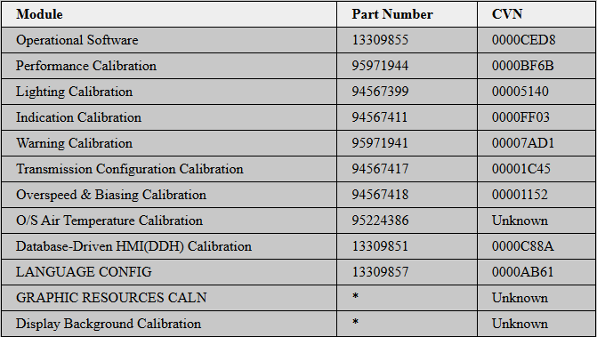

Just noticed that Part and CVN column headers should be swapped. Also please, add

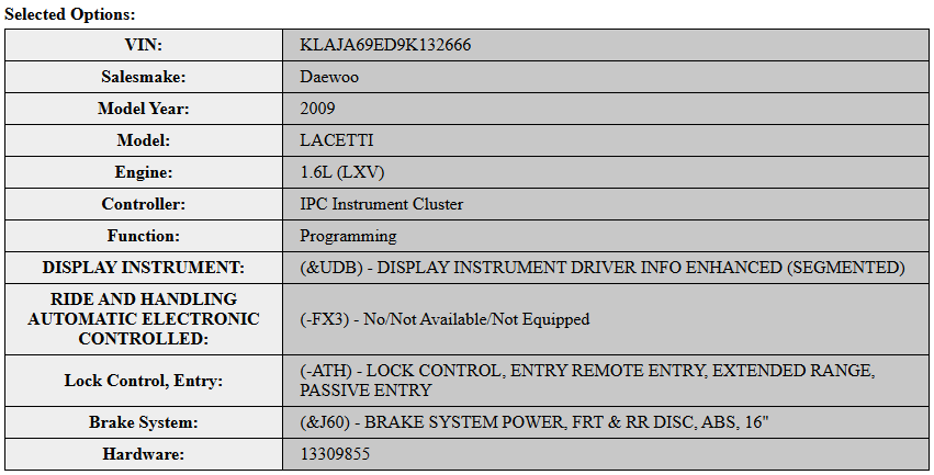

Hey, still looking for setup files for IPC KLAJA69ED9K132666:
Here is both BIN and SETUP archives for DPS.
You will have to create/add BuildRecordfile for Type4 Setup to work!KLAJA69ED9K132666_IPC_bin.zipKLAJA69ED9K132666_IPC_setup.zip
