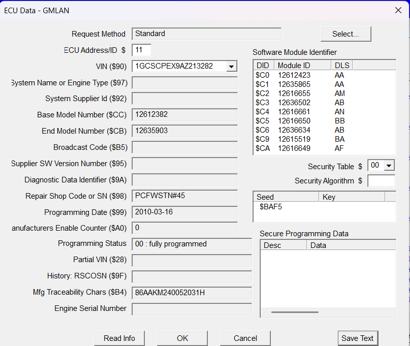

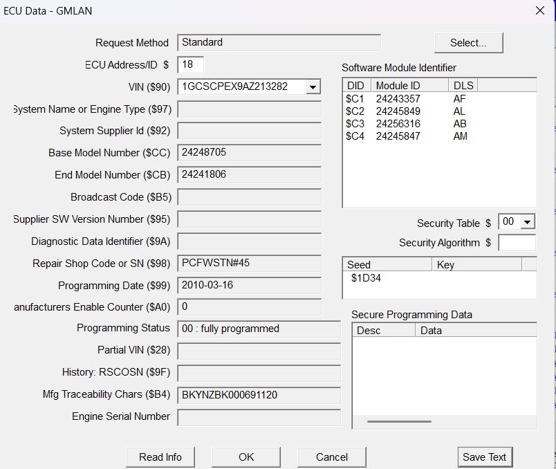

Hi, could someone provide me with the calibration and programming files for 1GCSCPEX9AZ213282?
I need the ECM, TCM, and HVAC files. The HVAC is manual control.
here my friend
13421859.bin

Any one to help
Me
With this calibration???
