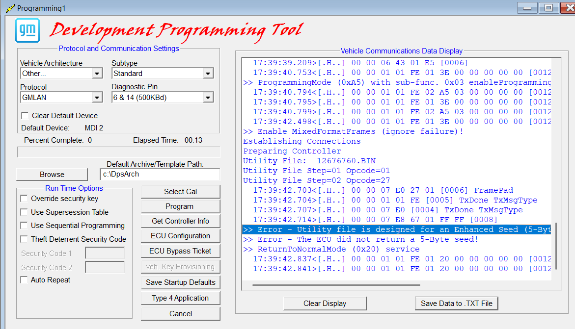

ProgramLog.Txt
ProgramLog.Txt
Does the physical/benchmark module match the exact HW+SW variant for which the K20 archive was compiled? If the archive was compiled for a different build, its controller descriptor will point to an incorrect utility (enhanced 12676760.BIN).
Is the correct utility for this module the variant with the standard 2-byte seed, and not 12676760.BIN? If DPS pulled 12676760 directly from the archive, then the controller entry in the archive is what doesn't match.
One oddity: FF FF (all ones) is an unusual seed value. It's worth verifying that $11 is the intended target and doesn't return padding/stub instead of the real seed (e.g., an already unlocked state or a fake response).
what kind of ecu is this, E78 or E80?
are you replacing it?
did you get with same Serv#?
There are ecus with 2 byte and 5 byte seed.
it could be that this car/Utility requires 5 byte seed, but you have bought a 2byte one. i had similar case on E98
I'm sharing all the files downloaded with SPS with you.
There might be a problem with the dps.zip file.
Please try creating a new DPS file yourself.
I know that sometimes the Calculadora DPS program makes mistakes.
Please recreate it manually with DPS and provide feedback.
