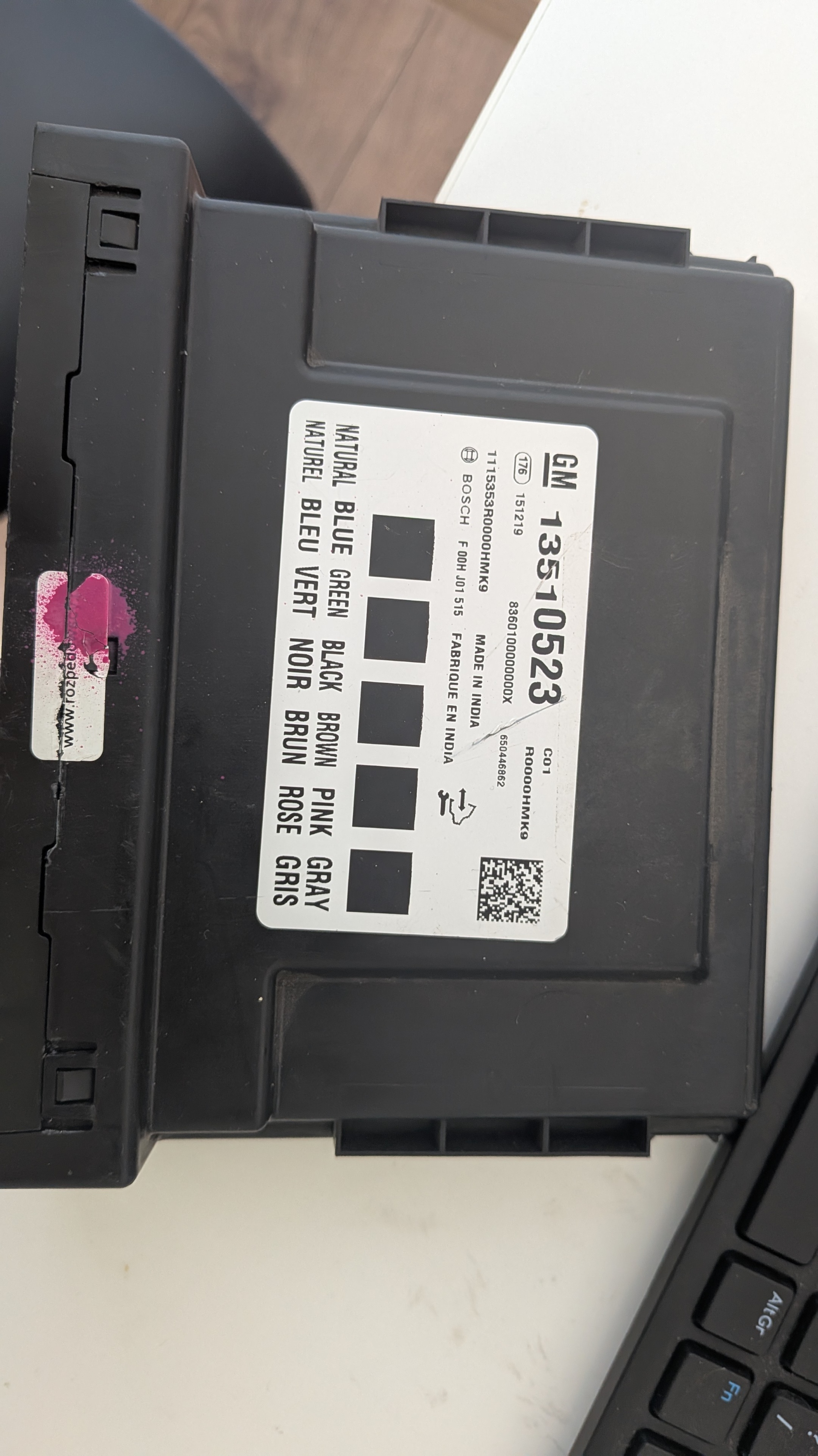

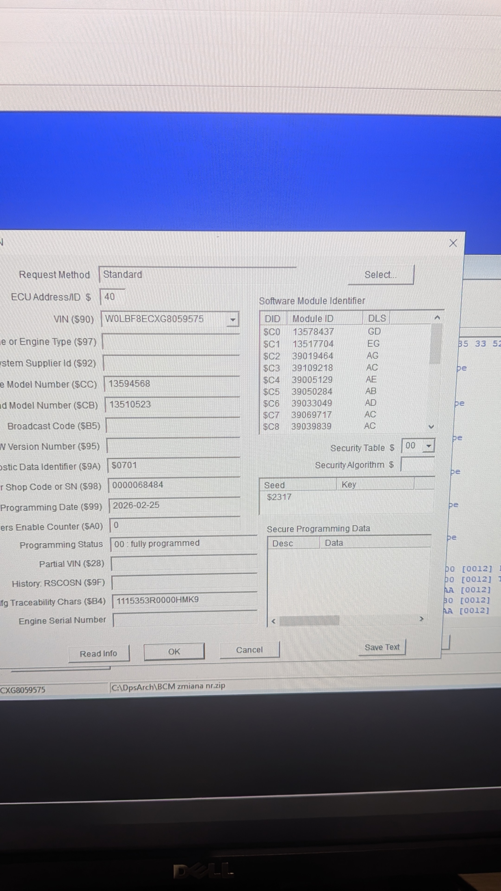

sorry, I forgot to add a photo with the BCM number, I bought it from another engine with the same numbers as mine

Save that DPS info as text file and place here.

here my friend

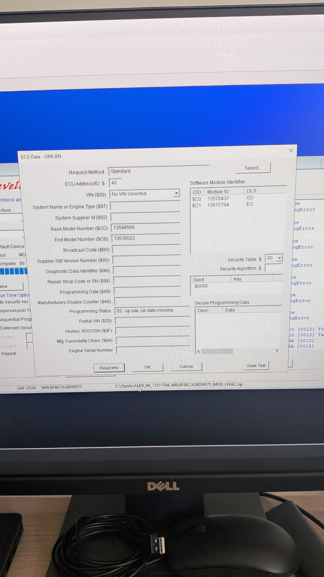

I'm having a problem with DPS. It's giving me an error at 99% and only uploading two calibration files. I rebuilt the file in DPS and only replaced one file, number 20, and it's giving me an error. I don't know why. Can someone check if I built the file incorrectly?

show DPS log

39084723-HVAC is not compatible with your BCM
