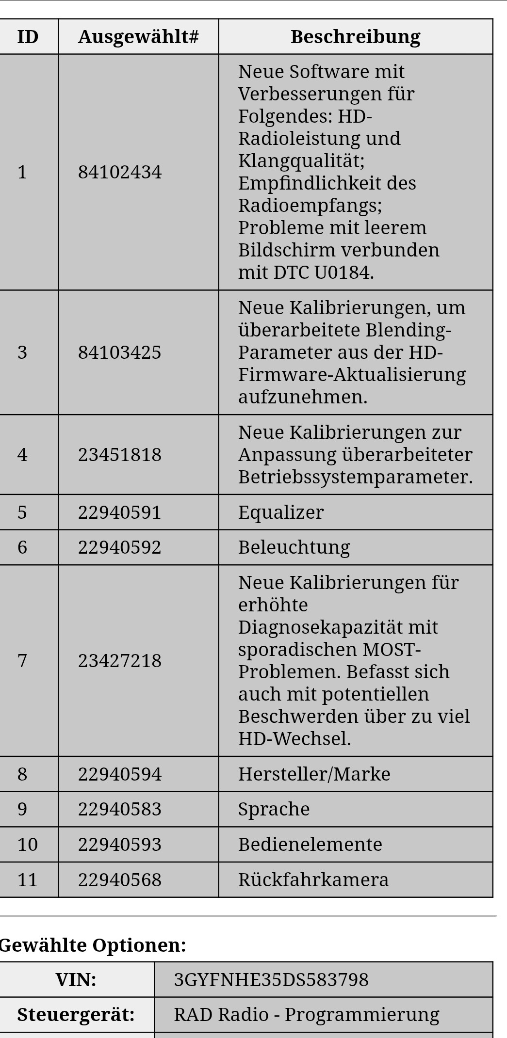

Hello, does anyone happen to have European HMI calibrations for an Escalate HMI 2.0 FIN
HMI 2.0
and Silverbox A11
3GYFNHE35DS583798?

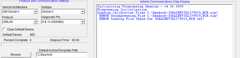

hi i try to program the bcm but have this error. is possible you help me why give me error??
Seems that archive is created wrong.

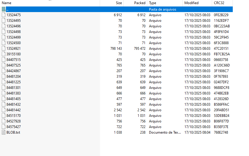

this is the unzip file
3GKALMEV3KL379819 any one can help me whit bcm dsp file??
i have this dps file but i give error
the car is gmc terrain 2019
3GKALMEV3KL379819_BCM.zip
That ZIP file is not a DPS archive. You must create a DPS archive file, which you use to program the BCM.
Here is the DPS archive file.
3GKALMEV3KL379819_BCM-DPS.zip
Alternatively, you can manually create the DPS archive file by using this tutorial.
Or create the DPS archive file automatically using this tool.

thanks for the file it work but still have problem

Benötige Radio kalibrierung 3GYFNHE35DS583798
