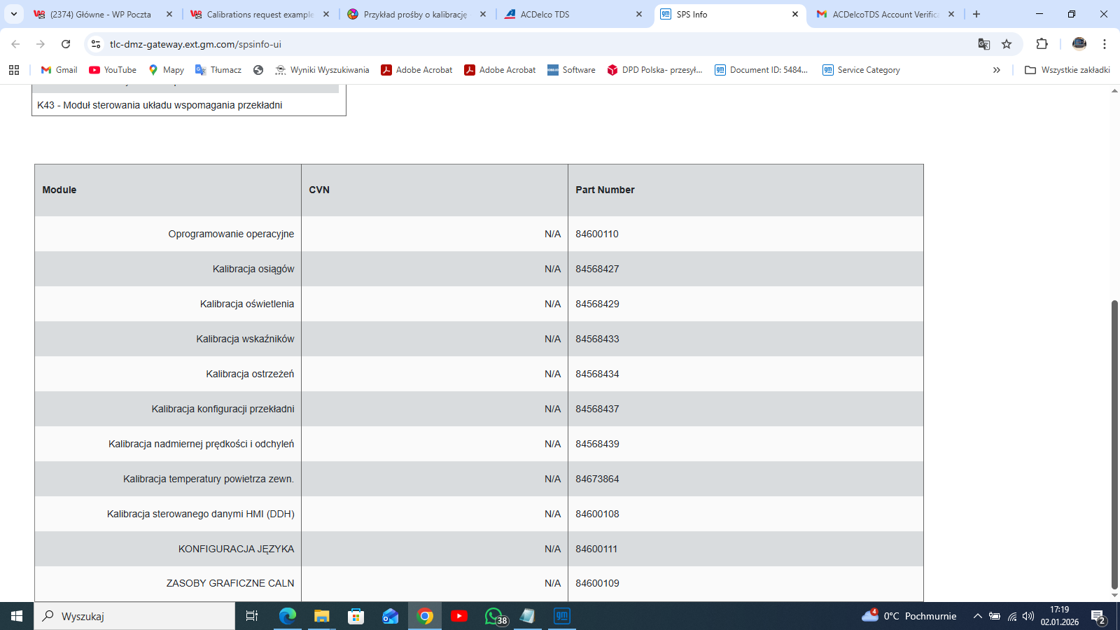

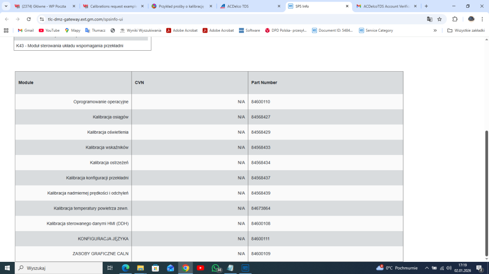

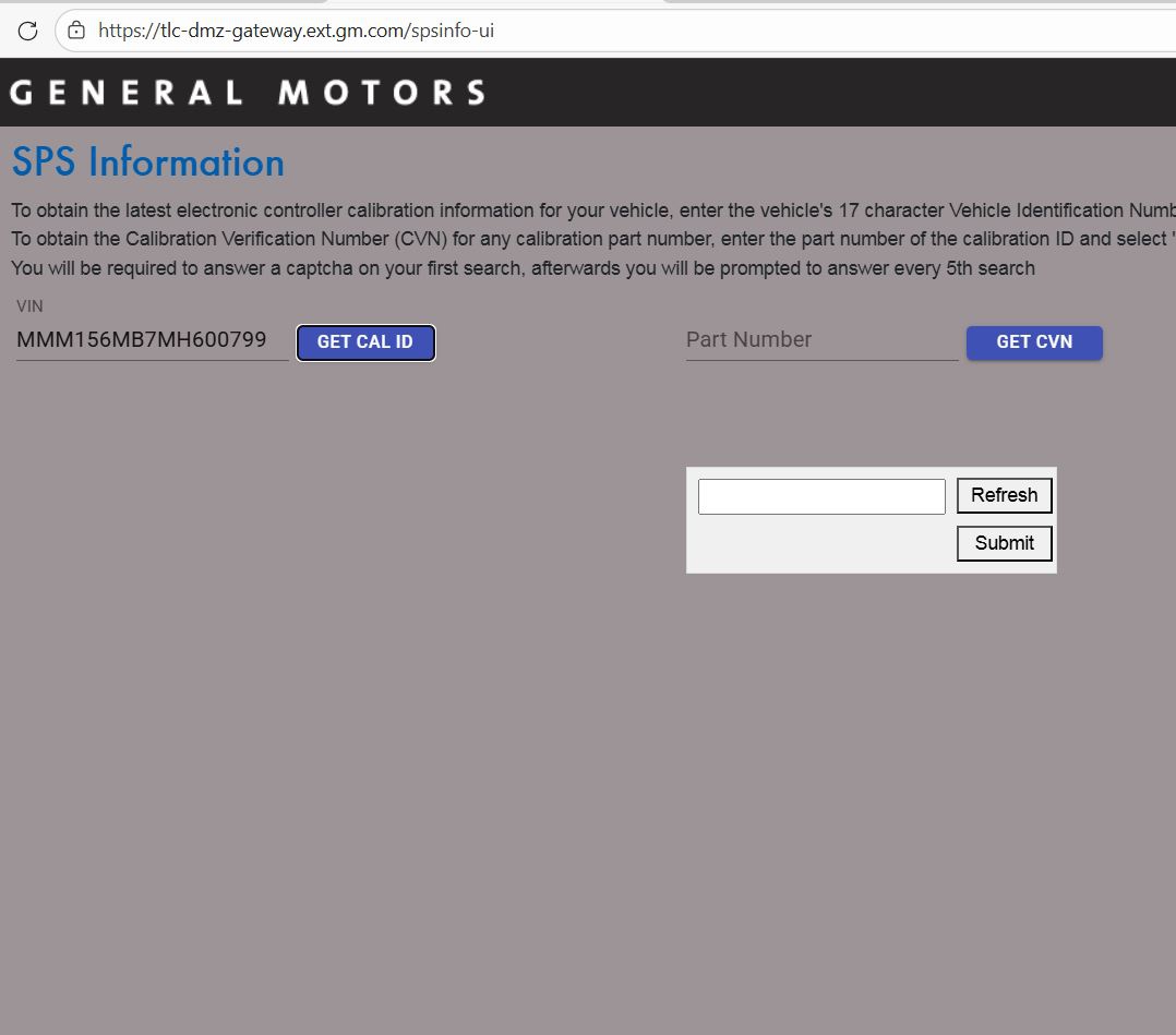

Good day! Please help me find the IPC instrument cluster calibration numbers using the VIN: MMM156MB7MH600799. I'm registered at www.acdelcotds.com, but I use a VPN to access it, so the captcha isn't showing up in my country. Thank you.
Operating Software N/A 84600110
Performance Calibration N/A 84568427
Lighting Calibration N/A 84568429
Gauge Calibration N/A 84568433
Warning Calibration N/A 84568434
Gear Configuration Calibration N/A 84568437
Overspeed and Deviation Calibration N/A 84568439
Outside Air Temperature Calibration N/A 84673864
Data-Driven HMI (DDH) Calibration N/A 84600108
LANGUAGE CONFIGURATION N/A 84600111
GRAPHIC RESOURCES CALN N/A 84600109
