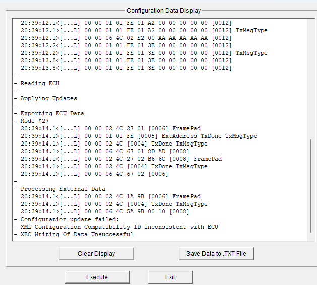

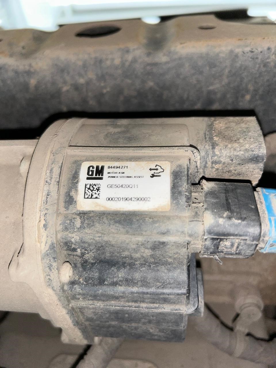

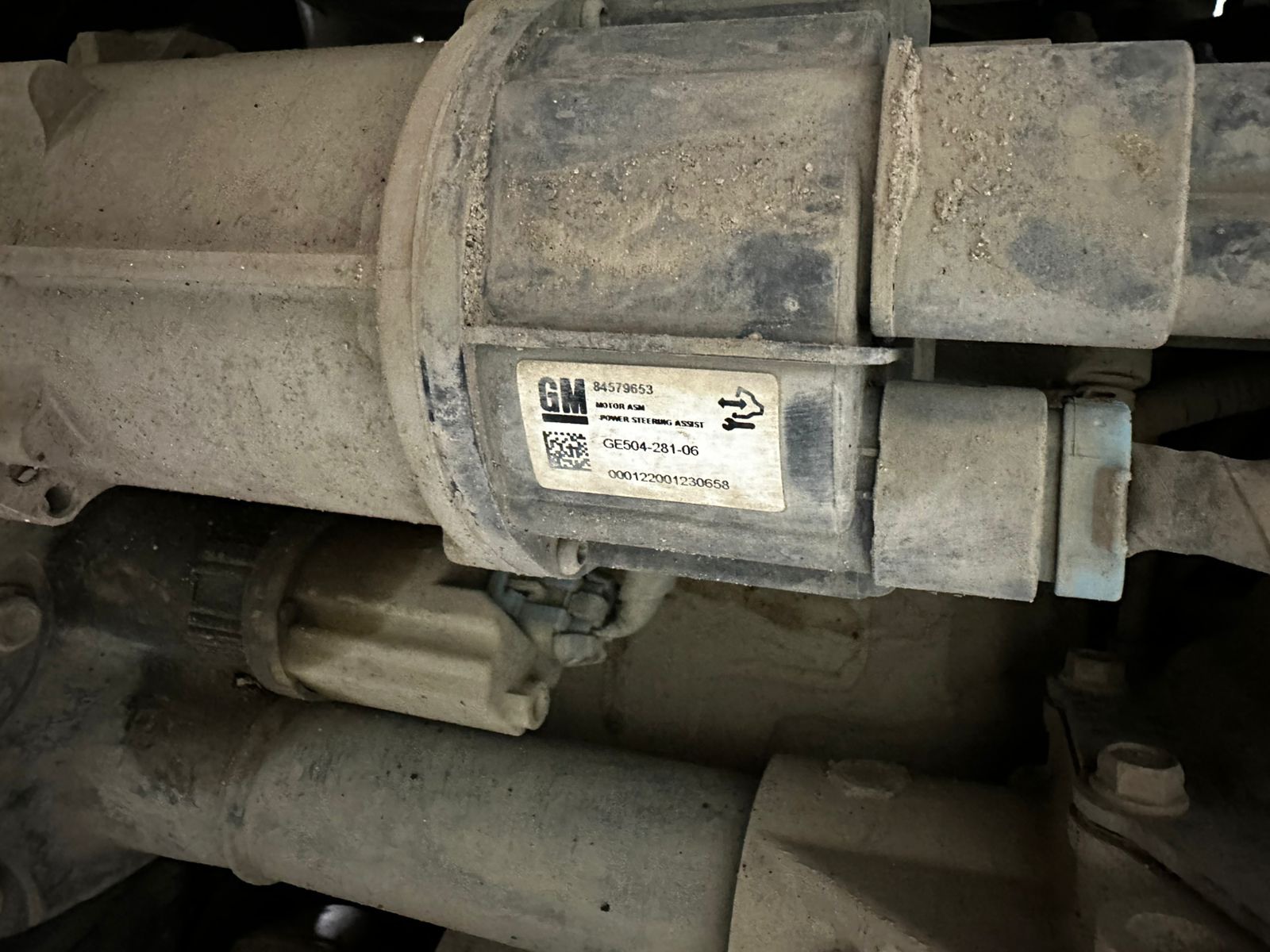

Hello! Need calibrations for electric power steering (EPS) Chevrolet Trailblazer 2 2020 VIN MMM156MB2LH633496 for DPS.
And the question: the electric power steering was replaced with a different number 84494271, will replacing the calibrations from 84579653 (native electric power steering) with 84494271 help? The VIN was registered. Error C056E hangs.
GCI_Log_MMM156MB2LH633496.Txt GCI_Log.Txt

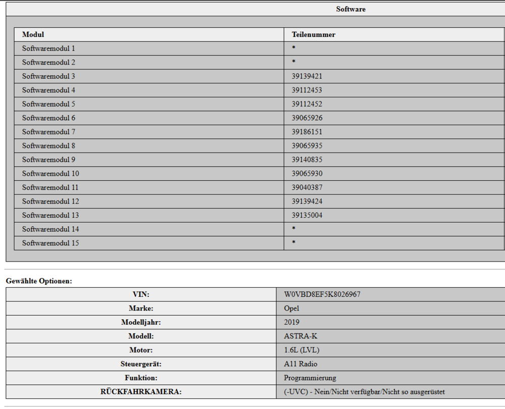

Hello I need A11 calibration without UVC FIN W0VBD8EF5K8026967
Post cgi log from dps

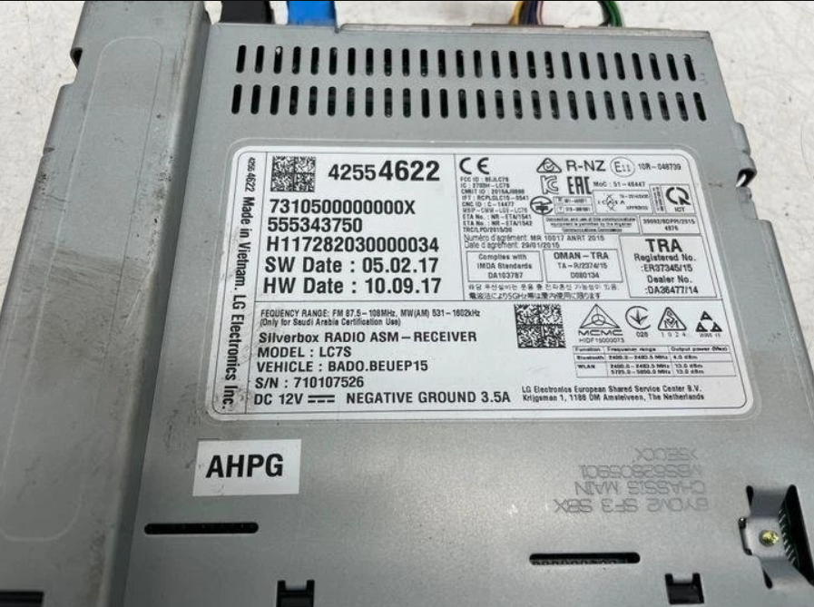

On 10.6.2025 at 15:44, Darius_B said:
Unfortunately I don't have the radio on the bench yet. But I can give you the part numberRadio Astra K .png
Here you go.
W0VBD8EF5K8026967_A11_Radio_-UVC.zip
