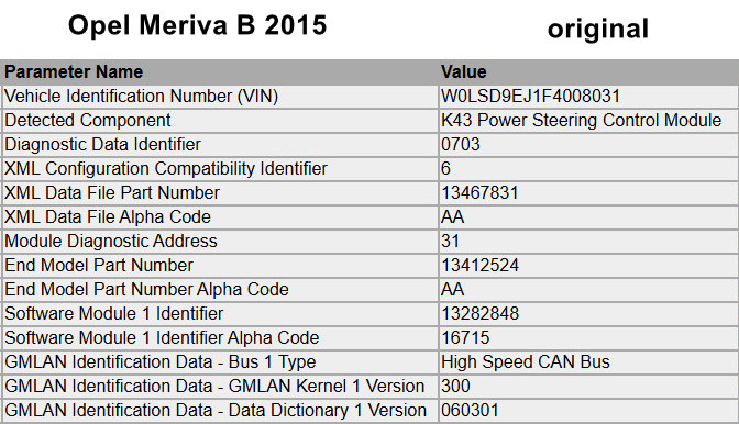

Hi. I am looking for EPS (electric power steering) calibration files:
Opel Meriva B 2015
W0LSD9EJ1F4008031
Opel Meriva B 2015
W0LSD9EJ1F4008031
Go to DPS, select 6-14 pin, read module info with address 31. Save text file and post here, then maybe i can help to get calibrations :)
Opel Meriva B 2015
W0LSD9EJ1F4008031
Oh, i see SPS not have calibrations for EPS. Only Config&Seput. Contact me if you need, we can do it online.

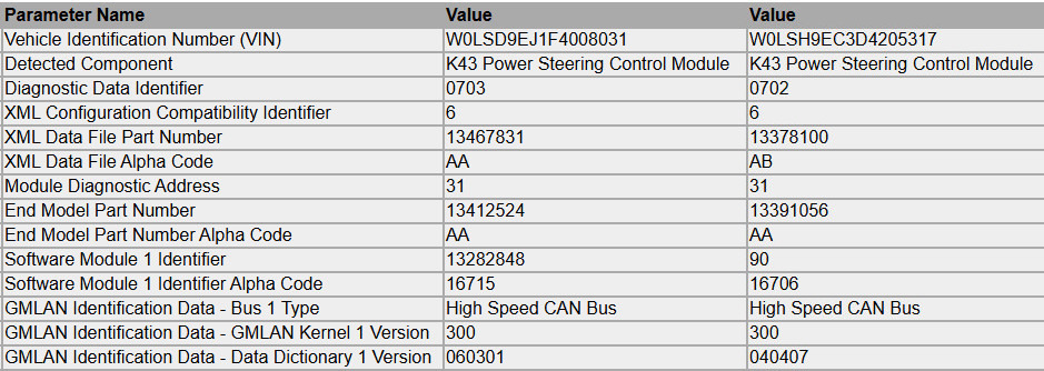

Hi. I have car where they repalced original EPS pump (Opel Meriva) with donor EPS pump (Vauxhall Meriva) and there is error "U0126 Lost Comm. with Steering Angle Sensor Module"
Original pump is water damage but i managed to make communication. Is there a way to program donor with original software?
different part number, there is no guarantee, if that is possible

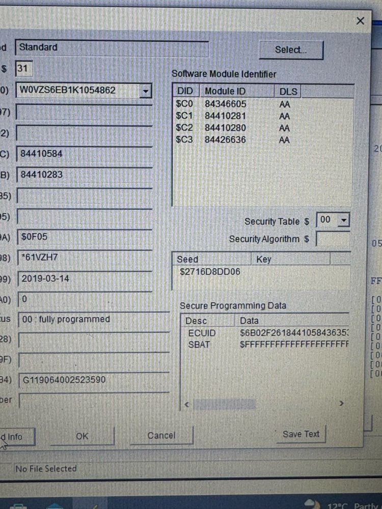

I need to create a file for a member but I’m away from my bench setup.
I’m seeking Insignia 5-Byte EPS calibration files W0VZS6EG3J1094273.
I can help if you can send me dps module info
Here you go.

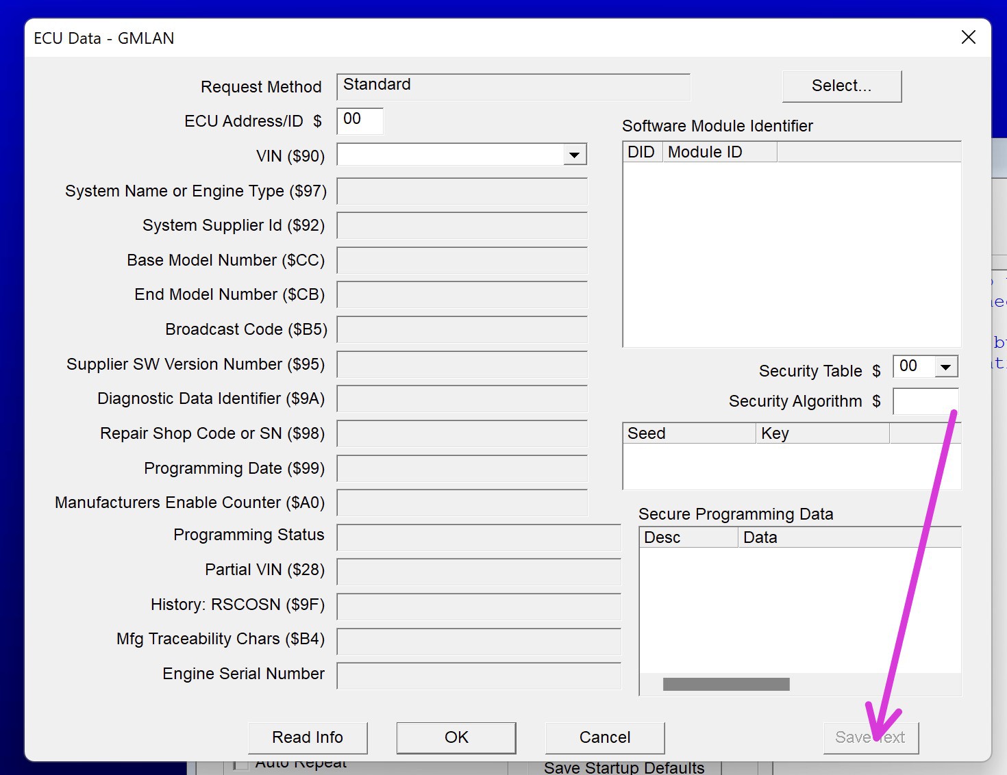

Just now, Troy said:
Here you go.
Text file please :)
1 minute ago, Darius_B said:
Text file please :)
Do you mean this text file after reading?
Or this one?
1 minute ago, Troy said:
Or this one?
Yes, exactly
13 minutes ago, Darius_B said:
Yes, exactly
Here it is.
