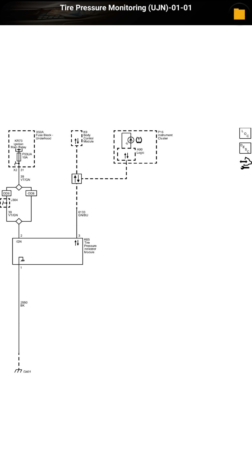

Check if it matches.

I'll trace the wiring as per above as that may explain the above issues.

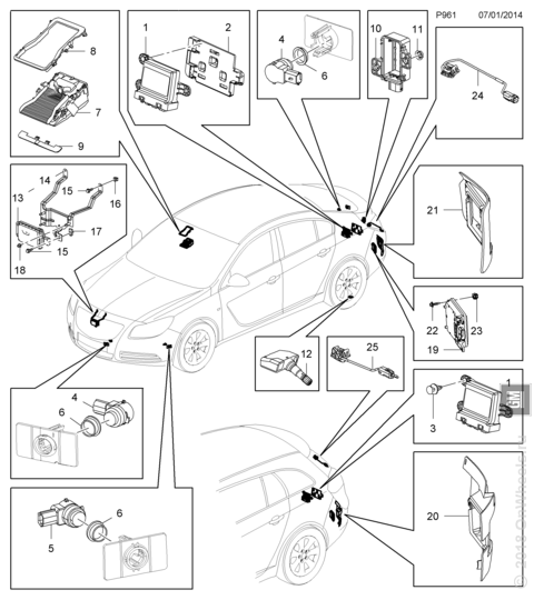

You installed TPMS tyre pressure monitoring control modul K65? Location 10 in picture.

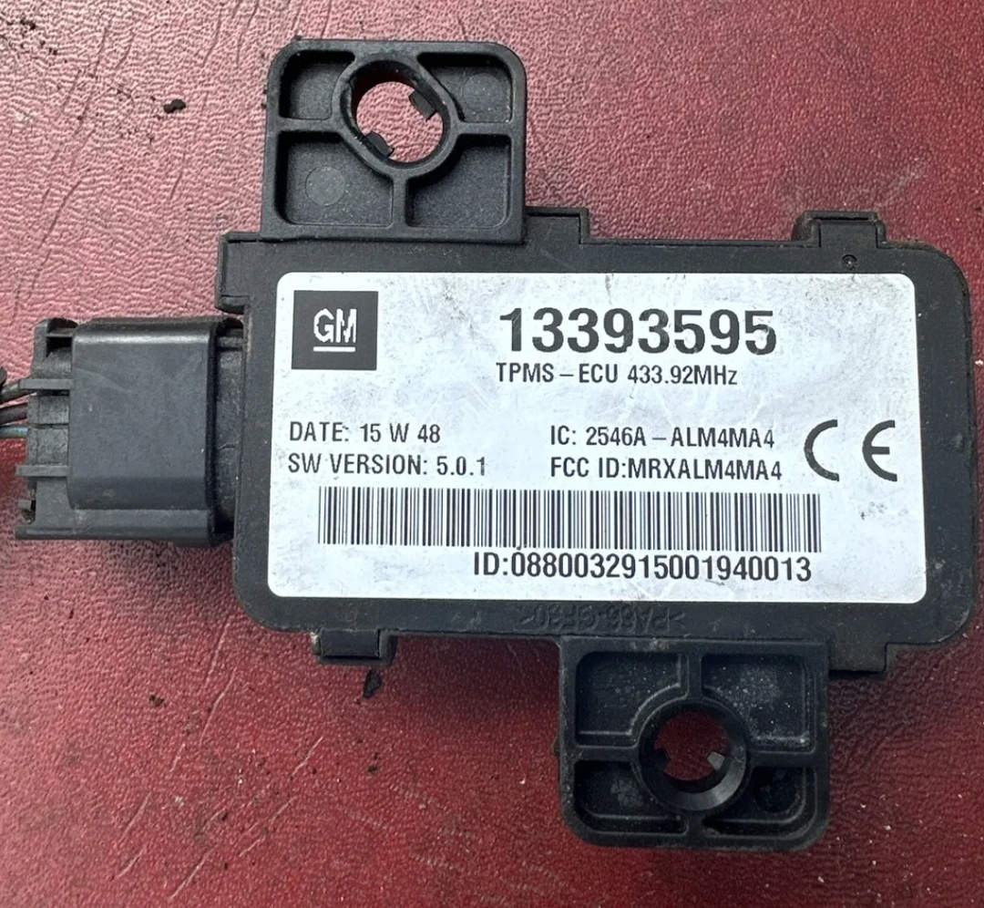

Yes I installed part number 13321961

Apologies for typo I fitted 13393595, this still wrong?
Unlikely,  unless it's bad modul.  Both are analog, i check.
Check the module connectors for oxidation and  ignition/ ground 12V

The connector has not been connected for a long time, be sure to check for oxidation. is there 12v power and K65 3pin(6133 GN/BU) connected to BCM X6-9pin Green/Blue (6133 GN/BU).

Module 13321961 (RPO UJN) Tire pressure indicator automatically learns, used until 2014 with tire sensors 13581560; 13598901; 13507403.
Since 2014 used 39047085 (RPO UJM) Tire pressure indicator manual learns, with tire sensors ??????.

Module 13321961 (RPO UJN) Tire pressure indicator automatically learns, used until 2014 with tire sensors 13327259; 13348393; 13581560.
Since 2014 used 39047085 (RPO UJM) Tire pressure indicator manual learns, with tire sensors 13598775.

What RPO are you trying to activate UJN or UJM? Your sensor is UJN, it doesn't know how to behave as a UJM. When you try to teach the sensor, it just doesn't respond because it doesn't understand the command.
I beleive UJN? my IPC has been changed to an 8" updated to 2017 software.
To activate the BCM I used the chassis calibration block from a 2014 with TPMS swapped (39069337 to 39069339) you are possibly onto something there if IPC being from 2017 (software) then would that be looking for manual (UJM) whereas the BCM has 2014 software so UJN? I think the module is from 2015.
