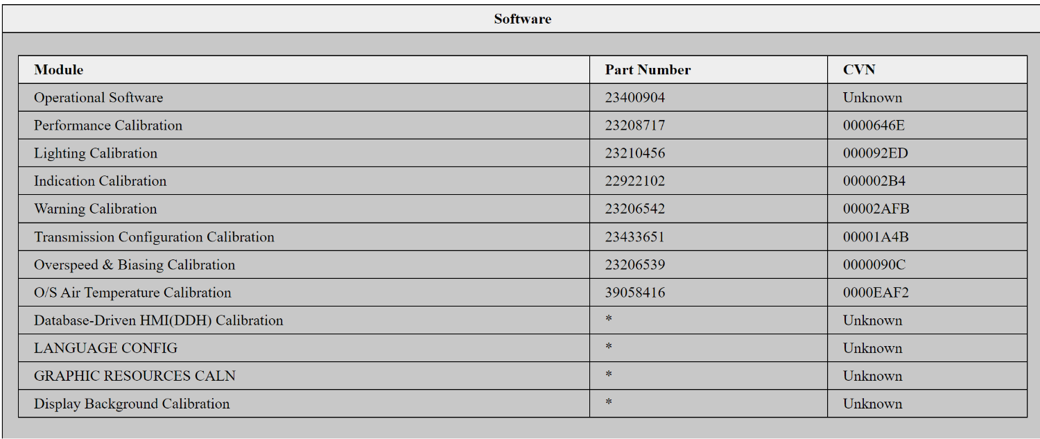

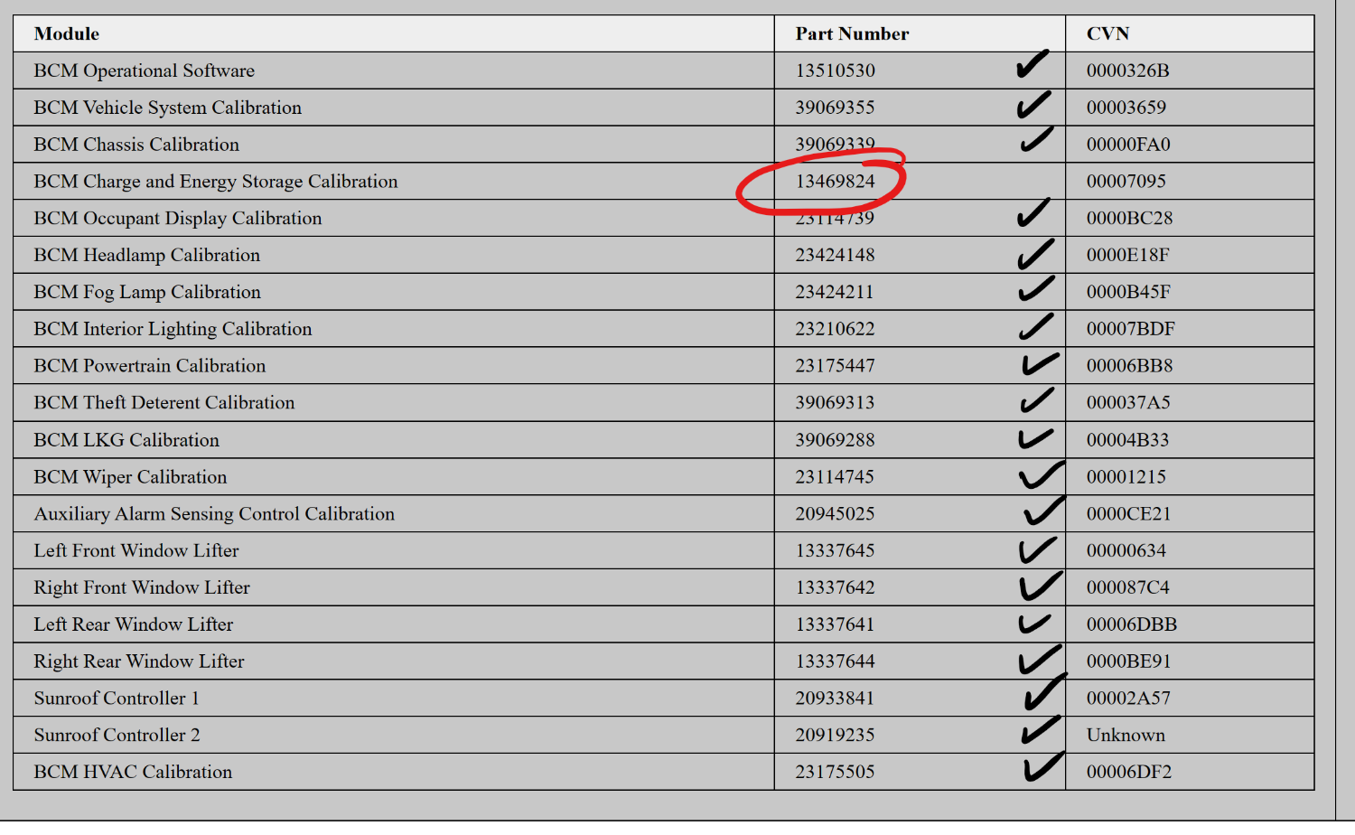

Hmmm so looking through the calibrations you sent and mix/matching from some I had kicking around i'm still missing one file.
The vehicle I beleive has every file needed is W0LGT8ES9E1196857
u very lucky 🙂 I have this file in my storage 13469824.bin

Did you end up flipping the Chassis Control calibration to see if it lights up TPMS?  I know where it is in the IPC cals if you need that one set.
I'm going out to do it shortly.  The IPC set would be ideal of you have them.  Although i think IPC needs an update or something as instead of showing track info is shows "Audio Off" when i use my retrofitted HMI2.5 on Android Auto.

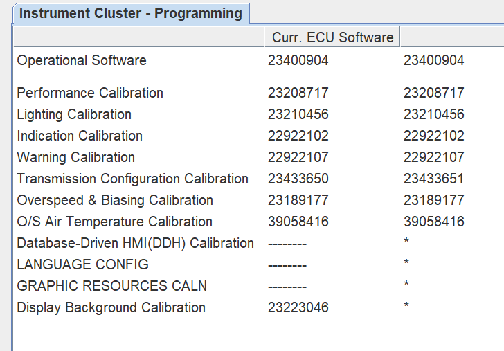

This is correct ones but for a Manual Transmission, mine is auto - I *think* it has TPMS enabled just wrong transmission?
my config is attached also to compare
P16 IPC 4``.rar
TPMS wasn't enabled so I flipped it on for you.  I can't say for sure on the transmission one, you can always try it and if it doesn't work, we can try swapping the transmission calibration that Lyubomir provided.
