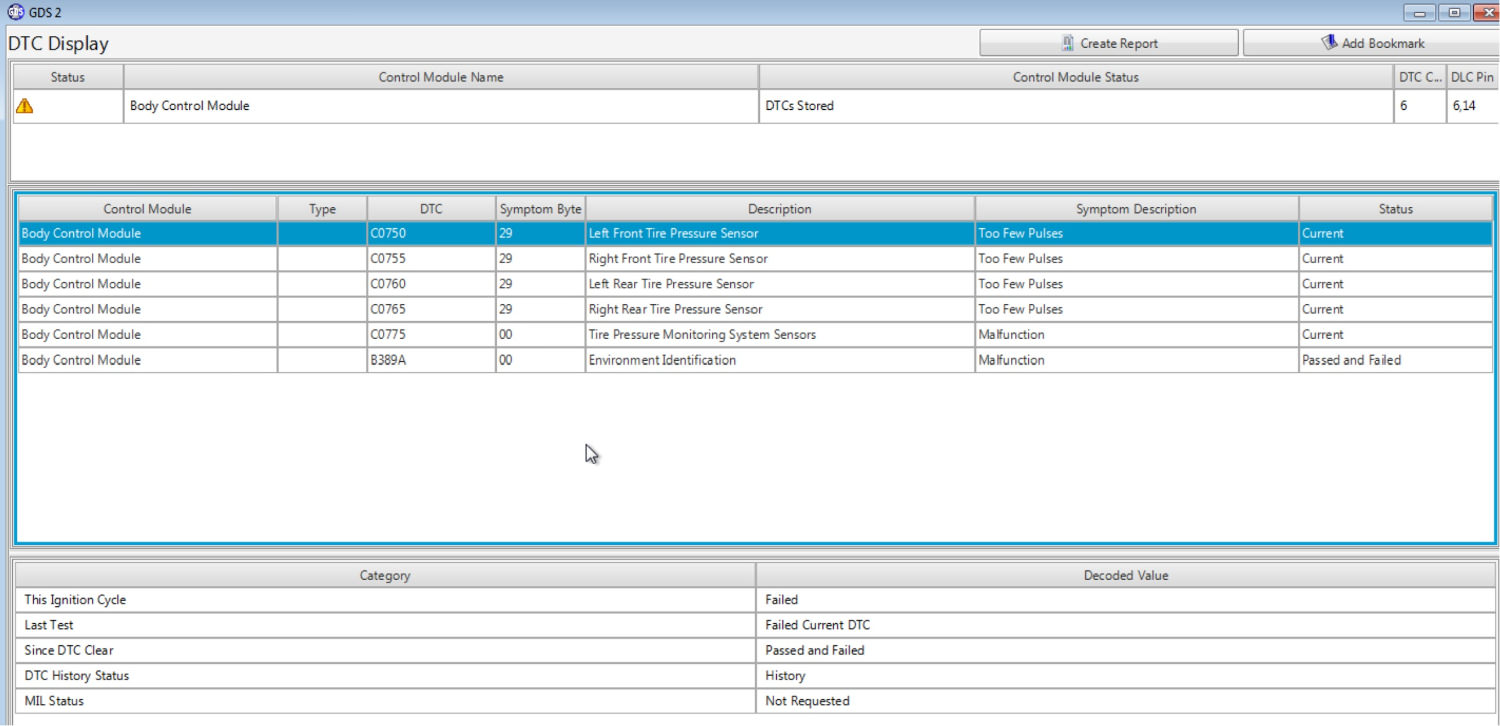

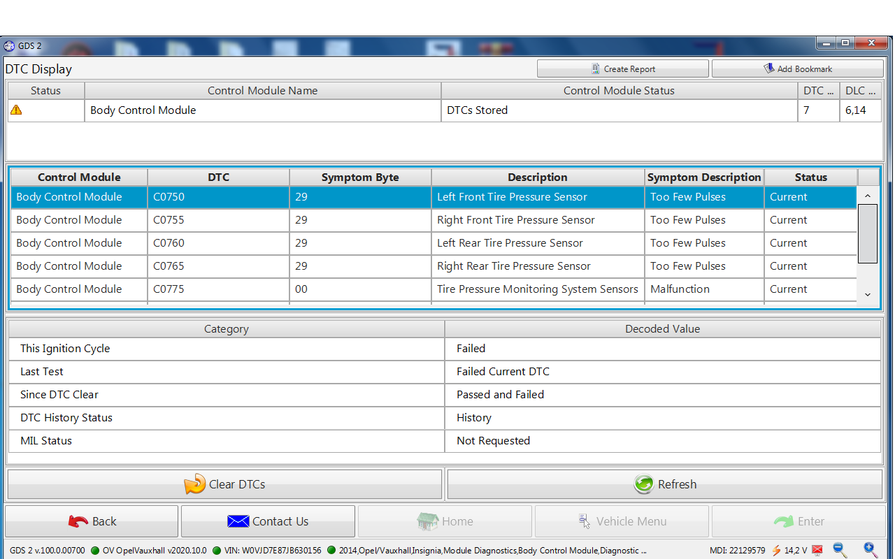

So i never did get this working, i assumed it was due to my cluster, however i have now changed out the cluster.
When i originally stated @codebuilder that my car was misbehaving with the calibrations from W0LGT8EM4E1123090 it turns out that was not a fault of the calibrations, it was that I needed to relearn brake pedal position, I reapplied them and did the relearn and been solid since then.  Hence why it was hesitant on accelaration and brake lights came on when parked.....

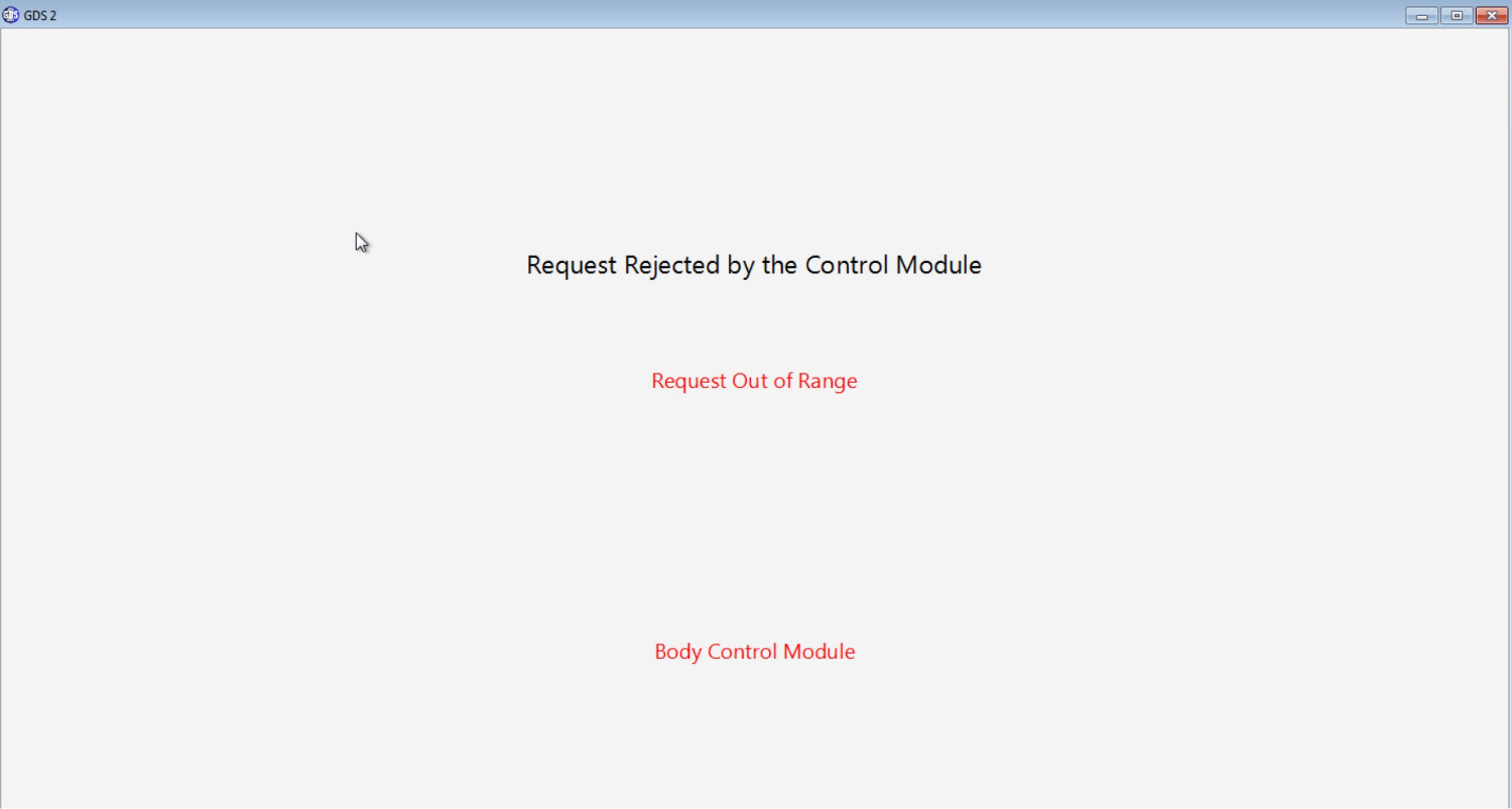

However even with these calibrations and a new cluster with TPMS it doesn't work.  When i try to learn the sensors with GDS2 it either says "out of range" or "lost communication with module" when i press and hold the steering wheel button on the TPMS menu instead of doing the learn procedure (should it?) it does nothing.
Looking back at what @Lyubomir Krastanov said maybe you were right I should run the XML file afterwards if anyone has 23134628.xml ?
