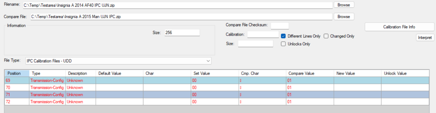

26 minutes ago, Lyubomir Krastanov said:
that is differences when 2014 Insignia have Manual or Automatic gearbox, as well calibrations included. Car have TPMS enabled
added file from same year, but with Manual gearbox. For compare if someone is interested
Insignia A 2014 AF40 IPC UJN.rar 248.04 kB · 1 download   Insignia A 2015 Man UJN IPC.rar 248.03 kB · 1 download

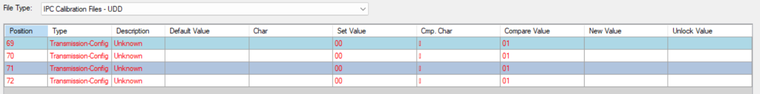

Veeerrryyy minor changes in the Transmission Config file.  4 bytes.
but still have changes, no idea what are they for. As well need to be done Setup and Configuration after module update. I failing to make Type4 DPS archive even follow all steps, may be because I'm a bit lazy and simple use SPS to do this 🙂

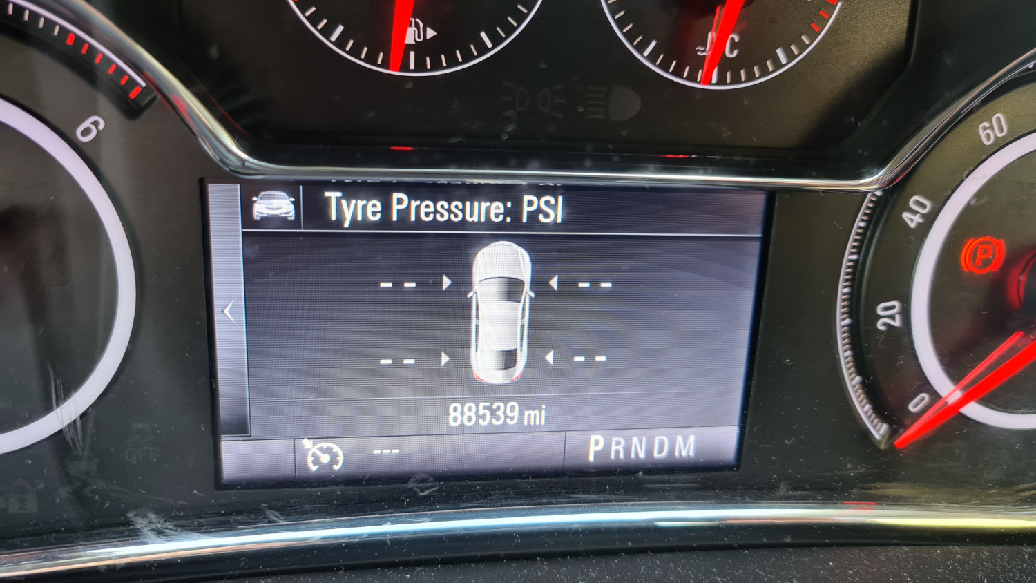

Thanks you fine people all working as expected!
Just need to drive to learn the sensors but all looking good!

Actually just drove it there is a huge flat spot when accelerating I'm wondering if chassis cal is for a manual trans? Might have to revert it.

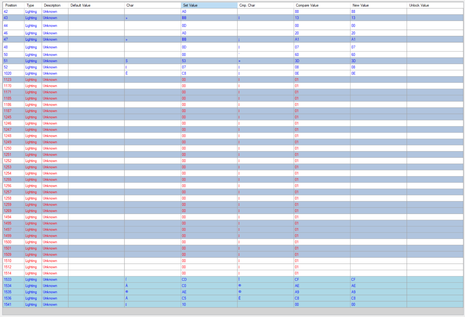

@codebuilder can you compare the attached and advise what difference is?
3_39069337_NO_TPMS 3_39069339_TPMS
12 minutes ago, Vauxhall_Mark said:
Hi I restored original cals and it's driving normally (except moaning about Service TPMS but I didn't have cals to change IPC back so that's expected)
I used W0LGT8EM4E1123090 as reference for BCM TPMS cals and only difference is blocks 3 is 39069339 (TPMS) instead of 39069337 (No TPMS) however when I program it the gearbox misbehaves and when car is parked brake lights permenantly on.
They are both Auto Tourers with same engine code.
3_39069337_NO_TPMS 1.53 kB · 0 downloads 3_39069339_TPMS 1.53 kB · 0 downloads

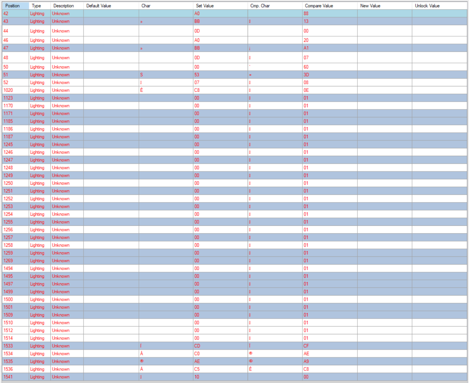

These are the only changes I see...  but this CAL for sure is what's enabling TPMS?  Usually that's another file although your cluster may be different than what I'm used to (cals could be different).  I'm happy to try modifying sections of this for you and sending you some to try?
Hi,
I'm happy to be advised by your superior knowledge but I though the only difference is Chassis Calibration Block 3?
all those are light changes which may explain the brake lights but not gearbox?

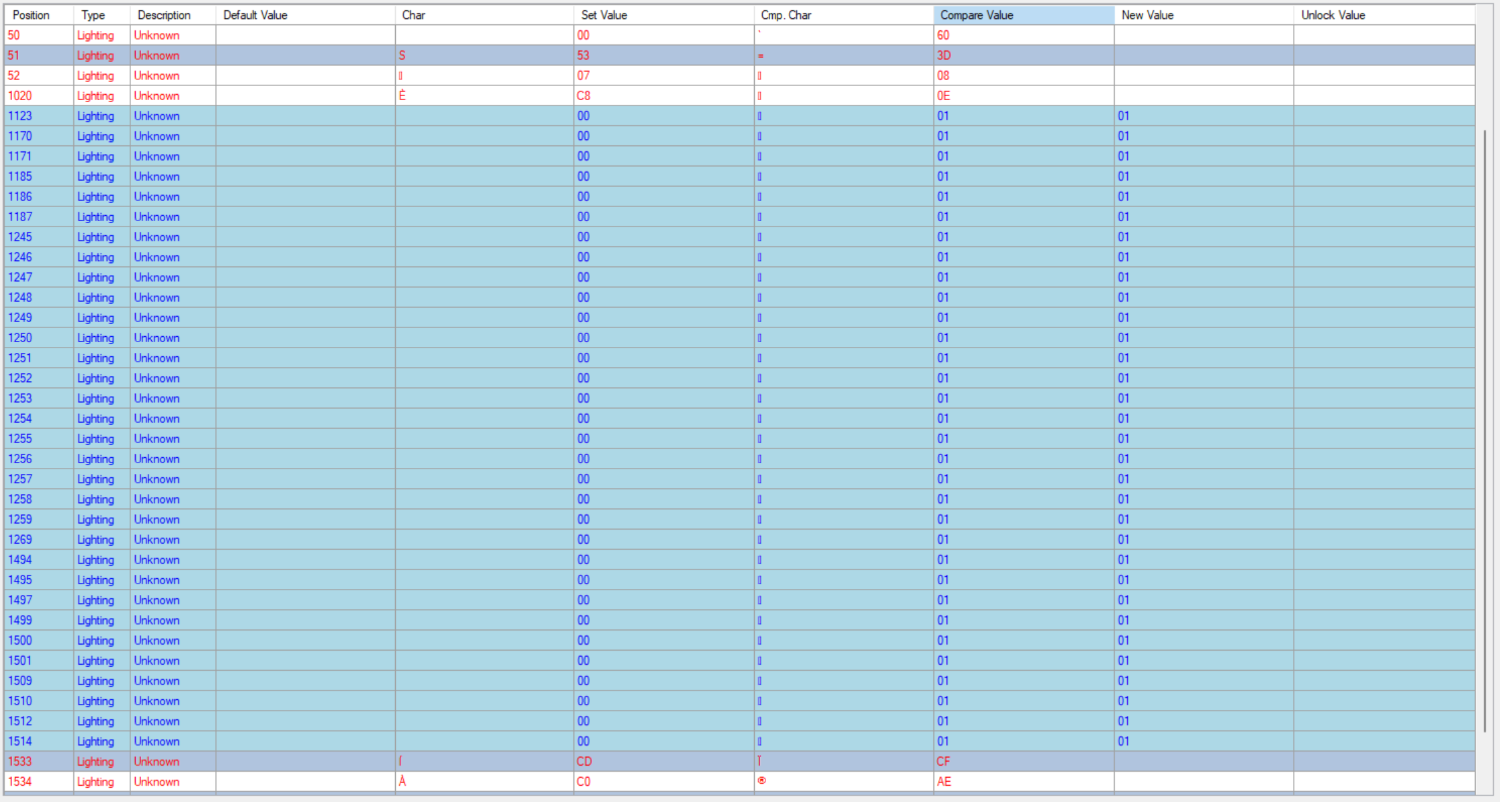

Try this attached one, I flipped the 0's to 1's.  My apologies, I thought this was an IPC file originally :).  It's BCM.  But try this attached one and see if it works?  If it still limits you, we'll do the opposite.
image.png.cebeb12e76cf0a9830b3221001fe3418.png3_39069337_MOD1
image.png.cebeb12e76cf0a9830b3221001fe3418.png 3_39069337_MOD1 1.53 kB · 0 downloads
Would lighting section affect gearbox?
I had it selected as IPC not BCM, it's ok.  You can ignore that 🙂

Here's the opposite to try if that doesn't work 🙂 (again, ignore Lighting, I just have IPC selected as a label)
3_39069337_MOD2
