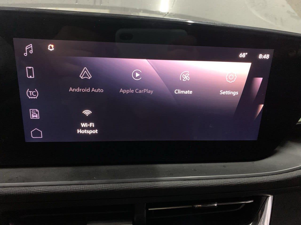

Hi all. I need calibration munber 42896005.
buick envista = chevrolet trax = opel mokka
KL47LAE2XRB057257
A11 Radio

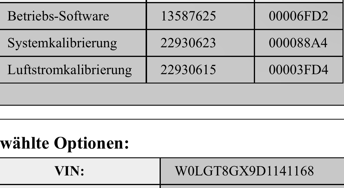

Hello need files from W0LGT8GX9D1141168 K33 Module HVAC
But unfortunately I don't have a base or end number
Hi all.
I'm looking for calibration munber 42896005.
Buick Envista = Chevrolet Trax = Opel Mokka
KL47LAE2XRB057257
A11 Radio
