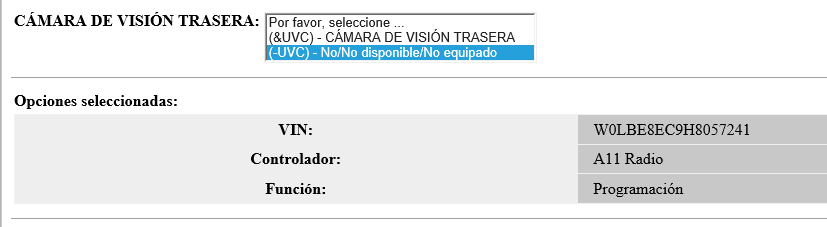

16 hours ago, Astrafan said:
Hello, I need the calibration for the two FINs for A11 without rear view camera
W0LBE8EC9H8057241
W0LBE8EB3G8089026
W0LBE8EC9H8057241.7z W0LBE8EB3G8089026.7z
Looking for the calibration files for
5GALRCED2AJ127040
On 6/23/2024 at 12:29 PM, Arbe_gtc said:
What is the difference with RVC? I didn't change my A11 calibrations only in the HMI and it works fine should I change calibration for A11 and if so which bytes/calibration?
The calibrations of this vins are from IOB radio.
For IO5/6 (HMI) you only need changhe the HMI calibrations not in Radio
IOB: Camera connected to RADIO
IO5/6: Camera connected to HMI
The calibrations are different if camera fitted but I don't know why, I compared two VINs

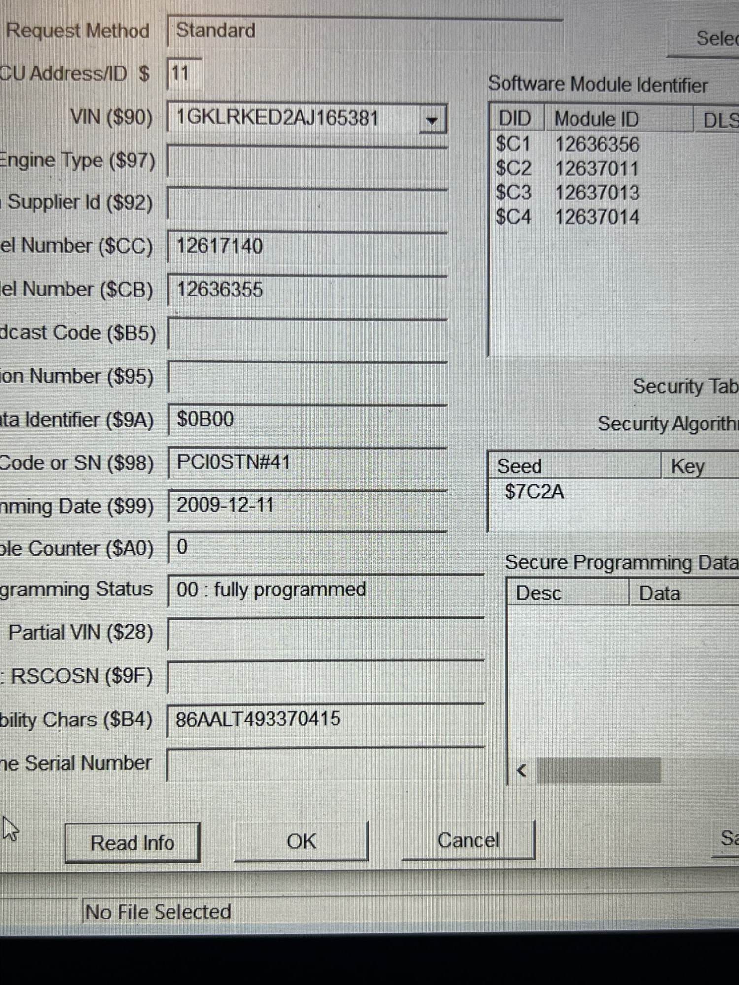

On 6/23/2024 at 11:44 AM, benkej said:
Dear @Lyubomir Krastanov,
you can pick first one from the list what is available iot. Unfortunately, I don't have simulator and can't download the file.
I appreciate for your help.
Regards, Janos
To entry controller without having actual one I need Base and End model numbers. Not always is available. In some cases I need to know and current OS/Calibration part #1.

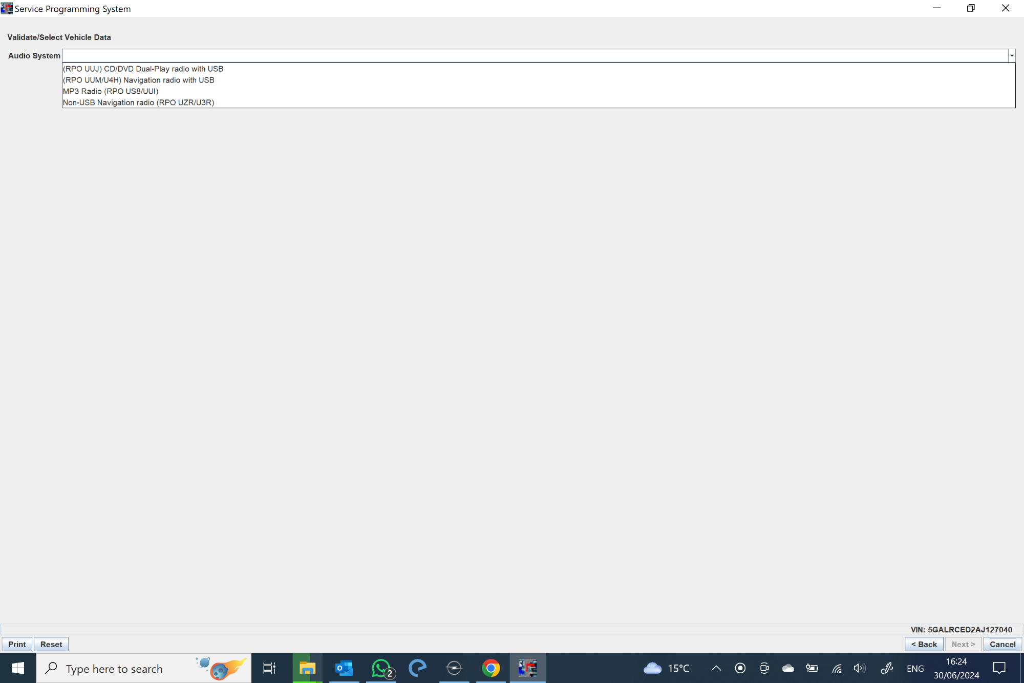

5GALRCED2AJ127040
which option?
The vin 7247 have rear camera. the message request calibrations without camera. I provided it Without camera

1 hour ago, Razors said:
Here are your Files. There was no option for RVC. So it´s without RVC
W0V0MAP08K6026667.zip 14.12 kB · 0 downloads W0VPE9E70K1034971.zip 14.16 kB · 0 downloads
When people check for calibrations in SPS info get option to check for RVC. When files been downloaded from SPS, servers show and download only files agains RPO codes
In some cases, SPS can download both calibrations for some VIN. i means. SPS ask to you the RPO you need, with UVC or without UVC.

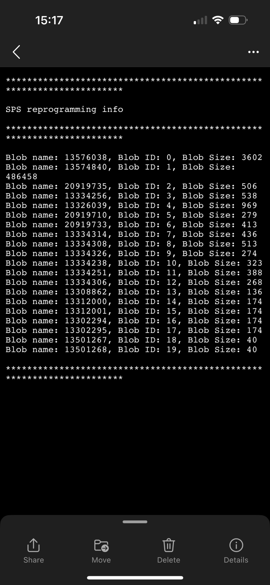

15 hours ago, Tobias Friedrich said:
Thx a lot!
Could you also post a screenshot of the order of the software blocks? I cant identify it for both radios.
The software on the radios has in 3 Position complete other partnumbers
Did wasn’t included calibrations sequence file? @Razors when you make it can you include sequence txt file. Will help person to build/identify files. Yes everyone can check via tis2web, but out of curtesy I always include txt file how files is loaded for module.
