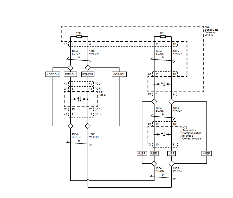

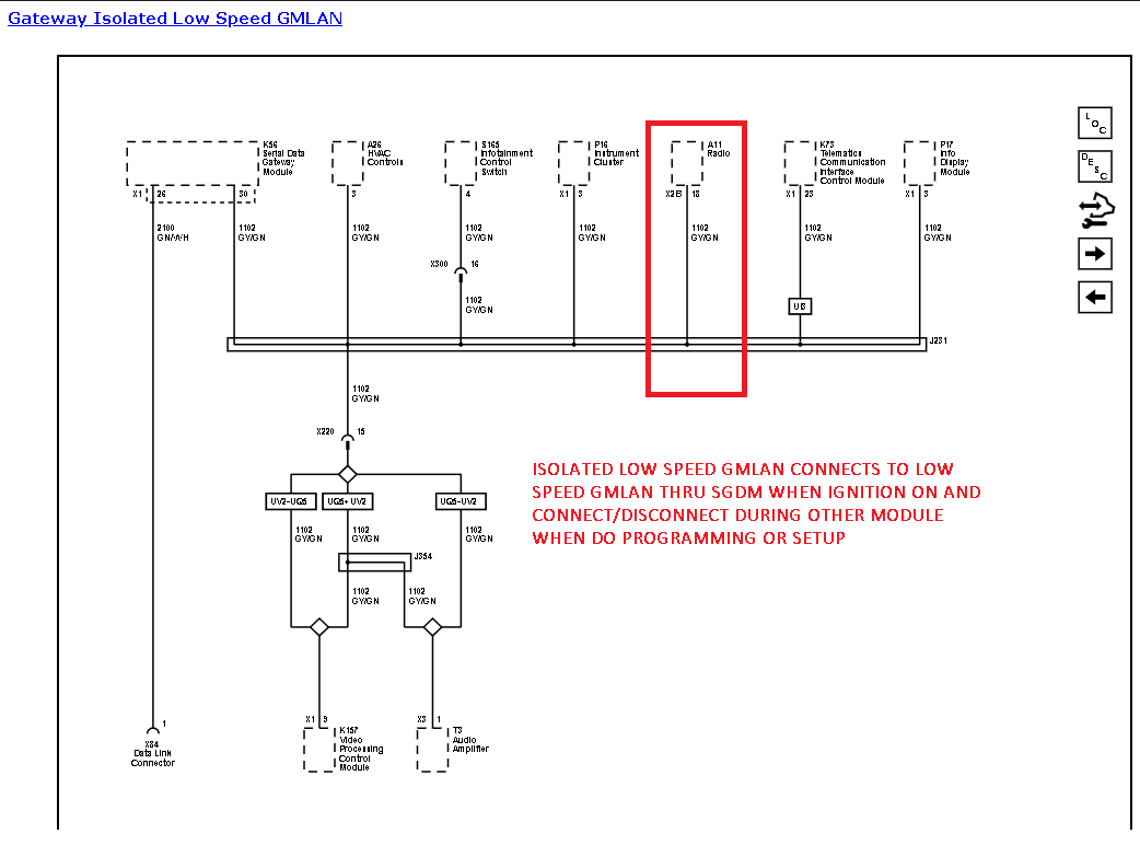

  • if you put a 120 OHM resistor in the HS speed wires of the radio, you should communicate without the serial gateway module This: Mouser REF: 829-15429045 Fabr. N.º: 15429045 Fabr.: Aptiv (former

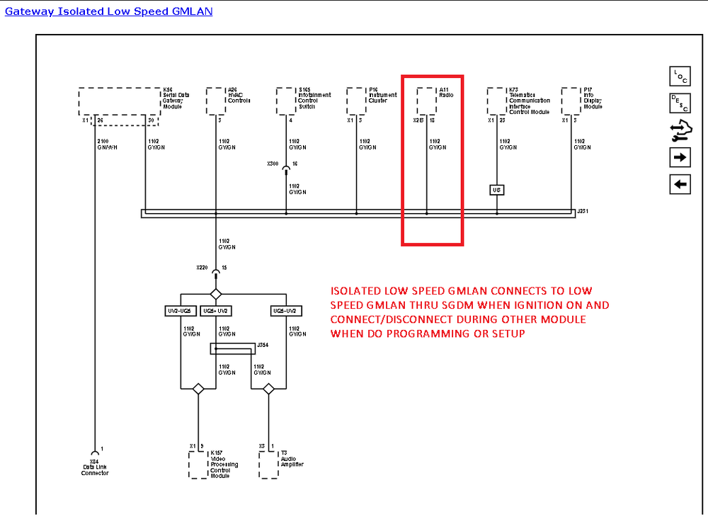

RADIO was pin 1, low speed gmlan
30 minutes ago, GM-Enthusiast said:
RADIO was pin 1, los speed gmlan
Old unit radio are on Pin 1 but the harman 3x are on 6/14 500kb

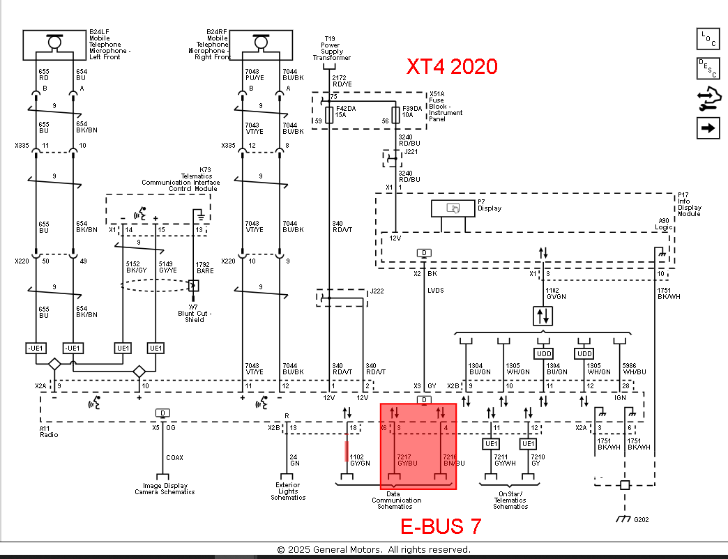

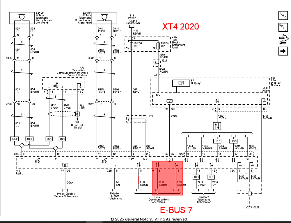

X2B LOW SPEED GMLAN, AND ETHRNET BUS 7 X6, PIN 3 AND 4, NO HSGMLAN
Thx strange that i can get all the controller info on pin 6/14 in DPS, i got this unit used so not 100% sure its from a XT4 PN is 84799330, if i try pin 1 i get no info at all

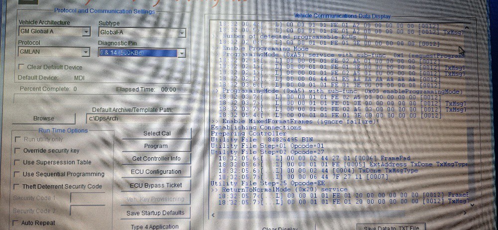

This radio works on CAN 6/14 and most likely dps archive tool creates wrong zip. What error do you get while programming? Also you can check if archive is done correctly in dps.
Thx yes thought it was on 6/14 pin , will check the archive in DPS but what im reading the V2 DPS archive creator should work on global A and B calibrations also?
Attached is the error when starting the programming

Thx for trying , wonder why its not working here , using hmi 3.5 + display with obd harness and have connection and all is working , have DPS 4.46 set to Global A and 6/14 pin , have tried MDI and also another J2354?
Here is the programlog.txt file if anyone can see what the problem is why i cant program the unit with the XT4 archive?
Using DPS 4.46 with MDI 1 selected Global A and 6/14 pin (unit is xt4 2020 csm 3.5 Harman so Global A unit , i can read the controller info but can not program with the archive thats tested and working by other member.
Bench setup with only HMI 3.5 + Display and obd, the setup is turned on and working on bench
ProgramLog.Txt

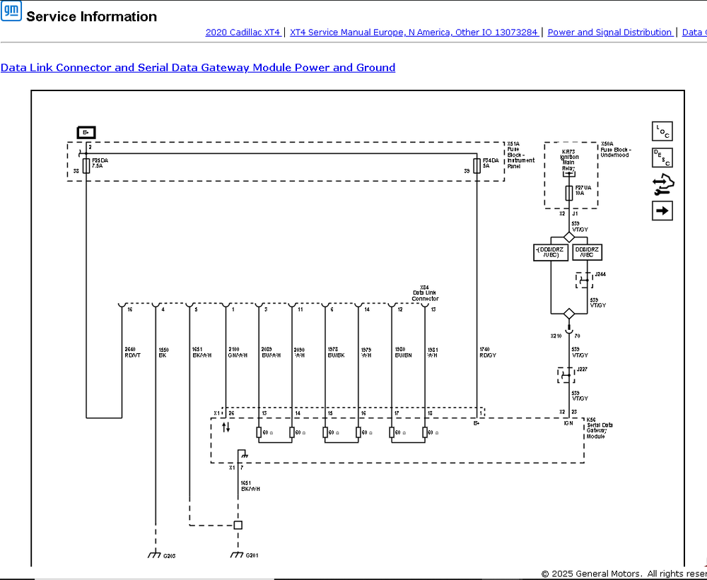

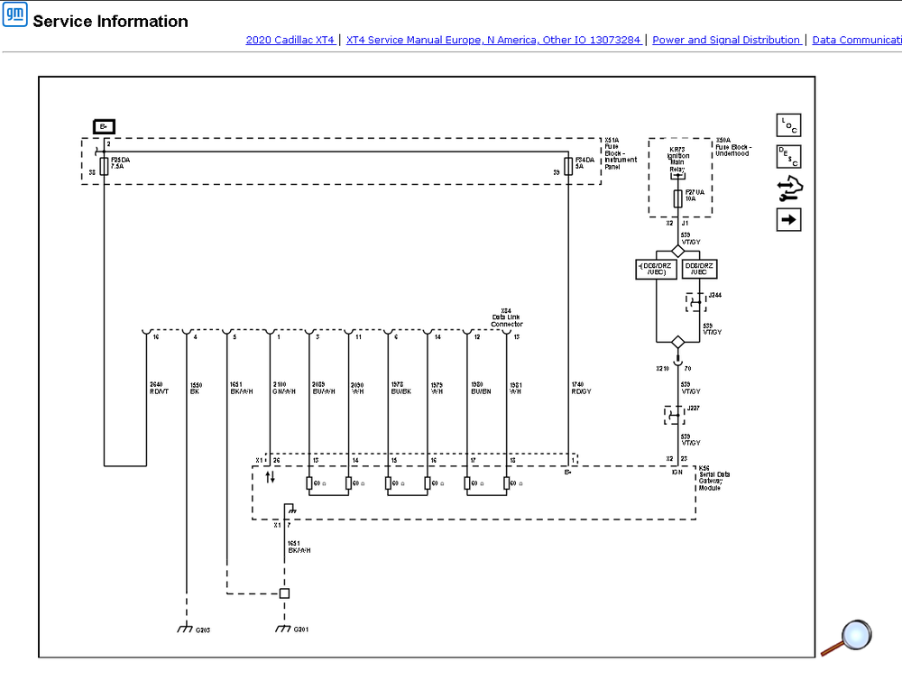

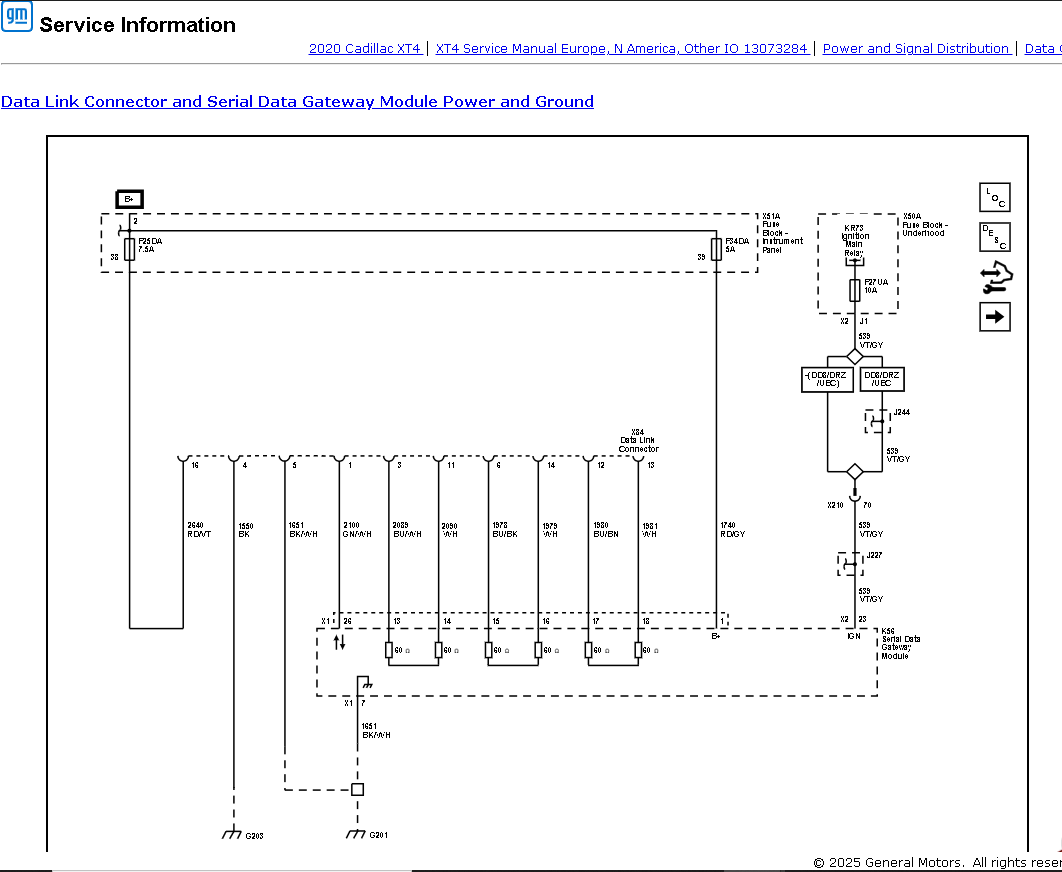

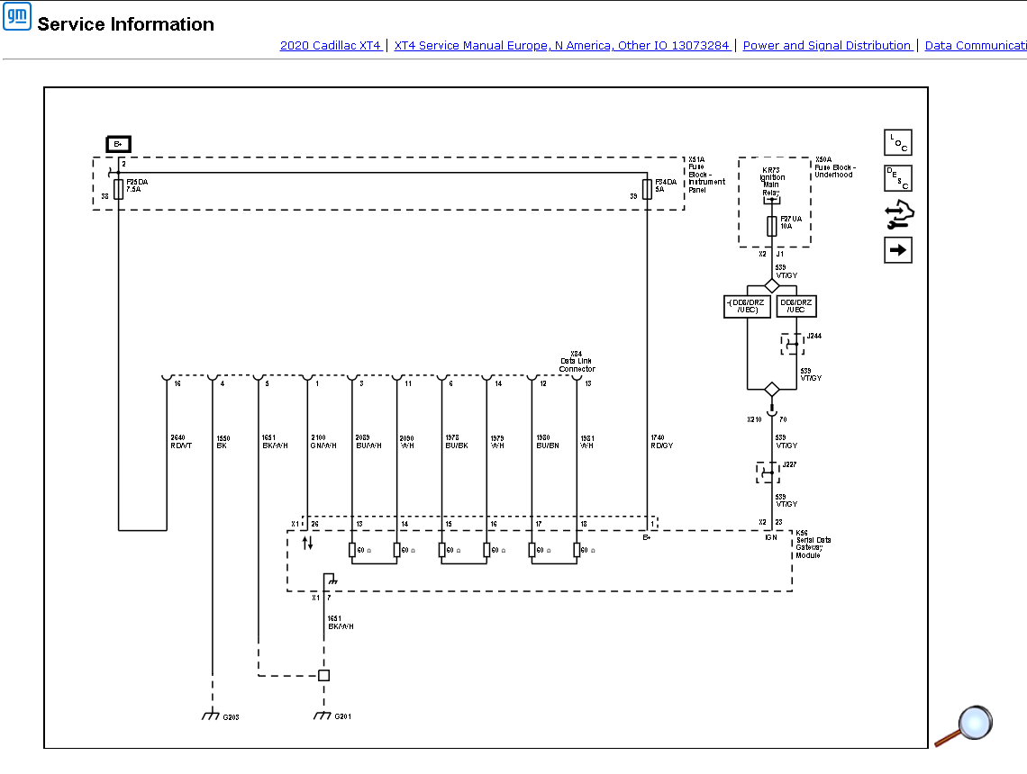

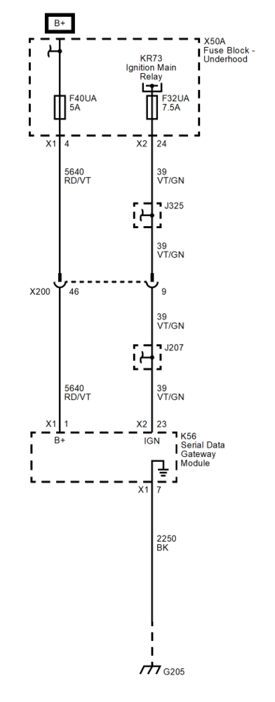

Gateway installed and wired?
To my understanding gateway is not needed for Global A units ? only for Global B units
No you need the gateway for this
Ok thx for the info , i can see there are one for global A (saw one from Insignia)and one for Global B (saw from C8 corvette) and they dont look the same, so i will need a Global A gateway when i program the HMI 3.5 Global A right? or can i use same gateway for both A and B cars? will i need a BCM also if i only want to program the HMI unit ?
