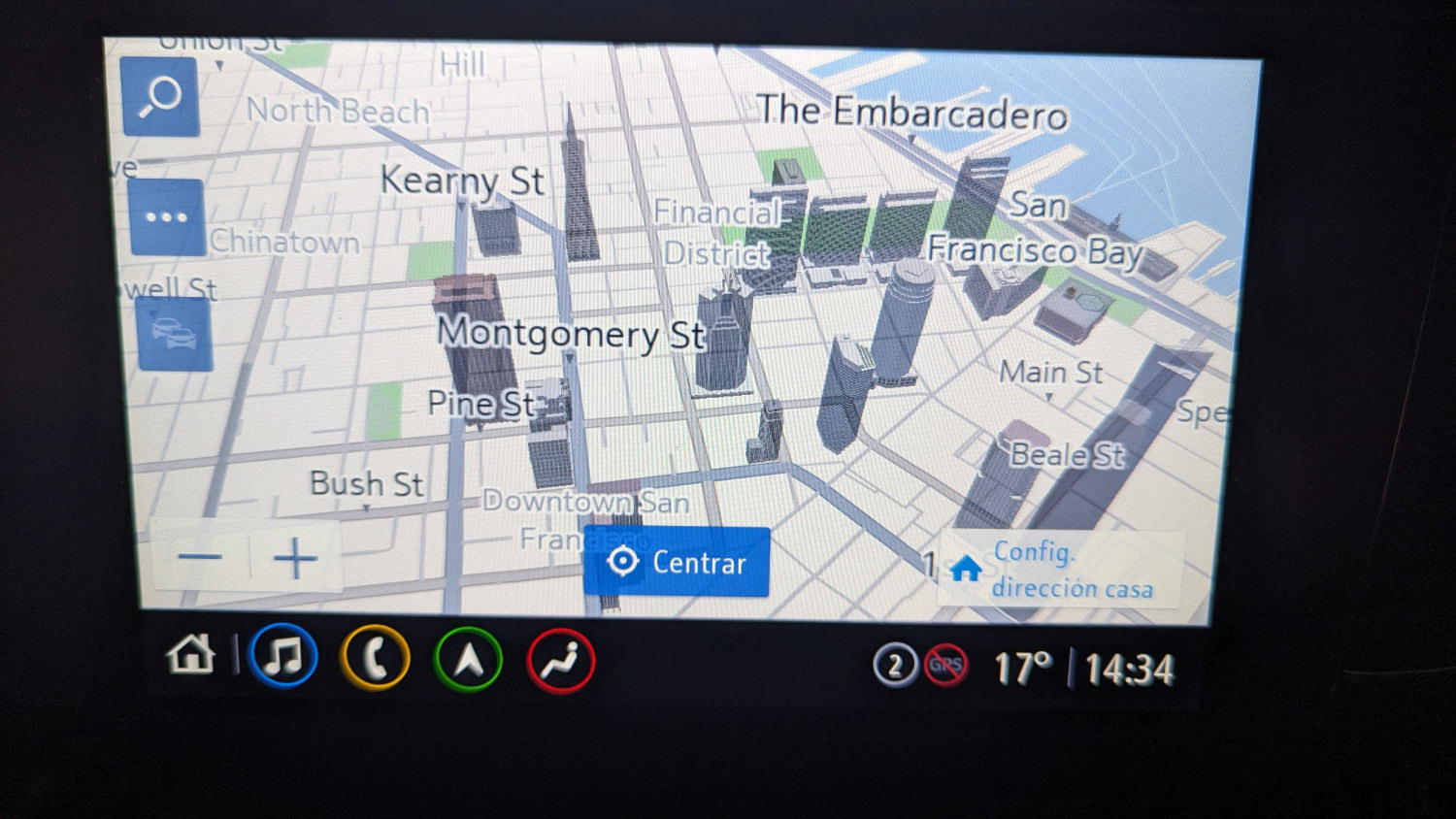

Today i received the usb receptacle with mcr slot and works ok, i have a US card, and im waiting a SD to dump the europe maps
  • 3 weeks later...
EU Maps working too. 🙂
