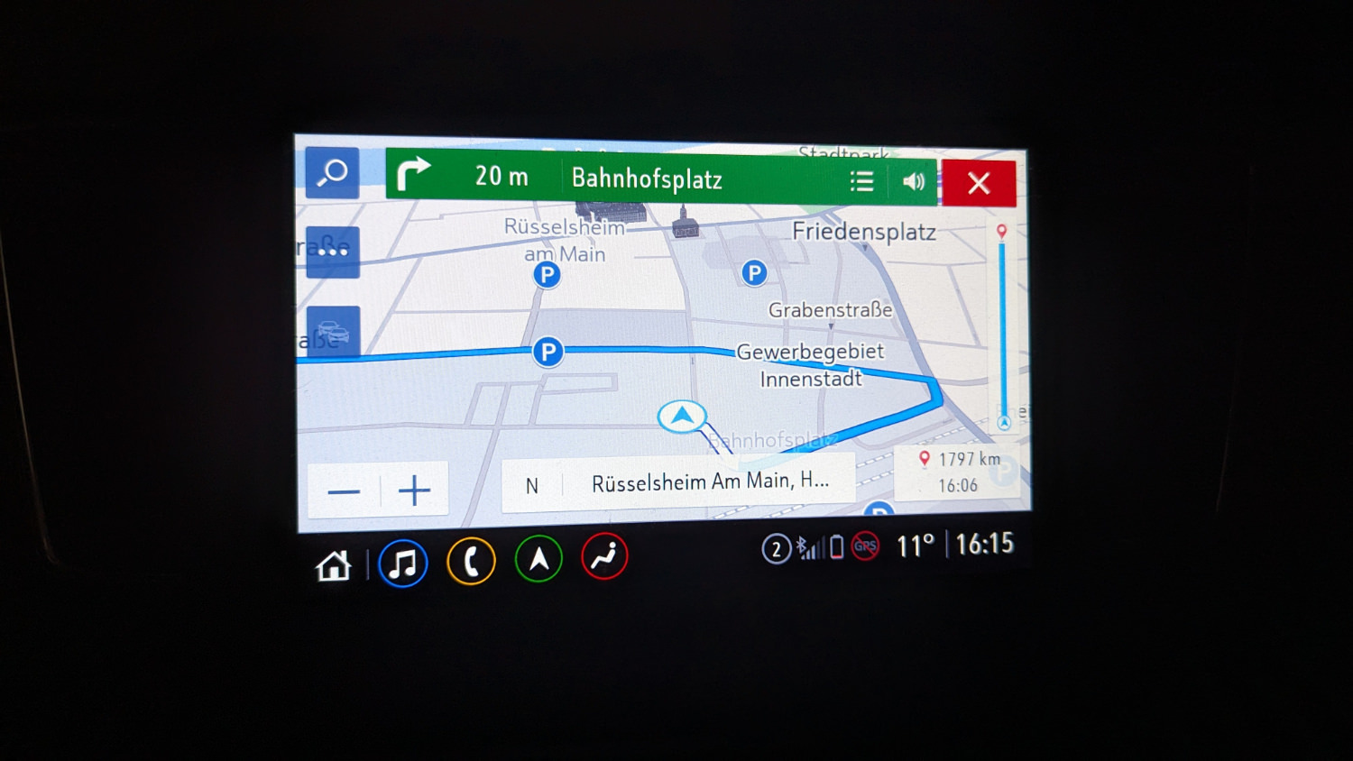

EU Maps working too. 🙂
Hello!!! Did you just copy all the content from the Euro navi to the American flash drive? I also have different Euro and Russian calibrations. I know where my favorite languages are turned on, but because of the protection, it gives an error when programming.

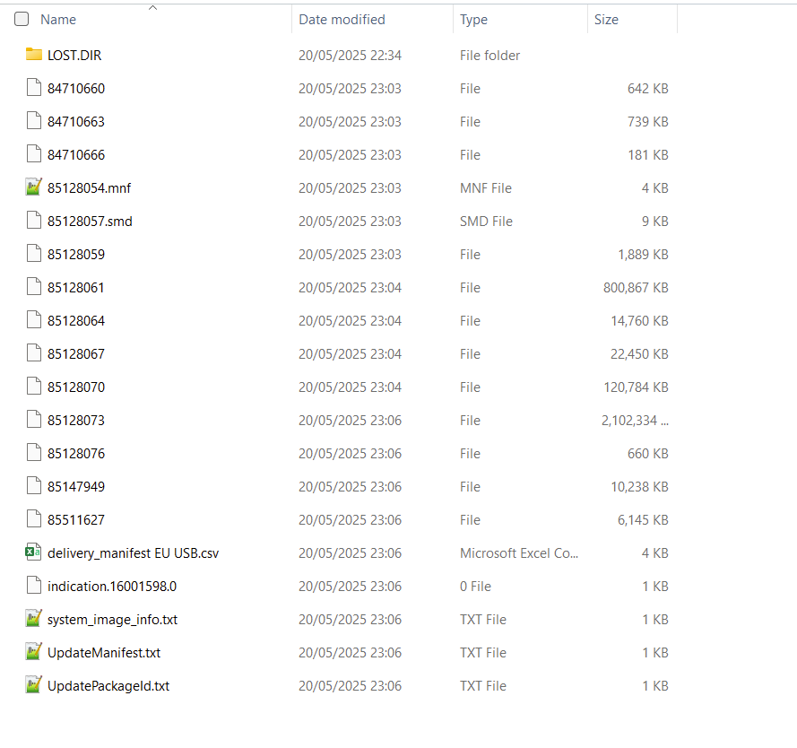

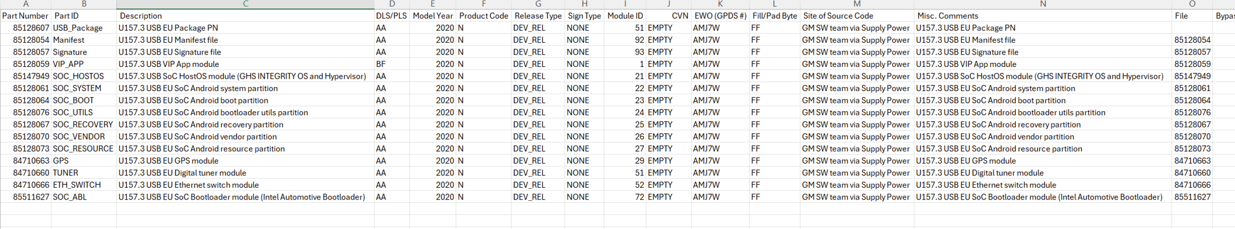

What is that for File. Make a Screenshot pleae (the Files).
and the manifest file
I repeat, this files are for a USB upgrade, this dont works as a DPS package,
extract onto an usb drive, and plug in the usb socket
Yes that is for usb firmware upgrade
