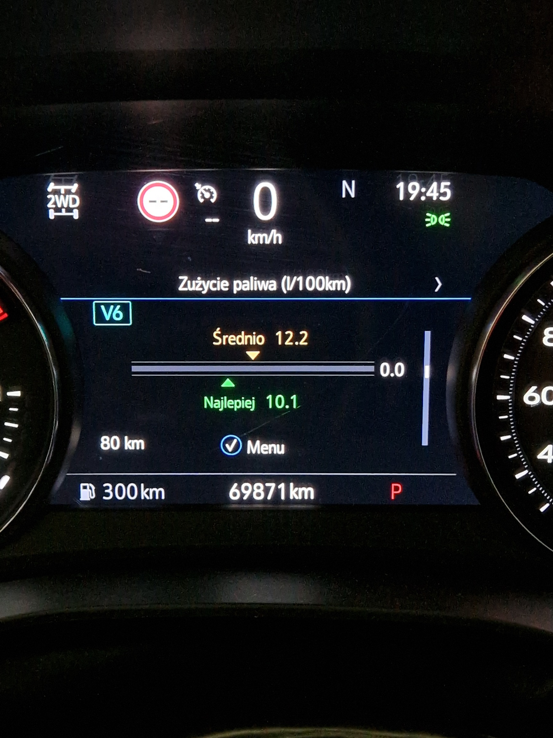

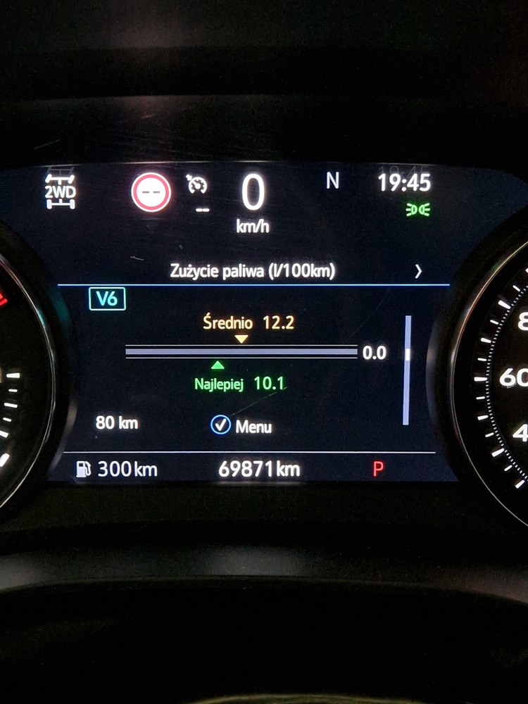

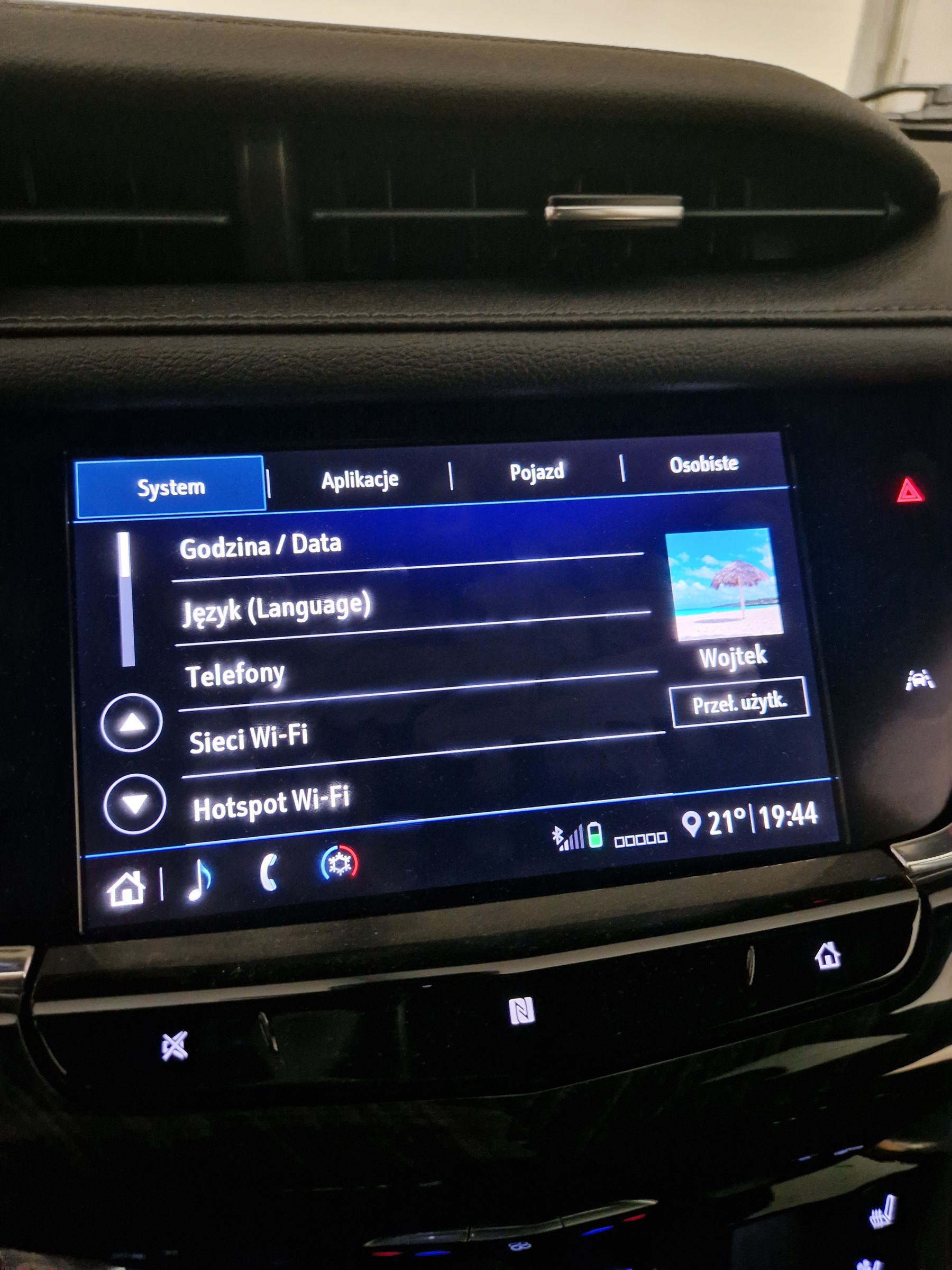

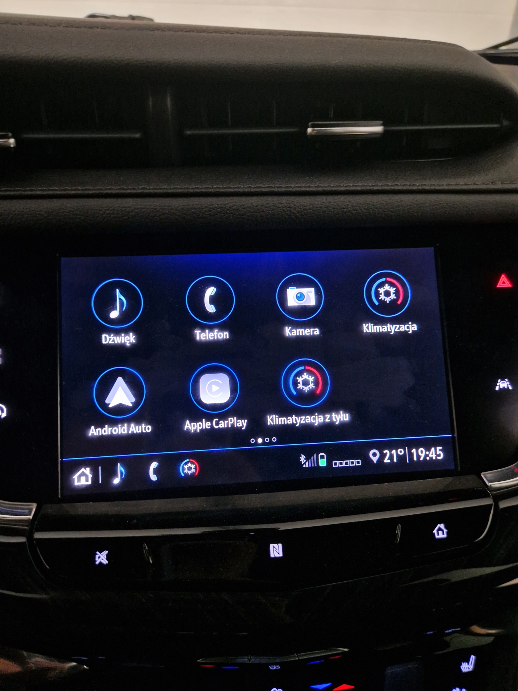

Meanwhile, I managed to recover my radio using SPS2.
Initially, it obtained calibration for my original VIN and restored the factory settings — which was good, as the radio started working as before.
Next, I programmed the EU calibration (the one that had failed before) one more time. It progressed to 95% before failing again. Then I tried SPS with an EU VIN number — luckily, SPS allowed me to use that VIN.
This time everything succeeded.
The radio worked on all frequencies, I could choose many more languages (including Polish), and everything functioned perfectly.
However, the calibration I used (with the EU VIN) had limited functionality:
  • Built-in navigation was missing (even though I had already inserted the 2024 EU maps, which work fine on the US system/software).
  • The 360° camera recorder was missing.
So, I restored the system back to the US version using the same method.
I programmed the calibrations from backup (which still failed at 95%), then used SPS to fix those calibrations — and now the radio is fully restored to the US version.

When it failed at 95%, the language switched to Russian, but the Cue screen became locked with a message saying something like, "Calibration required for more devices."
After that, I purchased an SPS license. Using a foreign EU VIN, I was able to reprogram the radio, and everything started working — including the frequencies and languages.
However, some options were still missing, such as navigation and the 360° video recorder (though the 360° cameras themselves were present). I could live without navigation since I have Android Auto, but the 360° video recorder is a must-have for me.
So, I decided to roll back to the OEM calibrations.
Next, we will try to obtain and load calibrations from another EU model — this time with the Platinum package.
And yes, the OS was different so maybe that's why...

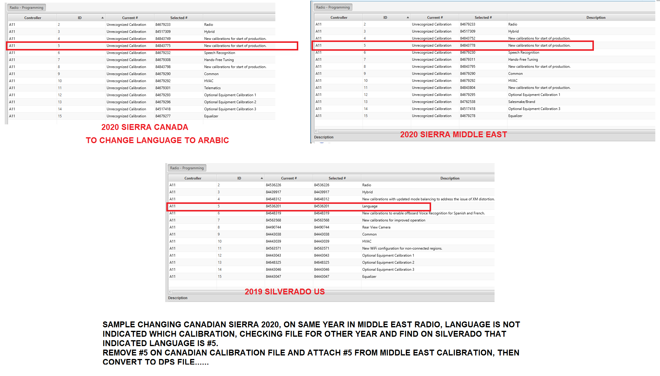

if you have the calibraton of two compared vin,, it can swap only calibration you want to change without affecting other calibration,, sample calibration no.4, just replace only no.4, others intact.
How do I know which calibration is responsible for what?
For example frequencies?
Sorry for silly question but I'm quite new to this subject.
The calibrations change a lof of things
In the number 5, you have the languages, AM-fm step, wireless carplay...
If you uncompress 2 times the calibrations, you can see the plain text configuration
Languages goes defined in this ID:
_X7ucgDisEeaLbPZ4FkO9uQ

SCREENSHOTS DURING PROGRAMMING FOR DETAILS
That's make sense to me now.
Thank you very much!
