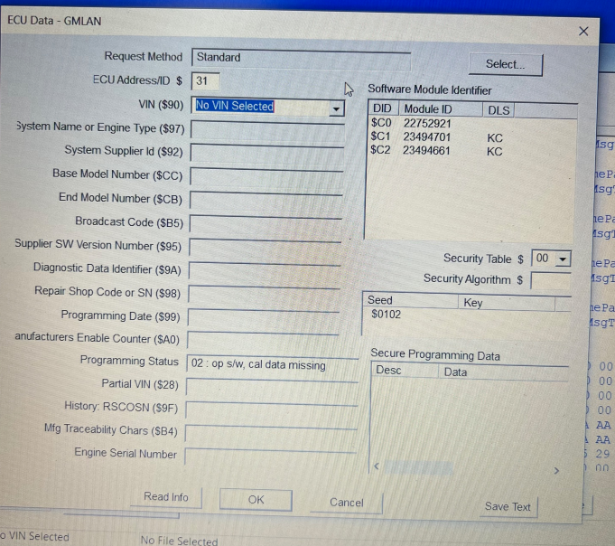

After trying to update the Electronic Power Steering via SPS2, I lost the power steering on the car, GDS don’t find the module but DPS find it and there is no VIN programmed anymore in it. In the Programming status field it's not “fully programmed”, it's wrote
02 : op s/w, cal data missing

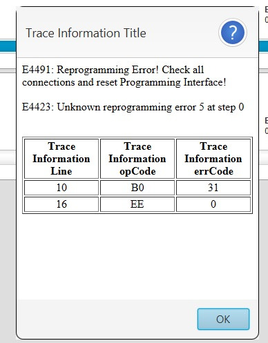

Then I program it, during the programming there was an error occured at 47%.
Do I miss something or the order that i put the files in archive is wrong ?

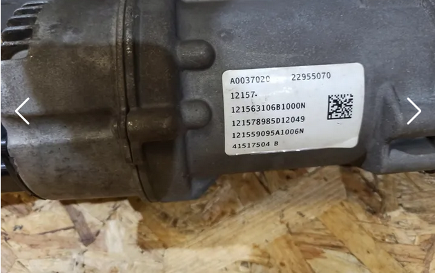

Can I have part number for EPS
Complete steering rack with module part number : 22945594
A picture follow with the label on the module
These part numbers don’t match SPS

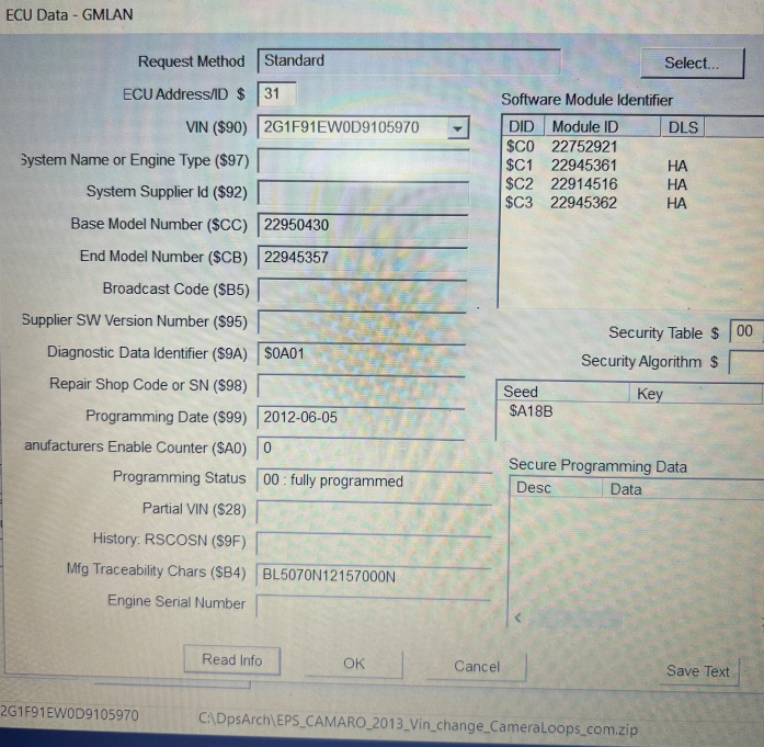

It looks like they're trying to upload the totally wrong calibrations!  The before DPS shows 22752921 as the main module ID, I do see that in your option list so I'm guessing that's the one they're supposed to be loading.  This other one has a totally different OS and I can see it's rejecting it as it's failing right after uploading the OS.  I'd bet the 22752921 will go :), assuming the module wasn't swapped out entirely.

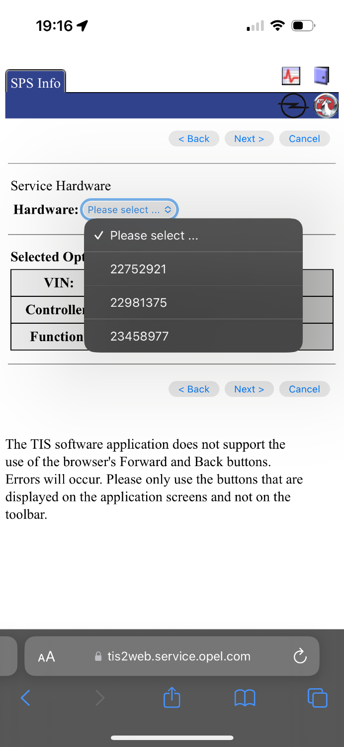

No, no, no. Option menu is what hardware number suppose to be installed in car. U know SPS check for correct part numbers. Some times they allow to cross use different, but module can refuse in mid programming and die.
I give you the part number of the article (when you want to order the mechanical part)  not the hardware module, normally SPS2 choose automatically the correct file from the vin of the car ?
You can try all three part number that you show, no one is a part number to order the mechanical part... So i just check with DPS before the reflash and it was 22752921 stored in the module , so I think it's the part number that you need ?

Interesting, mine (techline though) doesn't always match :).  But regardless, Charly LSG, has this been changed.....?  That DPS before, is that from that exact module or did you change it?  I'm guessing it is the original.  Your module ID matches what it was before, the one you're trying to upload is going to fail.  For fun, try the 22752921 cals, it's pretty hard to brick these things.  It's already dead now anyways and needs a proper cal.

That's what I thought.  You're pulling the part number of the entire assembly, not the module itself.  You need the proper cals, I would try 22752921 and see what happens.  Your screenshots show that as C0, the module ID.  🙂
I tried 22752921 and that's the actual issue result... I guess perhaps another part number will work ...

You've tried 22752921 (did it let you pick) and is that the DPS files you put here earlier?  SPS2 usually will try to query C0 on some parts (BootSoftwarePartNumber) which was 22752921 in your before, it should have used that unless it gave you a pick list.  I'm actually surprised you're having issues through SPS2 as it should have given you the right ones.  It definitely did not like that OS as it failed it right after.
SPS2 choose automatically I have no choice and the DPS pics was before the reflash (actual state from factory, I always take a pic before reflash ...)
