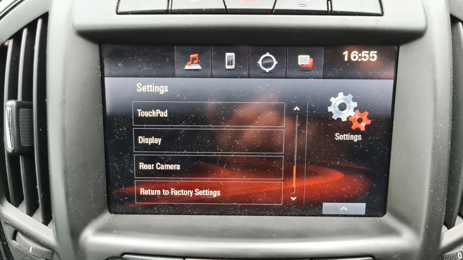

  • Well, the calibration 7, enables the touchpad in HMI 2.5. i dont know if the calibration 3 is relevant to enable the phisicaly touchpad. i need do more tests

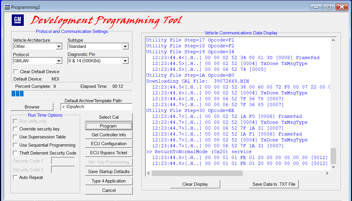

I thought I'd join on here as I was trying to enable touchpad KOT on my HMI 2.5, I've done the check sum although for some reasons I kept getting the programming error in DPS. I am not too sure if I've done checksum correctly (Double checked and result is same)
I've also attached a file of no 7 cal in case anyone want to verify it.
Thanks!
39072669.bin
Thanks!
39072669.bin 317 B · 2 downloads
the checksum is 83 d7
Try this:
39072669.bin
@Arbe_gtc was faster 😁
Thank you you both @Arbe_gtc & @Robi_XIt works fine.
If it was checksum issue, I don't know what I did to get it wrong as I was following the checksum instruction in this website.
For HMI are little-endian and in the result you need add +1 and swap the result
I assume it is little-endian 16-bit values? I seems to get a different result on it somehow.
in HMI little-16 yes
  • 7 months later...
I corrected calibration No. 7 according to the instructions, I’ll try to download it this weekend
Thanks, it worked with HMI 2.5.
