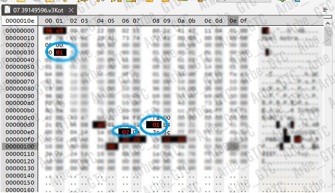

Well, the calibration 7, enables the touchpad in HMI 2.5. i dont know if the calibration 3 is relevant to enable the phisicaly touchpad. i need do more tests

the calibrations of the HMI 2 and 2.5 are different
in your calibration edit this bytes with this values and correct checksum

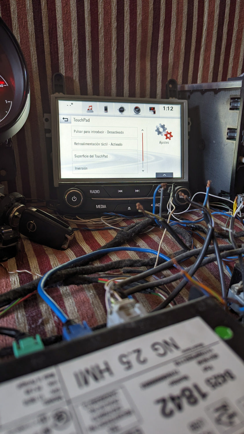

i buyed a touchpad from Insignia A to check if it works in 2.5 ... should work. but im waiting the delivery
@Arbe_gtc it work, but for me is useless function. Mine stay disabled
nice!

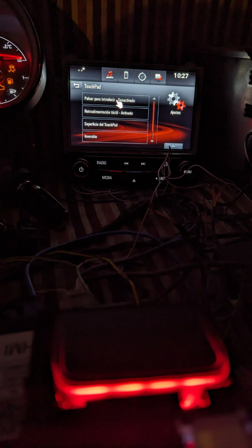

Well, i tested today the touchpad and it works in 2.5, but is strange haha
Is not what u expect to be like mouse. And is more likely scroll and jump between icons. That I say is useless function for me

Cal number 07, Brand

I wrote a little app to edit the files. You can also do manually without a app.
