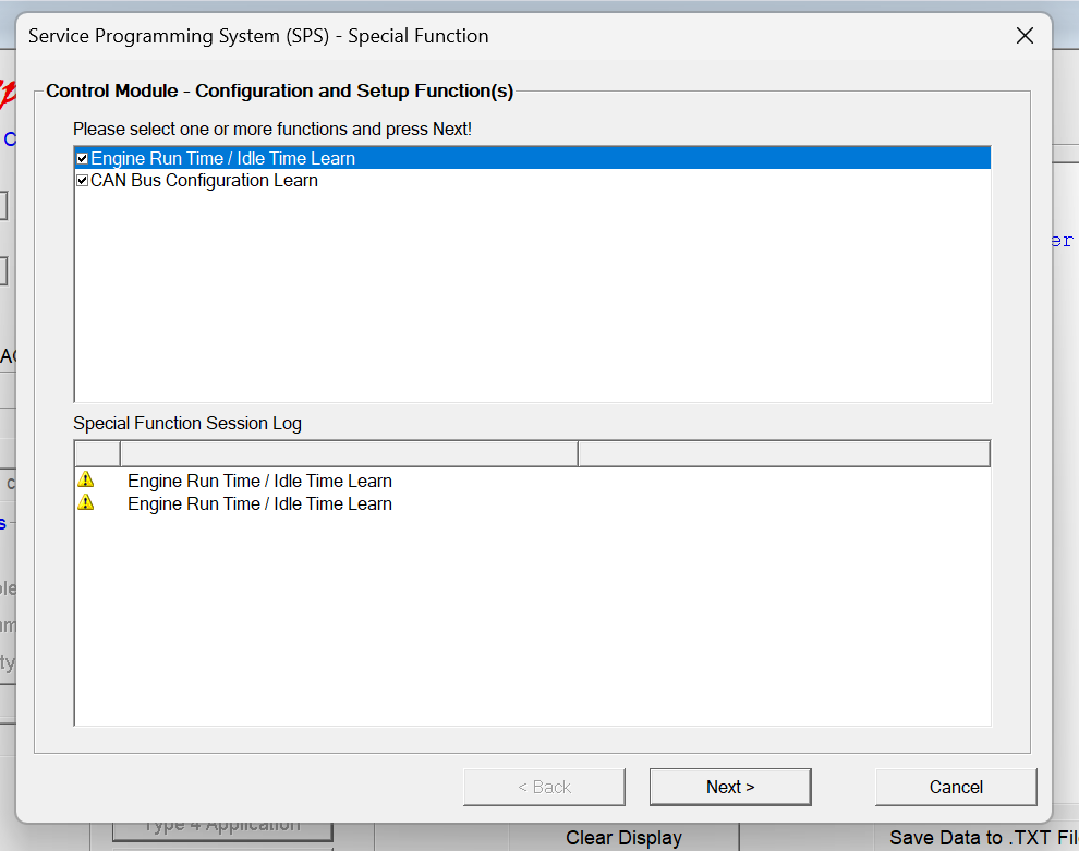

I am trying to create a type4 file to correct mileage on 2019 Escalade. I followed the guide for creating Type4 but still running into issues. This is the SPS Log:

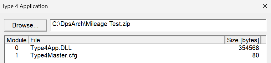

I tried creating the Type4 with the first 6 files only. This caused DPS to error out saying missing type4app.dll. I then tried to create a Type4 with only the Type4App.dll and Type4app.cfg:
Nothing happens when I click next except for the special function log updating. The Type4 app opens as it did in SPS though:
I then tried to create a new archive with the DLL, CFG, and the 6 files from above in one Archive. The Type4 app opens, but is entirely blank.

If you've build and run a Type4App you have attached a screenshot from (above), then you have done it correctly.
