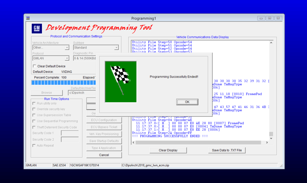

    program ecm was not in type 4, get controller info, select 11 ecu id, select calibration, find your archieve , program
  • Thank you. This actually worked. I just programmed it regularly (not type 4) and it went through fine. Why did I think this was a type4 in the first place. Oh well.

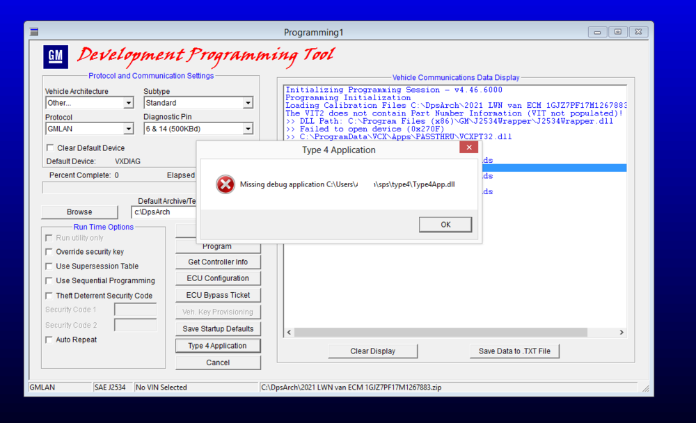

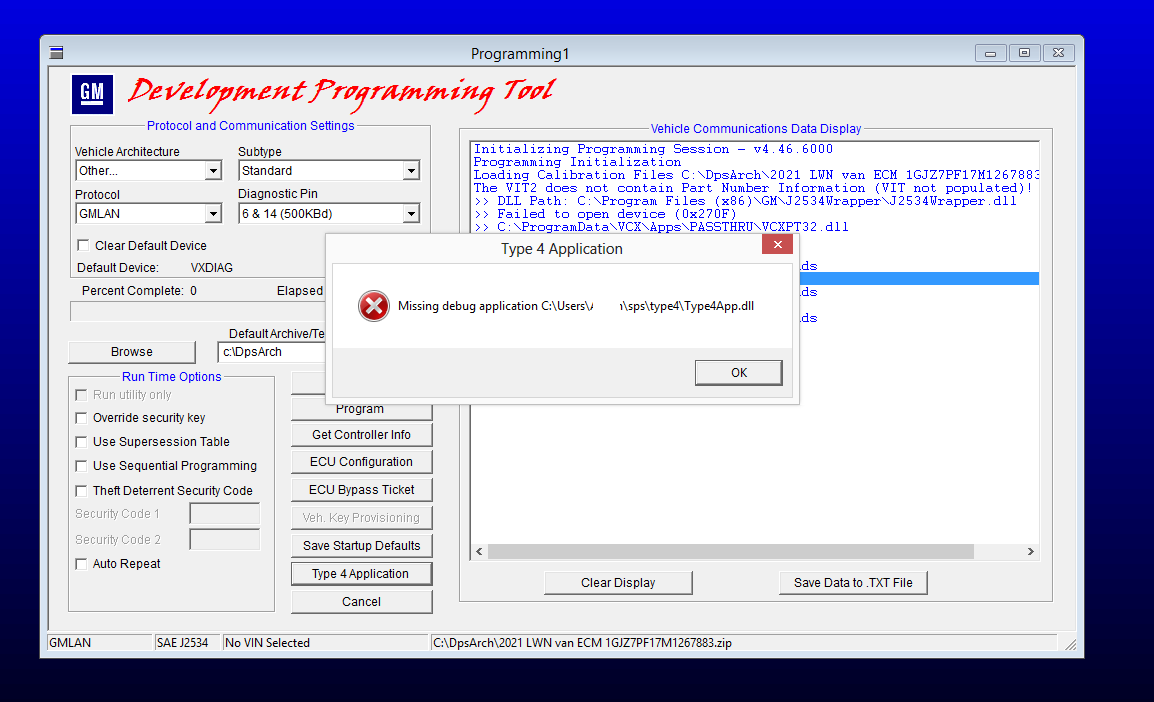

Can someone please share this file. Somehow I don't have it in that folder, although all the spsCache files got downloaded.
Thanks!

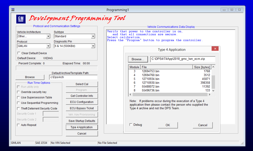

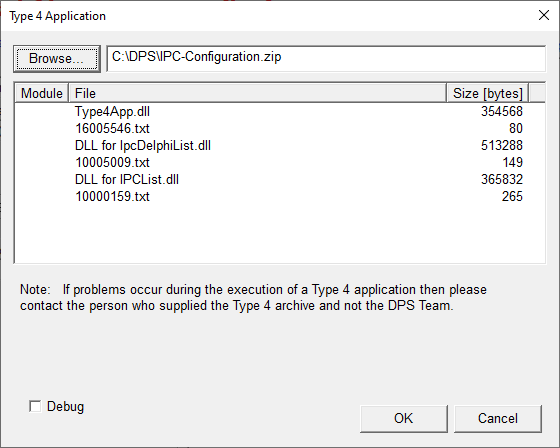

I don't have that either. Typically when I see that error, it's something wrong with the Type 4 app. Did you build the Type 4 zip yourself?

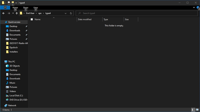

Before running the T4 app:
At this point, the folder will still be empty:

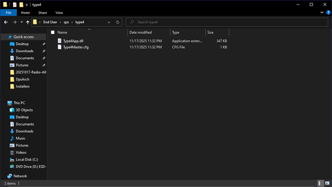

Once you actually run the app, it will extract what it uses throughout the process:
As you can see, the files are here now:
So from what I'm seeing, your T4 App might be broken. Can you show an image of the file list like I did?

Admittedly I do not know what I am doing, but this is what I done.
I am trying to reprogram the ECM on a 2019 Express van 2.8.

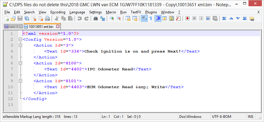

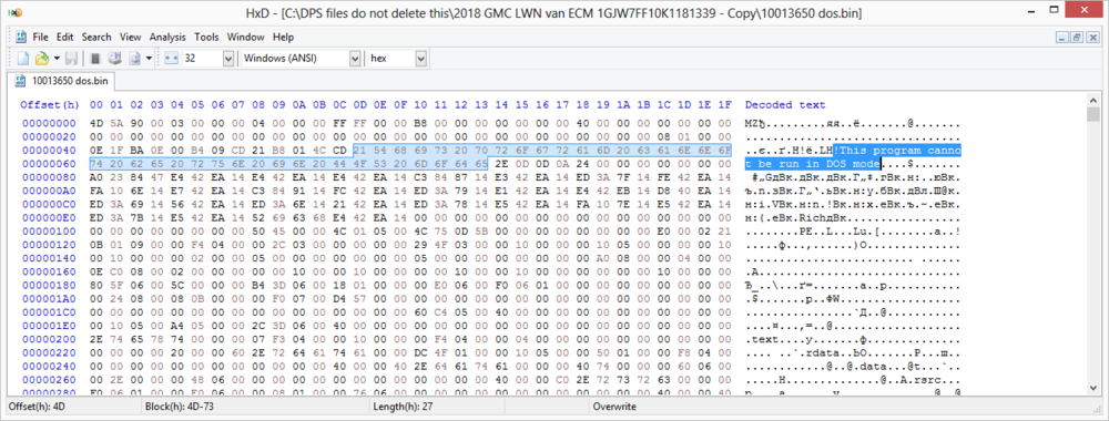

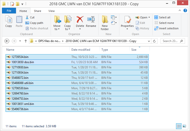

1) Unzipped 11 files that got put in spsCache. From those 11 files, 8 are bin files that match the SPS CALID website, 1 is a XML, 1 utility file and 1 unknown, but when looked at with a hex editor it contains "This program cannot be run in DOS mode".
The 8 bin files do not have the number in the 4th byte as usual, instead they all begin with "FF FF FF FF 00 00 00".

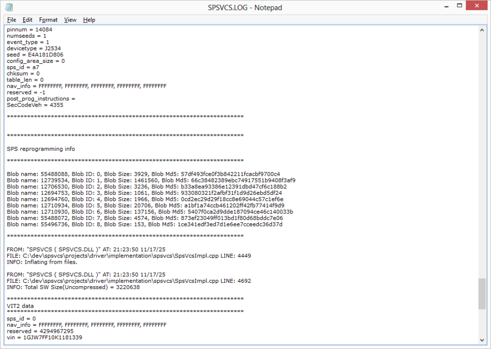

2) So I opened SPSVCS.log and in there found how to build the DPS archive, however it only uses the utility and 8 bin files.
3) Built the archive and now get this type4app.dll error.
So I clearly did something wrong, and missed a step or more. I do not know where and how to use the XML and the unknown file.
