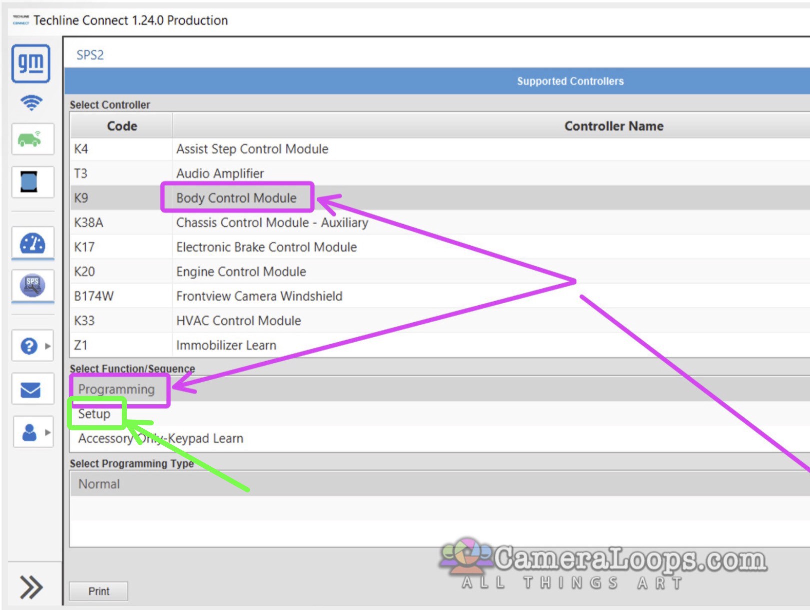

Hi, have you tried recalibrating the ebcm via GM SPS service under setup and configuration then erase the dtc via GDS2?

Not program calibration files. SPS Setup and configuration.
Select: Setup
yes I tried but during setup and configuration there is a loss of connection with ebcm
Select: Setup
