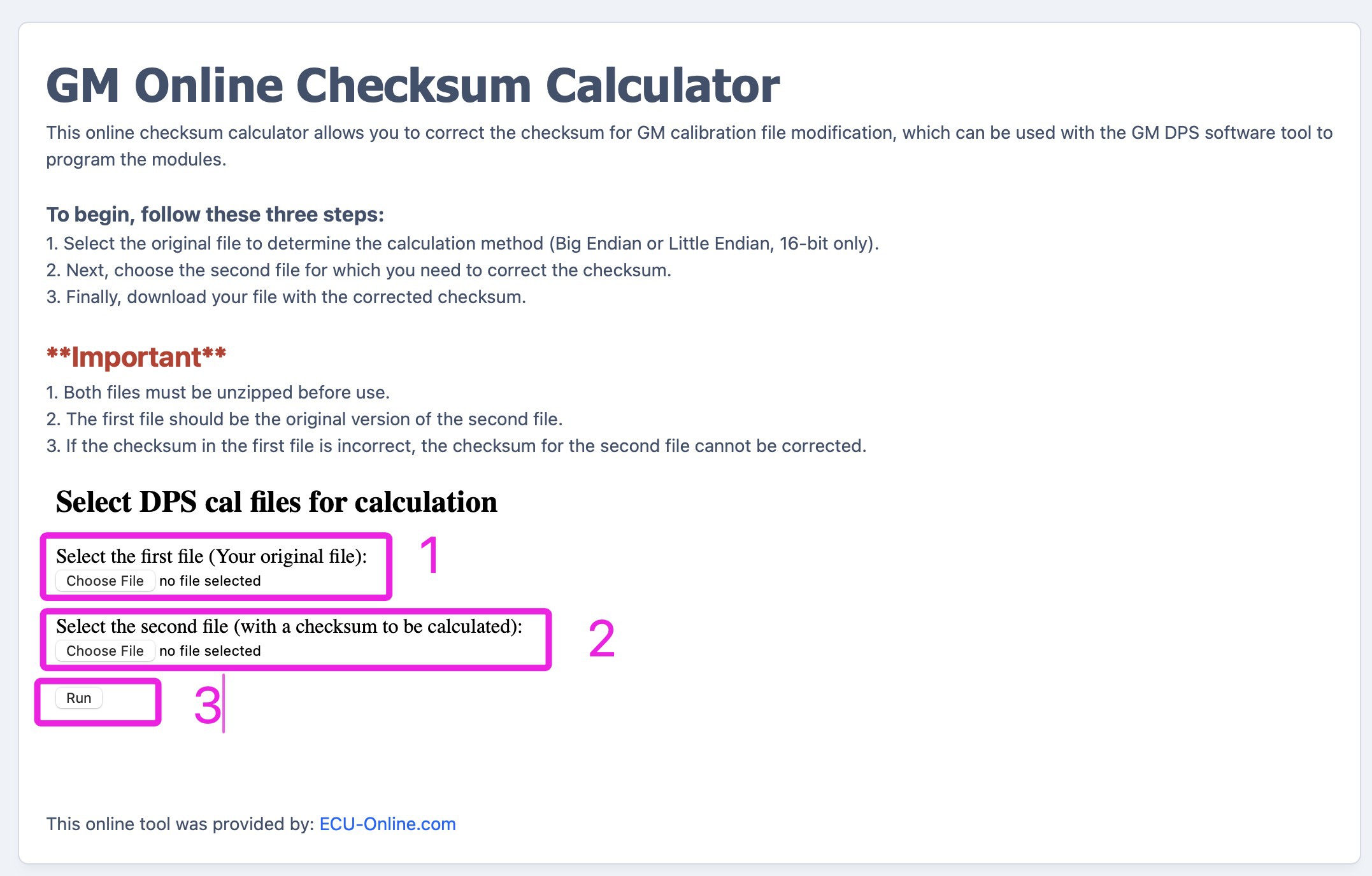

Guys, tell me how the online checksum calculator works
Which file should I upload there
I don't understand something
https://www.cameraloops.ru/gm-dps-calc/
  1. Choose the unedited calibration file.
  2. Choose the edited calibration file.
  3. Click Run.
