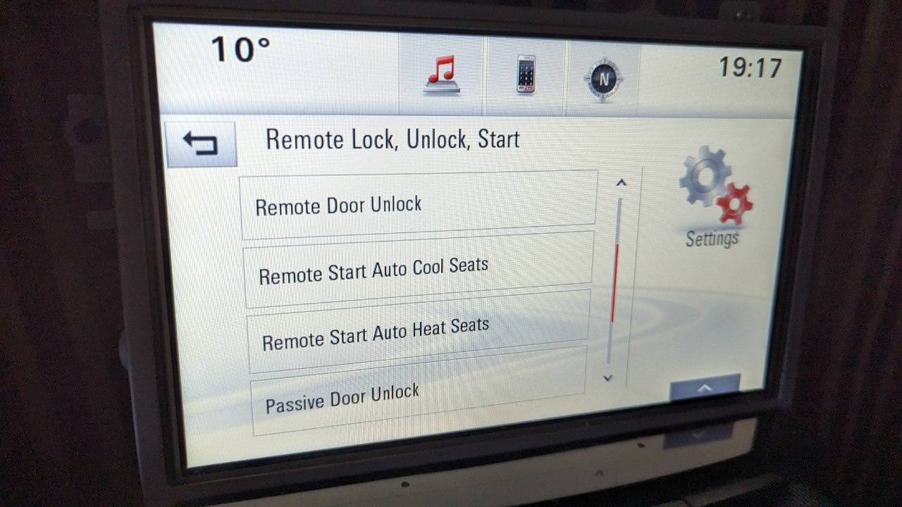

One thing to understand, Your car shows also "Auto Cooled Seats" in climate Settings or  just  "Remote Start Auto Cool Seate" in Remote.... Settings?

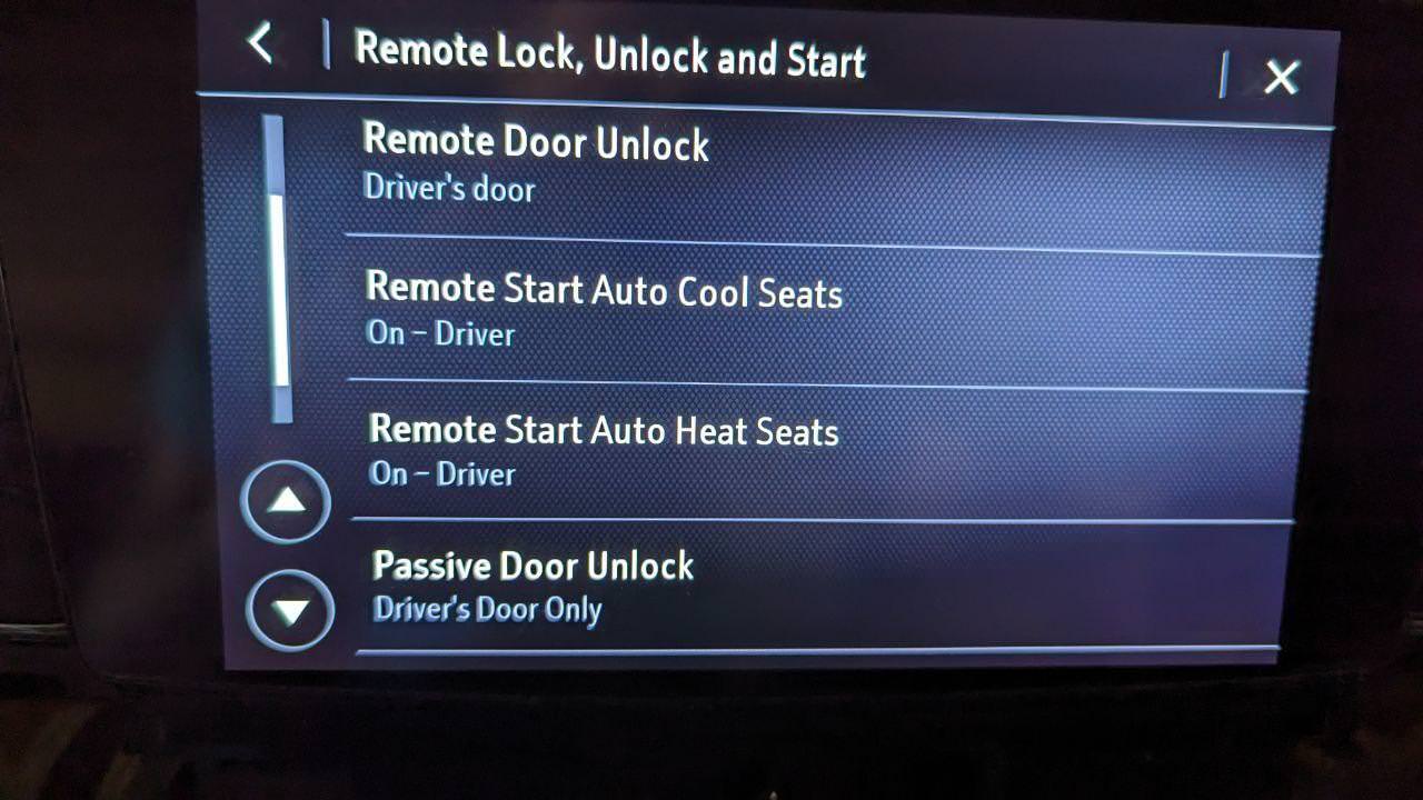

It's in #5, there's actually a bunch of cool things you can do in there.  It says Auto Cooled Seats but it's under the Remote Start configuration.  You can hide/show heat or cool with remote start too (can't remember where the heat flag is off the top of my head though).

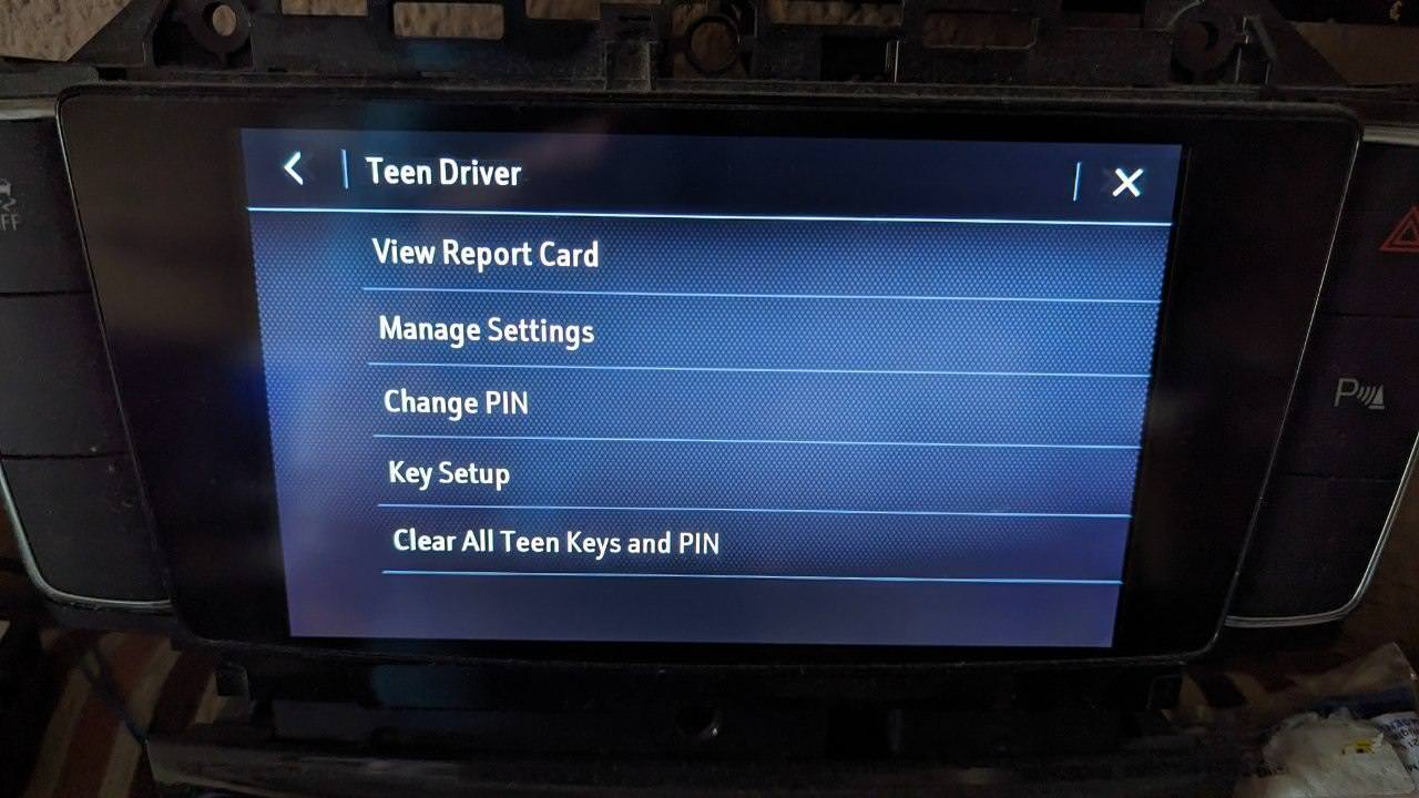

I have to try the BCM calibrations of the 2019 Malibu, because they are very similar to the 2019 Astra K, to see if any new options appear in the HMI menu
BCM calibrations alters the radio menus, yes
Did you activate Teen driver or was this one already active?

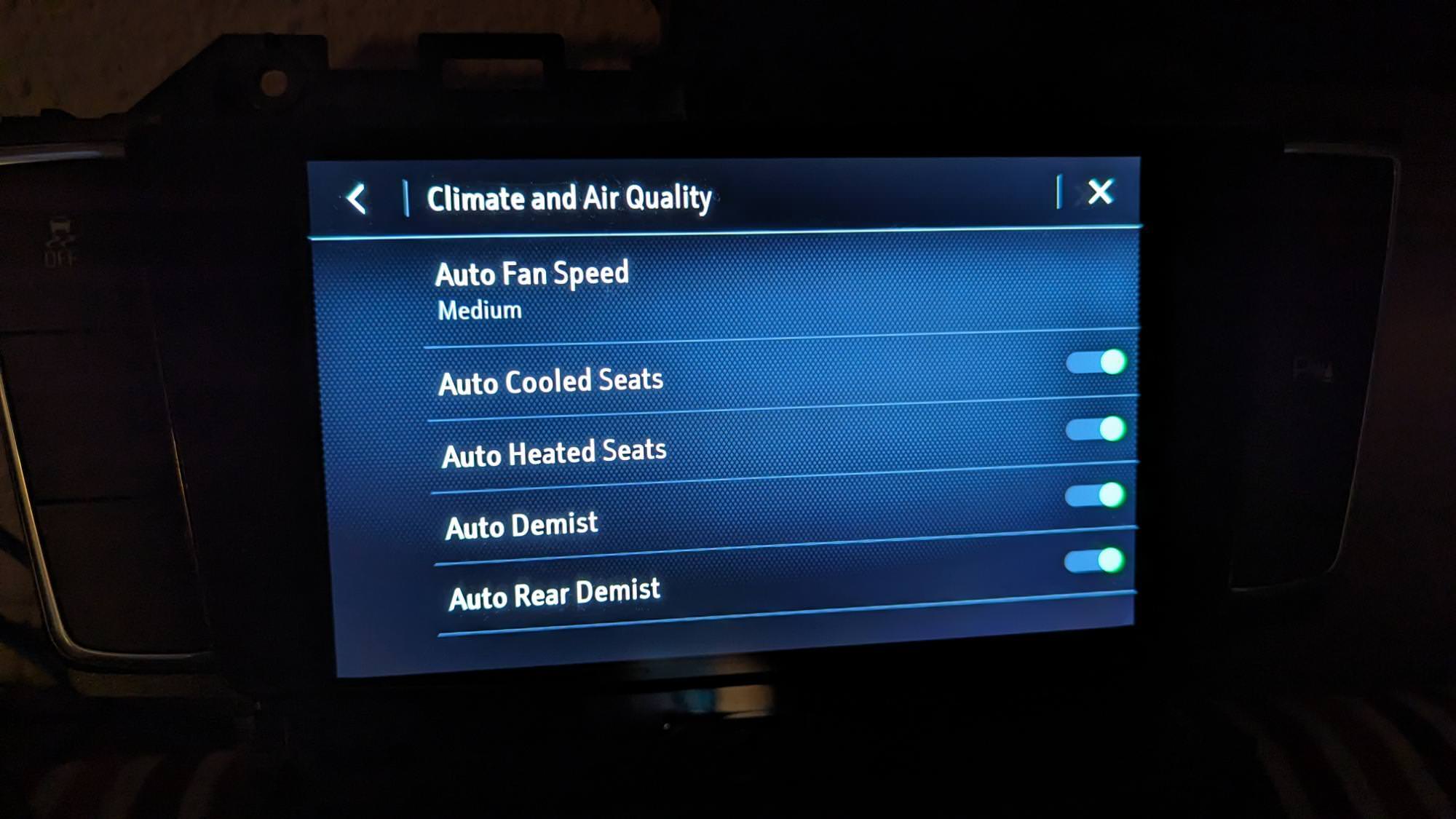

Teen driver has activated after load malibu calibrations, same as auto cool and auto heat

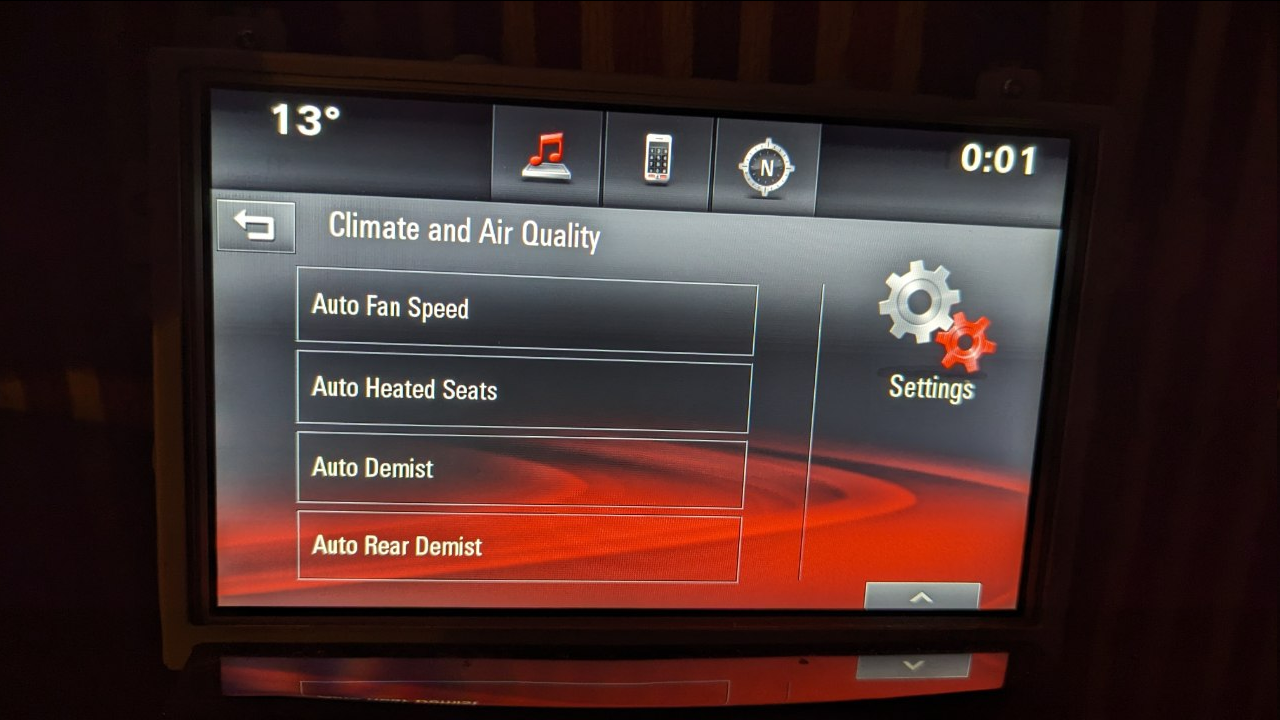

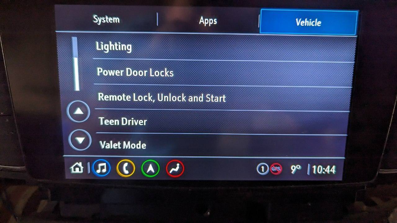

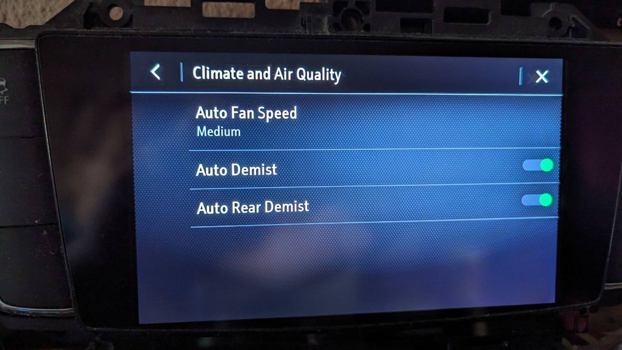

Maybe i misunderstood something but is the auto feature only in "Remote Lock, Unlock, Start" or also in "Climate and Air Quality"?
Because Remote Start is not an Options in my Car (Manual Transmission).
i think auto heated seats option inside the Climate and air quality menu, are dependent of the HVAC calibrations..

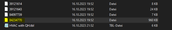

I have the HVAC Cal one Stock and the other with Quickheat
HVAC with QH.zipHVAC without QH Org.zip
Dont know if it helps🤔
Loaded Envision 2018 calibrations in my 2019 astra K module (uses the same number module 84295139) image.png.1584b0bbf8c18c5852387f5aeecb5a49.png
Check if your calibration 01 is this: 84234770
Yes, Cal 01 is 84234770.
i sent you the hvac cals. the option i think is in the number 03. but have a lot of differences... try to create a package only changing the number 03 and test it

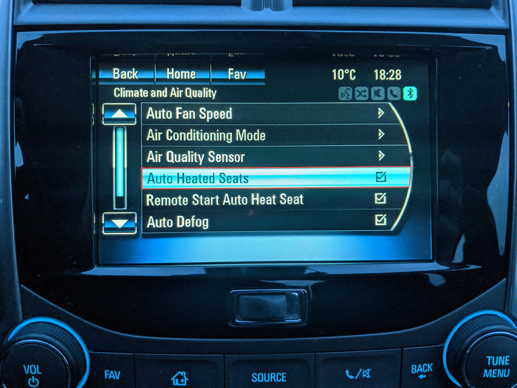

In my case, I've found them in HVAC Calibration 03 (HW: 13591958, OS: 13594173) by compare with 2014 chevrolet volt (&KA1) and (-KA1)
but activating 'Auto heated seats' option seems not for rear heated seats (&KA6). works only on front heated seats (&KA1).
offset: 0x48FD, 0x4927 (seems for climate control in mylink screen), 0x492E (seems for climate control in mylink screen)
ref: malibu_2014_C68_LBS_AKX_LHD_C32.zip
I can see similar pattern in 39121643, too. try locate pattern like: FF 12 13 14 FF. I found them around 0x48F9~494A.

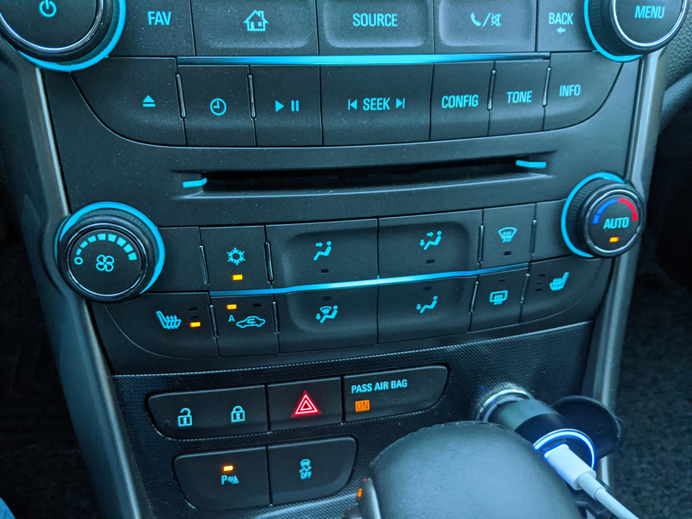

8th gen malibu (2012~2015) in korea have no passenger presence sensor and seat belt reminder for all passengers (only for driver). and nobody seated on the passenger seat.
both front heated seats turned on right after engine start.
but passenger heated seat turned off after 10 seconds with DTC. (passenger heated seat malfunction - high resistance) it also turned off automatically when I turned on the passenger seat manually)
I think I should replace heated seat pad in the passenger seat. 😞
