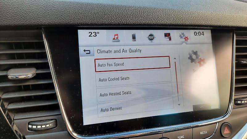

So i got Auto Cooled Seats now working on 2016 Cal's.
But not sure if it works because of current outside Temps.

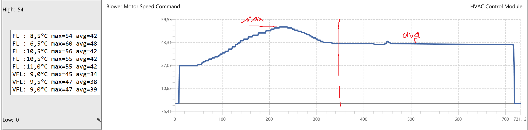

So i need some help.
Dose someone drive a 2020 up Model Astra K(CJ2) and Drive in a Region with current temp's from 8 -11°C?
After some Testing i found that the Blower Motor works harder/stronger with the FL Software on 2016 Hardware.
Now i need to know if its general(normal) that the 2020 models have a other fan curve or the Hack Software dose some wired things.
GDS2 data Log is needed.
Settings:
-All Auto
-Inside Temp 22°C
-Blower Motor setting set to Medium
-Auto Demist setting On

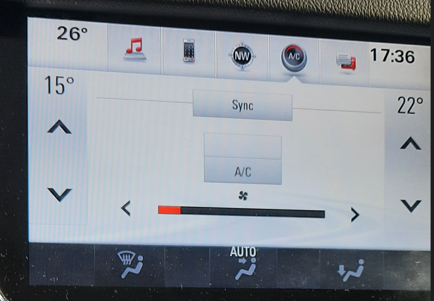

Heten, I'll test these files in my car. I have a modified HVAC with a climate menu, even one more function than in the picture, but I don't have the seat functions. I'll check the AGR settings myself because they weren't standard.

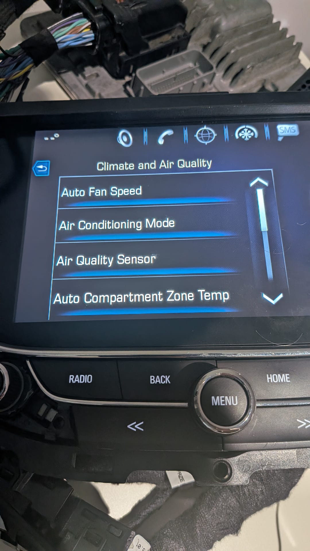

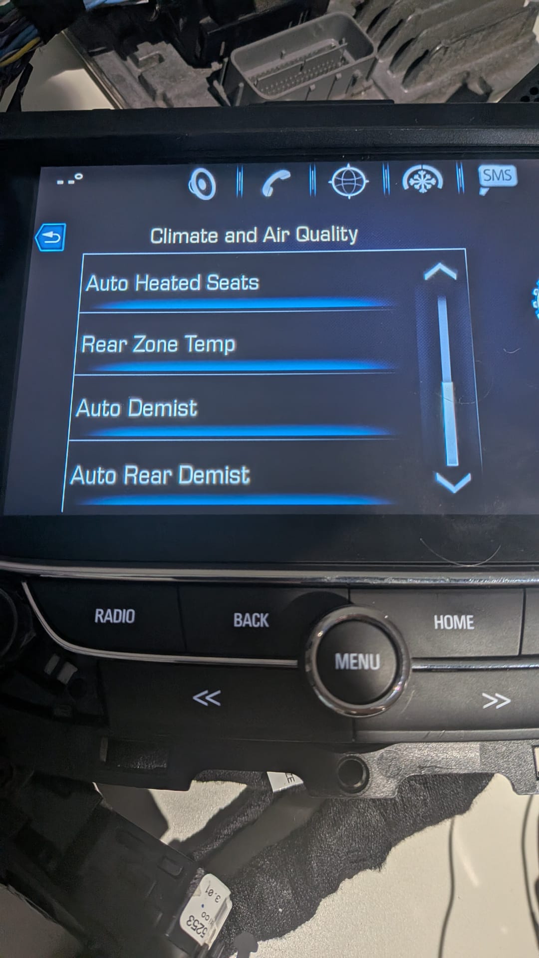

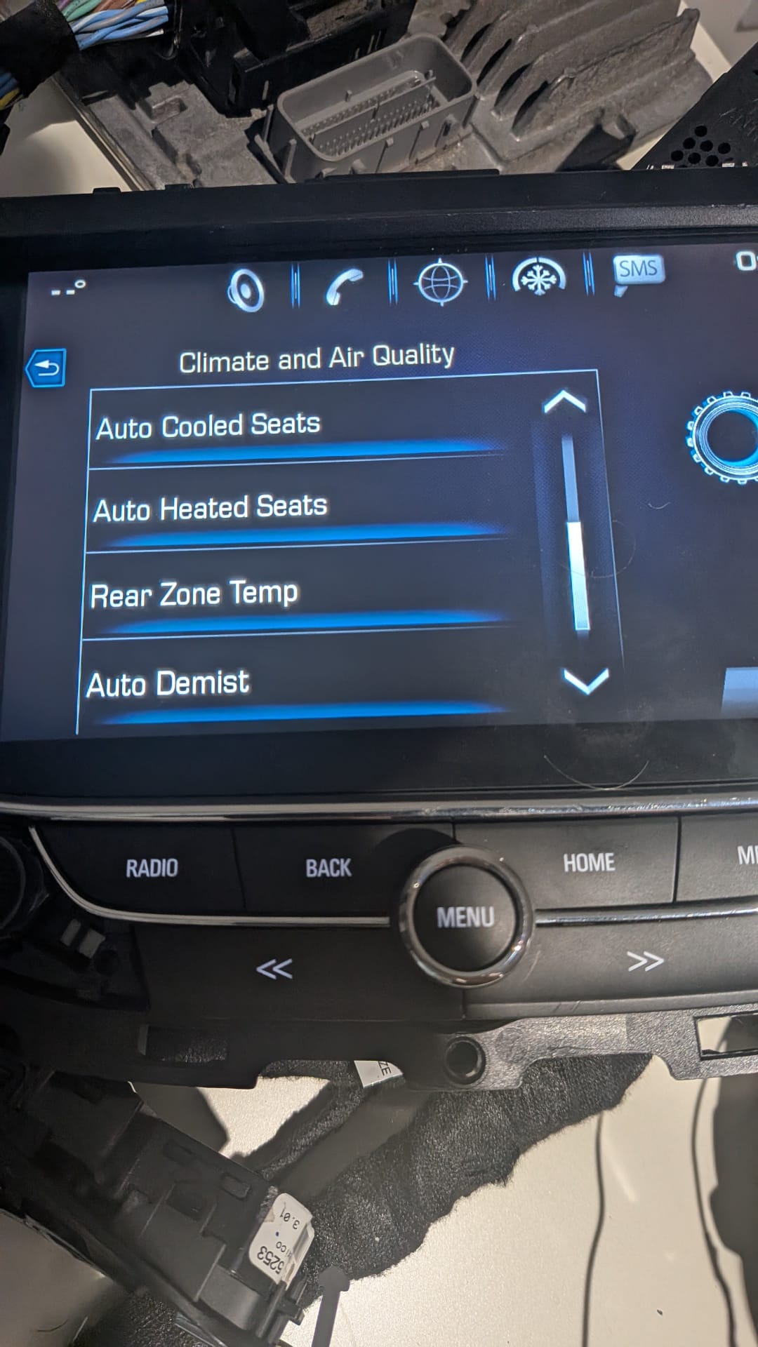

After many weeks of struggling, I managed to turn on all the functions. I probably had them before, but I couldn't get to the "Car" position on the dashboard and couldn't see them, or one of the heated windows and mirrors buttons was malfunctioning. Now it's time to test them in the car. Thank you to everyone who suggested something, guided me, or got me thinking differently.
