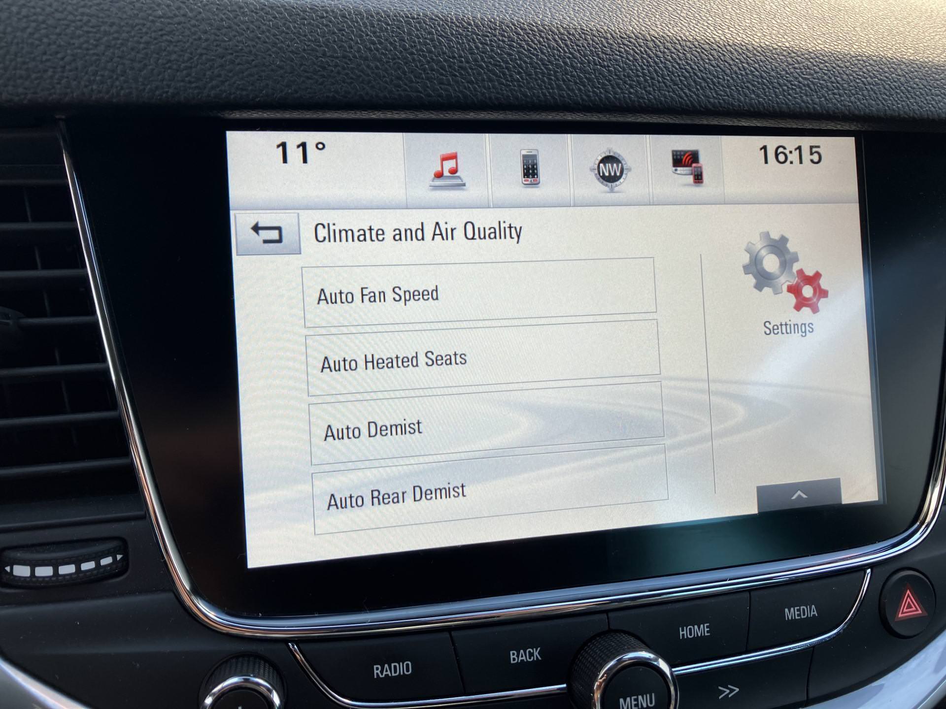

My 2016 Astra K has Heated and Cooled Seats but
three is only the options for "Auto Heated Seats"
Is it possible to aktivate  "Auto Cooled Seats" Setting like on GMC 2018 Terrain / CADILLAC?

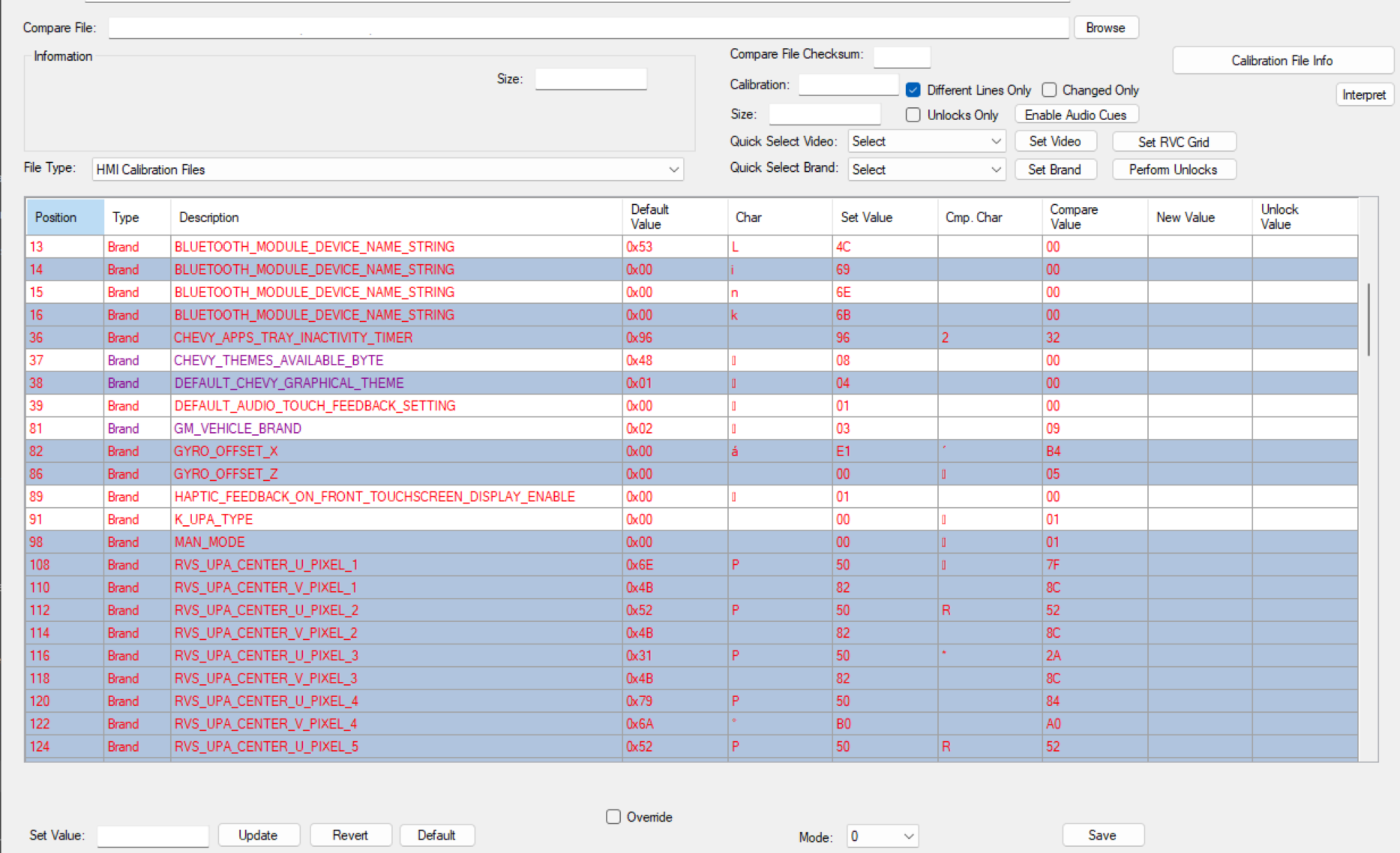

I can look later and see if I can find the option, it might be in the BCM though….  But you can try my HMI config if you like and see if it shows?

I'll get you my HMI calibration, if it's in there, we can narrow it down and find which flag it is then build you a proper one.  Do you have your stock HMI calibrations already?

Oh perfect!  I just wanted to make sure you could revert back.  Let me package you up mine that I have in right now and see if the auto cooled seats shows up.
Vette-Cold-Seats-Test.zip
Here you go, this is my current config.  I'll also do a compare on your file shortly.

Nothing super obvious standing out but let me know if it shows up.  It might be a settings mask.

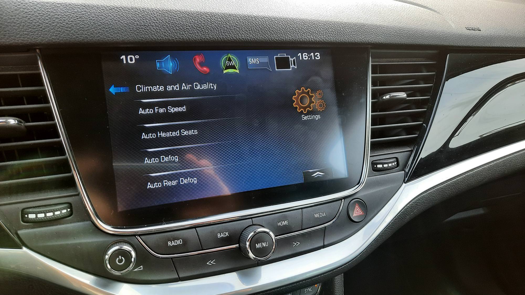

3 hours ago, Robi_X said:

I've checked it's an option in the BCM for the option to show.  Do you have your BCM files?  I'll see if I can locate the flag and hopefully ours are the same.
I only have the Stock BCM file not the current unfortunately.

Yeah, there's a flag to show the option in the HMI.  I had forgot that I added it to mine 🙂 lol.

I’ve found the calibration it’s in.  Just finding the parameter.

Ok so I’ve found the flag.  I saw your message about the sport button, was that someone here that did it?  I don't know where that flag is unfortunately...  You could try to pull the calibrations down for me that you have now and I can take a look.
