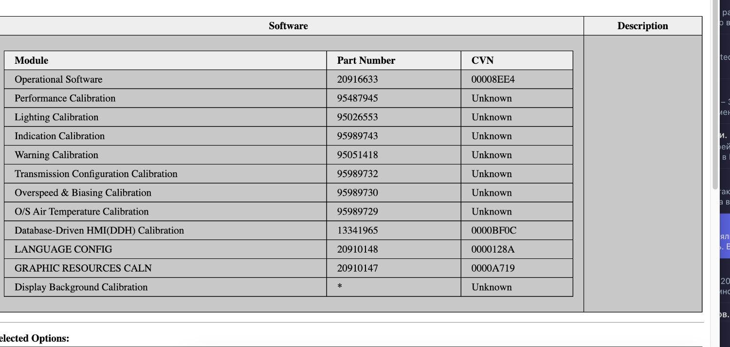

  • hello, i have get new ipc vin 2011 china is: LSGPC53R3BF000379   ipc_ltz_cn_2011_final.zip
  • i'm check  with FX3 then different is: Indication Calibration 95989747 Unknown Warning Calibration 95051419 Unknown
Hi, can you share with me your cal's archive, plz? i have chinese ipc too, but can't get this files from sps 😞
it's very help me 🙂

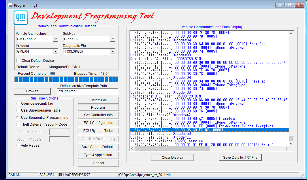

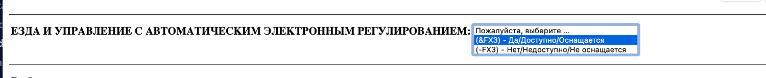

Now my IPC w/o ESP and i need to reflash ECU, option &FX3 when you get cal files.
Thank you very much!2024-01-1716_32_48.png.29abd59abe789584d72f91d08644c6ad.png
95989747 95051419

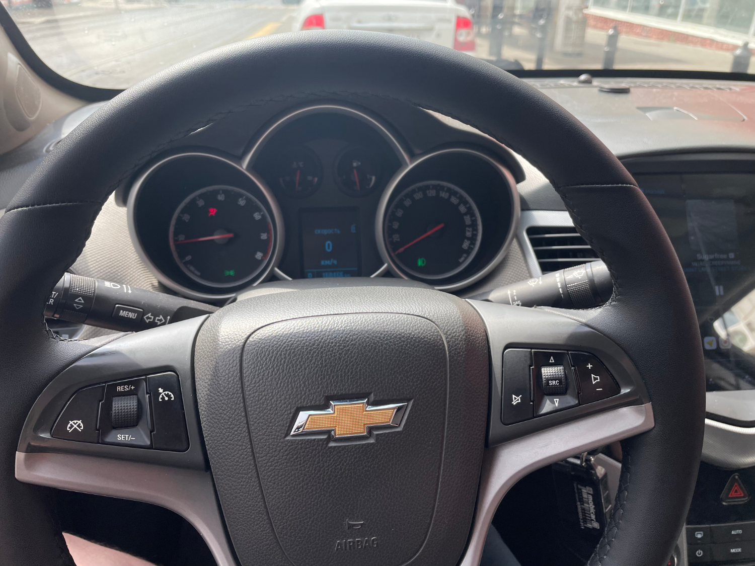

hello friend, ipc have display lamp cruise control and auto wipper, auto light in new car?
Hi.
cruise - works fine.
auto wipper and auto light - indicator not work, but popup on display are shown, try find cal’s for fix lamps…

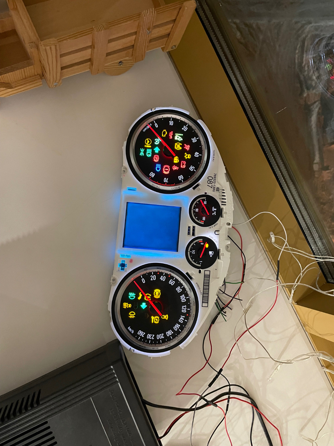

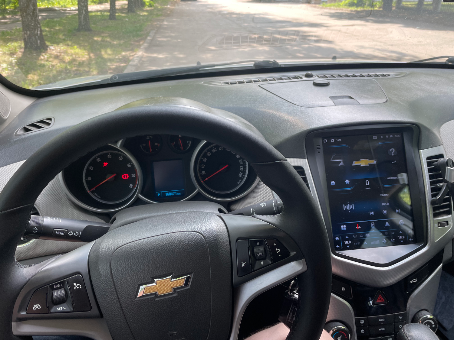

10 hours ago, kamilot said:
Now I am playing with astra j ipc 😂 good working at Cruze😅
wow, using ipc astra for cruze? form is fit? it is very cool
Yep, I inserted it into the form of the Cruze instrument panel. I had to slightly shave off the body with a knife, and it was like this: 😄
Some summer photo:
P.S.: Problem with airbag on IPC, cos my cruze is 2010 🙂 If you have Cruze > 2012 - it's not your problem 🙂 2010 has another SRS ECU 😞
