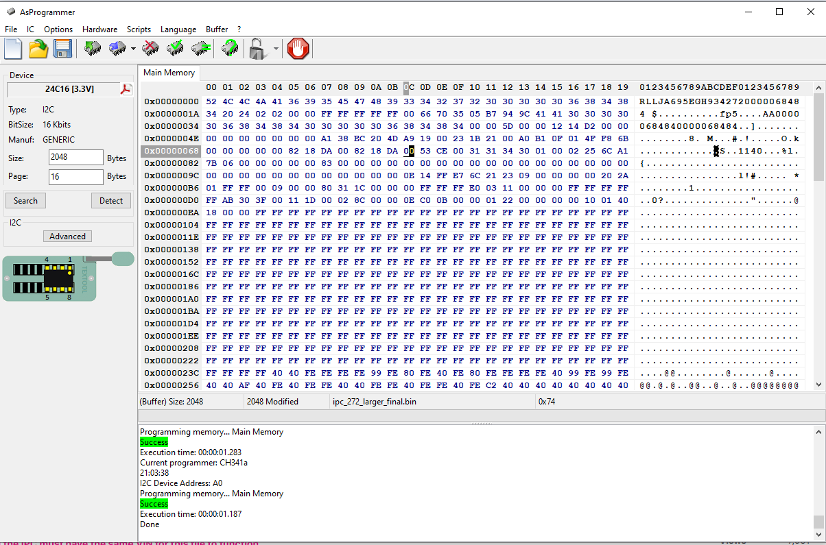

- - - show when VIN don’t match. Pin doesn’t play role to display mileage. I see VIN is edited, may be by hand. So there is posibility fo be made error and speedo not function correctly
yes. My update VIN by hand using tool CH341A

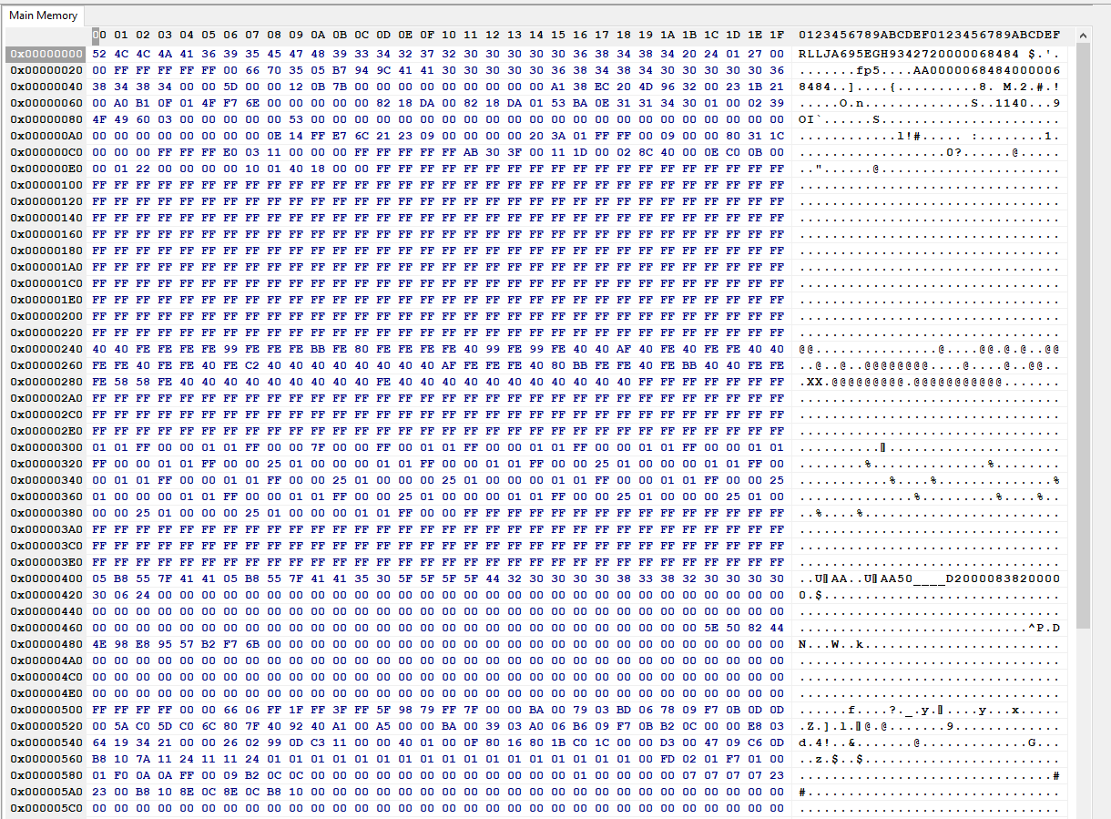

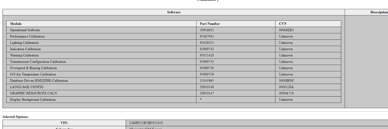

  • hello, i have get new ipc vin 2011 china is: LSGPC53R3BF000379   ipc_ltz_cn_2011_final.zip
  • i'm check  with FX3 then different is: Indication Calibration 95989747 Unknown Warning Calibration 95051419 Unknown
Is it your original VIN?, may be mistake in one symbol? I had same issue  🙂  can you make screenshot that part of your’s dump?
14 hours ago, kamilot said:
Đây có phải là số VIN gốc của bạn không?, có thể bị nhầm lẫn ở một ký hiệu? Tôi gặp vấn đề tương tự   🙂   bạn có thể tạo ảnh chụp màn hình cho phần kết xuất của bạn không?

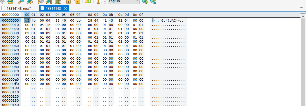

my org ipc is 272, new ipc i change vin using dps before read eeprom. Please check image attachmentimage.png.7719c3dbdaeb5a205225ae7d4b4659f8.pngimage.png.000d8e5d7dc96245afe4390870bc4669.pngimage.png.93a3be0d301fe5daca1da65c94bf0c8c.png

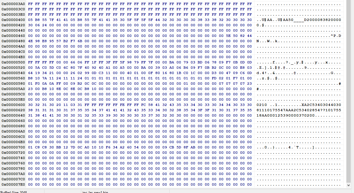

Hi bro, you can find location part number in file bin of eeprom of IPC
And i'm want know flash ipc different part number is allow?
ipc_lar_new1_en.bin
I fixed the immo error and not displaying the km as follows:
To get rid of the immo error in GDS2 I reprogrammed the key
To display km as in BCM, change this value to 00

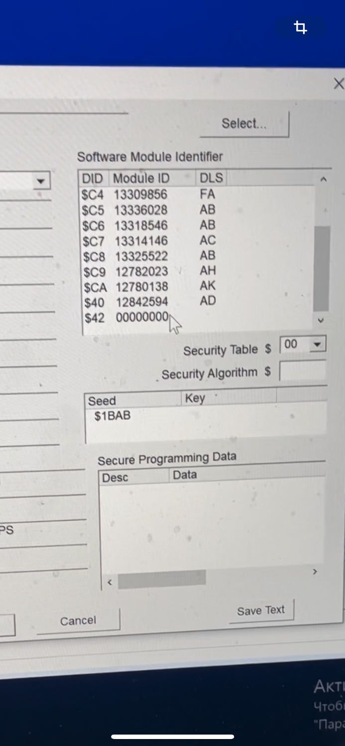

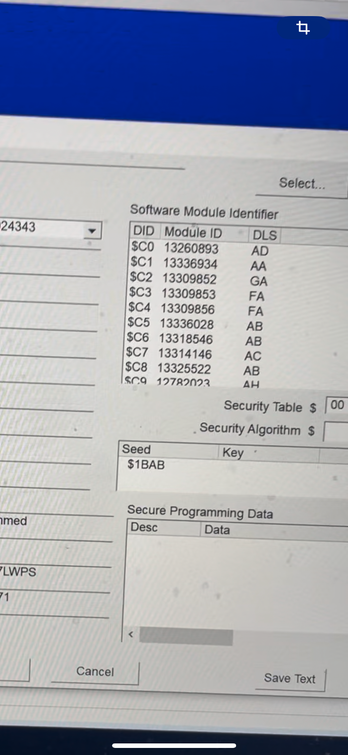

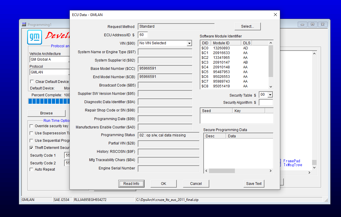

I am already have idea, why we has this error. Cos ours panels need 12 calibration files ( 12 is emty, but usually it upload at factory), but sps give us only 11. I have no idea, how to write empty calibration…
I am flash random from opel, and now ipc work.. but not good 🤣
On 2/4/2024 at 7:46 PM, kamilot said:
Look here at $42 - it’s what we need to recovery our panels 🙂
I think position number 12 is unnecessary, but first I need to get the ipc working again. Can you give me the vin number to get the opel file like you said

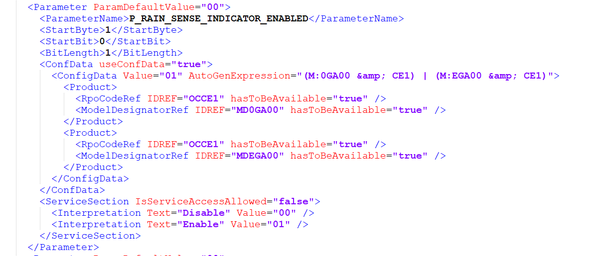

Hey,
regarding the autowipers...
Have you tried to enable the indicator via 0xA6 Byte 1-Bit 0 configuration DID?
0xA6,0xE6,0x8A,0x30,0x90,0x8A,0xEE,0x1F,
0xA6,0x00,0x01,0x02,0x03,0x04,0x05,0x06,
    00 - 01 DOOR_AJAR_INDICATOR_ENABLED
       - 02*DIESEL_PARTICLE_FILTER_INDICATOR_ENABLED
       - 04*CHANGE_OIL_INDICATOR_ENABLED
       - 08 CARGO_DOOR_AJAR_INDICATOR_ENABLED
       - 10 BULB_OUTAGE_INDICATOR_ENABLED
       - 20*CRUISE_ON_INDICATOR_ENABLED
       - 40*CRUISE_ENGAGED_INDICATOR_ENABLED
       - 80*FRONT_FOG_LAMP_INDICATOR_ENABLED
    01 - 01 RAINSENSE_INDICATOR_ENABLED
       - 02*PARK_ASSIST_INDICATOR_ENABLED
       - 04 ELECTRIC_COLUMN_LOCK_INDICATOR_ENABLED
       - 08*COMPETITIVE_MODE_ESC
       - 10 COMBINED_AJAR_INDICATOR
       - 20 LANE_DEPARTURE_INDICATOR_ENABLED
       - 40 DIESEL_EXHAUST_FLUID_INDICATOR_ENABLED
       - 80*ACTIVE_FRONT_STEERING_INDICATOR_ENABLED
You have to do this manually, there will be no RPO code enabler in the xml file for this...
Have fun...
Greetings, Toby

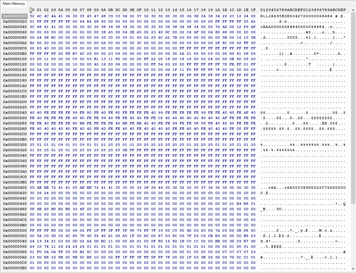

my file indicator of ipc, you can tell me location in file enabled autowiperimage.png.043bed3adba0695f4979832d1f5b7d59.png

sorry, i'm add a06 did the same image but auto wiper not active lightimage.png.7c88454ea116f024b784cd995c32434d.png
Hey,
please set the ParamDefaultValue to "01" and try again.
It is just a guess, I haven't done this yet, but I will check it on my Astra this weekend.

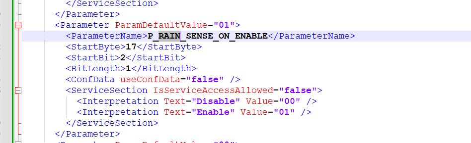

i'm trying add new option and display in screen when enabled auto wiper, then indicator not active lamp when i'm trying change indicator Byte 1-Bit 0 configuration DID
It is problem of Operation System, I think) try to switch on all indicators via gds2 test function)

you need the Utility File when you compile the archive.
The Utility File lies along with the calibration files when you merge the calibrations via sps, but when you check on tis2web its number is not there, but it is in the folder.
this is a screenshot using my bcm as an example
image.png.7d99b717575dbce840e42626dbb11729.pngimage.png.e7b06a803197e8ae5e750d0e87f21263.png
12 hours ago, Slava Colpak said:
kamilottungnv93pt
Thank you, but ours dps archive created correctly and with utility file include. We have problem with last calibration file - Display background calibration 🙂 It must be empty...but when we try flash another OS, something change at flash memory and now, when we try flash stock OS -- we have trouble: IPC wait for 12 cal file, but it is not at SPS archive..
