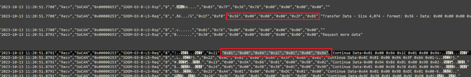

I saw it was a VXDiag..  it really looks like it's having communication issues for sure looking at those logs.  I was wondering if the OP was running it wirelessly too.....  I run my VXDiag Nano wirelessly and it's pretty good but ....  if the OP is, it would be worth trying wired.  The log I reviewed, it clearly sent the first calibration (OS approx 65k) but retried like crazy to get there.  So I'm almost leaning really towards that being the issue now.

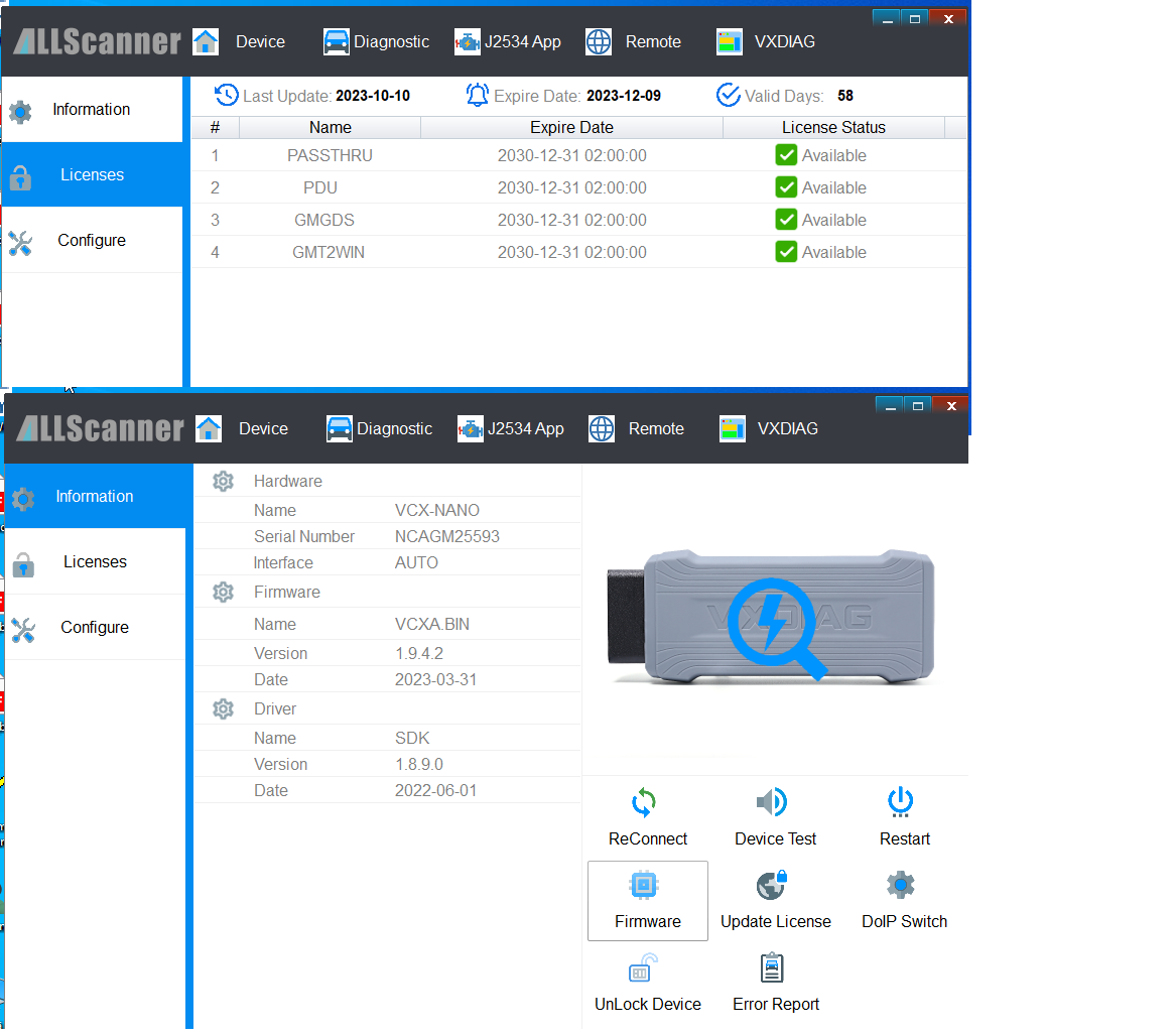

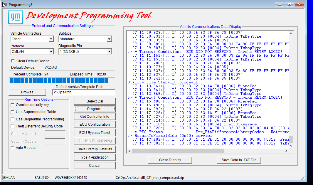

- cable is vcx nano, with GDS options. Finrware is latest(1.9.4.2) working fine with USB cable to other modules(SPS)
- DPS Log what you had been looking in first place is from reporgramming where used 33.1k and pin1. Maybe this explain those time outs ?

I use the exact same unit as you, I have one that is wifi/cabled and one that is cabled.
Do me a favour if you can?  Run DPS, try to program it then grab the file in C:\Programdata\vcx\logs\passthru\vcxpt32.log
Even better, if you can run the process through SPS then grab that file and share it here, that'll help more.  Just curious to see what that shows.  It shows MUCH more detail than DPS.

Perfect!  I know SPS didn't work but I see you're set to 83.3kbps, did you try 33.3kbps?  Most stuff I program at the lower rate but I will admit, I haven't done the newer SDGM.  I have one sitting here though that I can test if you get me our DPS A package too.
You didn't even get passed the security this time....  try 33.3kbps and let's see how far it goes.

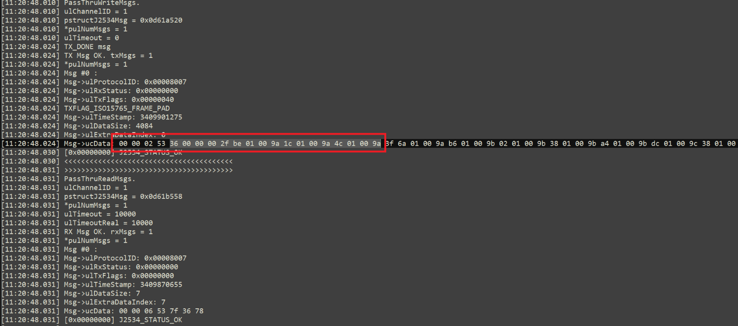

In fact, something in your settings even attempted to flip your VXDiag into J1850VPW (but it doesn't support it anyways):
[08:16:52.884] >>>>>>>>>>>>>>>>>>>>>>>>>>>>>>>>>>>>>>>>
[08:16:52.884] PassThruIoctl.
[08:16:52.884] ulChannelID = 1
[08:16:52.884] enumIoctlID = 0x00008000
[08:16:52.884] pChannel = 0x70db4080
[08:16:52.884] Unknow IOCTL ID
[08:16:52.884] [0x0000000f] J2534_ERR_INVALID_IOCTL_ID
[08:16:52.884] <<<<<<<<<<<<<<<<<<<<<<<<<<<<<<<<<<<<<<<<
#define J1850VPW_PS                        0x00008000
Again, if you can, flip it to GMLAN and set to 33.3kbps.  If it failed in SPS, I'm expecting it may again but I'd like to see the logs from that.
Just now, mikko virta said:
Ok, so that again went through the first upload but encountered a lot of issues.  Definitely run this at 33.3kbps though because I've looked and I can see the security access request is for normal speed programming, not high so I'd expect that to fail.  However, you're still getting communication errors for some odd reason.
Can you attach your DPS file? (the .zip)  I want to see something 🙂

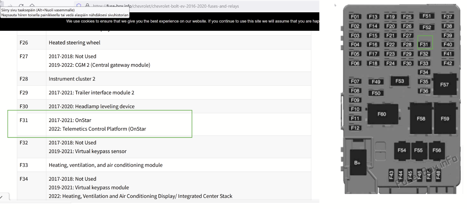

While I look at this....  I remember a TSB being released about removing the Onstar fuse, wait 30 seconds, put the fuse back in, turn the key on, then program.  Do you have Onstar?  Can you try that if so?
Yes, this car has onstar functionality(of course not working here in europe anymore)
So my steps should be:
1. open locked doors
2. onstar fuse(F31)  30 second "reset"
3. Put car service mode
4. Program by DPS using 33kb speed
Close 🙂
1. Load DPS, select package, have it ready to program (GMLAN, 33.3kbps)
2. Ignition Off
3. Pull Onstar fuse, wait 30 seconds
4. Insert fuse (it doesn't specify turn key on or service mode - try with key off first - the SDGM may still be awake...)
5. Hit program immediately
Onstar reset tested with NO servicemode. Like before same result.

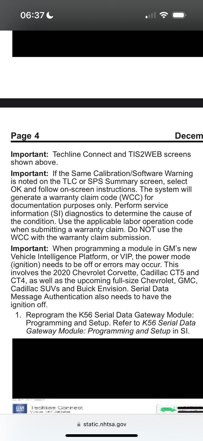

 I had a minor mishap with the SPS2 update, and the end result is that the K56B (serial gateway) update was interrupted. It was later revealed that this particular component should not be updated if there are HV DTC codes in the car (which I had).

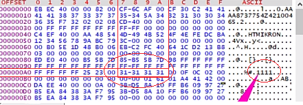

OPEN BCM,, READ EEPROM 95320 , PIN IS ON 00A0-789A GRAPH,, CHANGE 4DIGIT NUMBER TO FF
