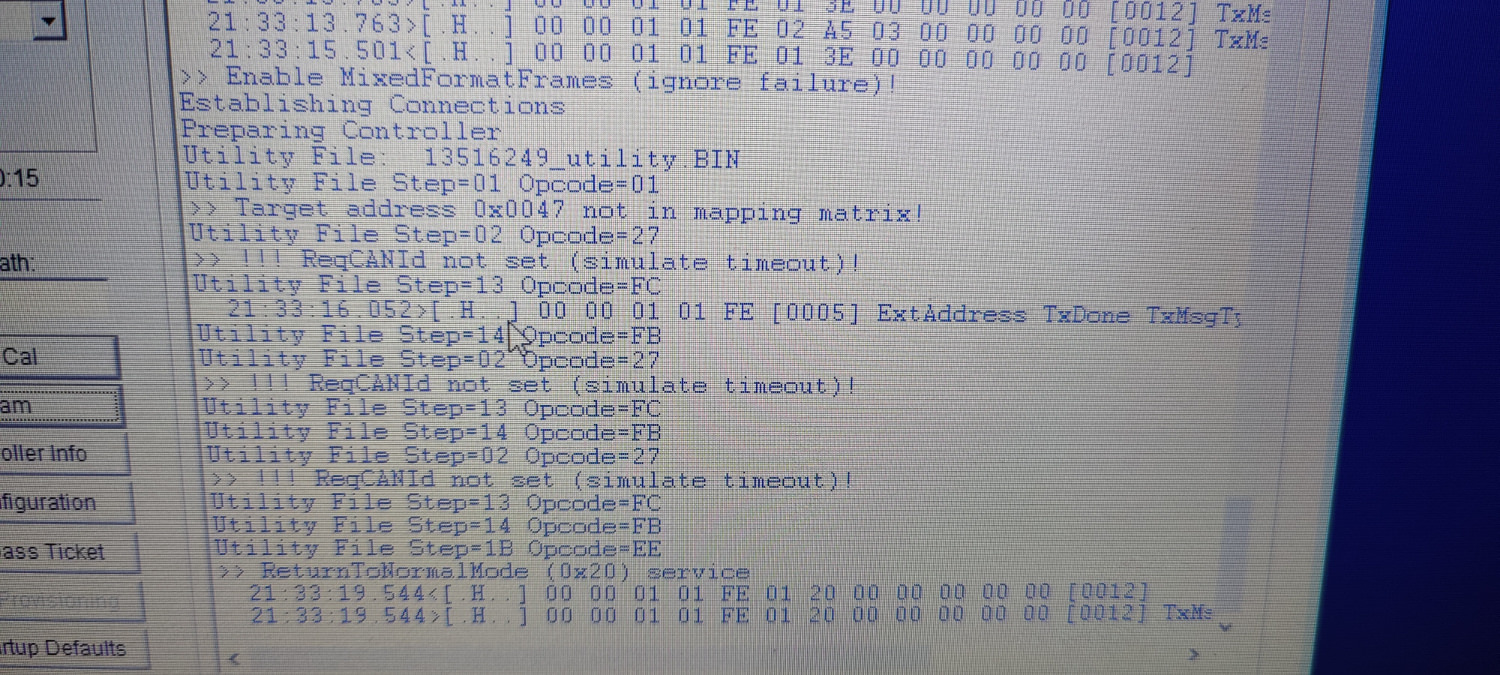

Then after that tried to  Do Serial B got that {0x0047 NOt in mapping matrix error}
I havent done after that anything. Car still on service mode
I don't know is this relted to anything, but if i try to use [get cotroller info] and use adress 47 it hasn't work .

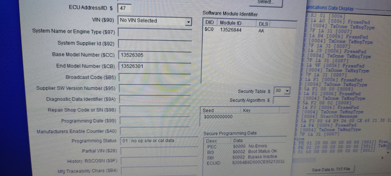

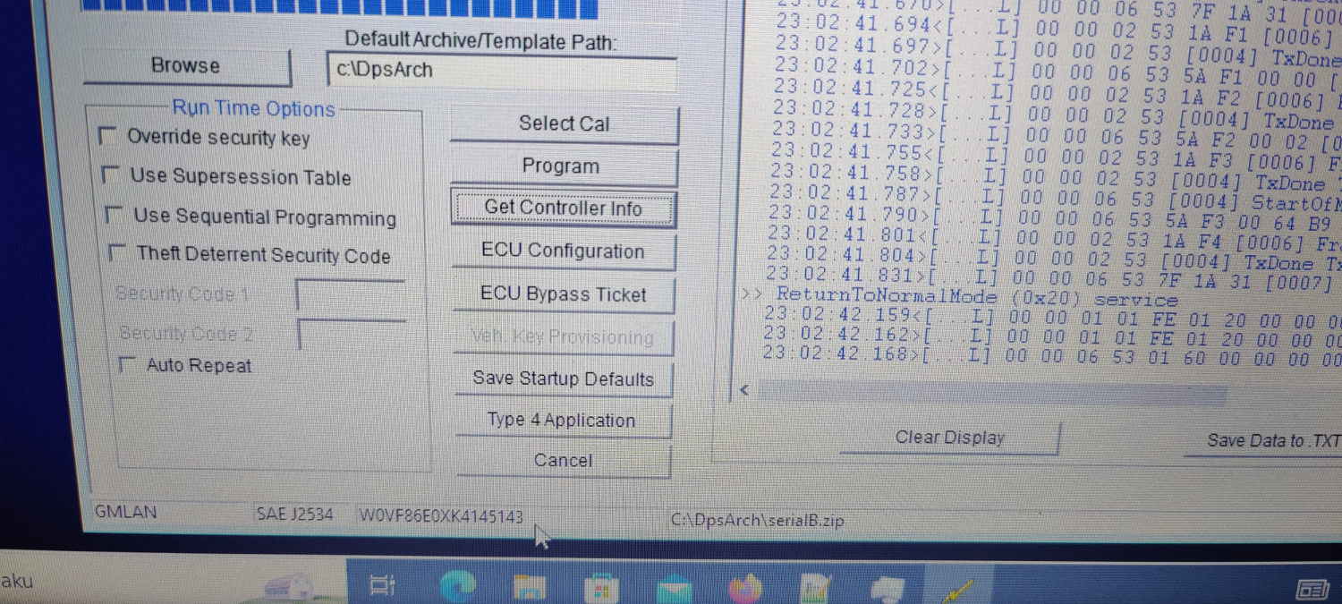

Did you ask that did i choosed cars own vin by using [get controller info] dialog.(attachment) ?
This method was atleast work for serial A.
After fail i have this kind of info from [get controller info] dialog.(attachment)
It clearly says that SW is not there
log simple say cannot wake up device.

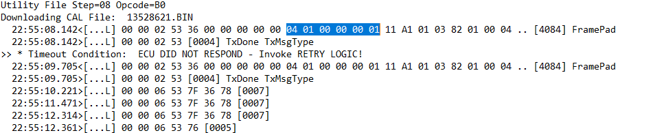

  01:36:36.2  MsgType=1, <[...L]00 00 02 53 36 00 00 00 00 00 04 01 00 00 00 01 11 A1 01 03 82 01 00 04 .. [4084] FramePad
  01:36:36.2  MsgType=2, >[...L]00 00 02 53 [0004] TxDone
* Timeout Condition:  ECU DID NOT RESPOND - Invoke RETRY LOGIC!
  01:36:37.8  MsgType=1, <[...L]00 00 02 53 36 00 00 00 00 00 04 01 00 00 00 01 11 A1 01 03 82 01 00 04 .. [4084] FramePad
  01:36:37.8  MsgType=2, >[...L]00 00 02 53 [0004] TxDone
  01:36:38.3  MsgType=2, >[...L]00 00 06 53 7F 36 78 [0007]
  01:36:39.5  MsgType=2, >[...L]00 00 06 53 7F 36 78 [0007]
  01:36:40.3  MsgType=2, >[...L]00 00 06 53 7F 36 78 [0007]
  01:36:40.4  MsgType=2, >[...L]00 00 06 53 76 [0005]
  01:36:40.5  MsgType=1, <[...L]00 00 02 53 36 00 00 00 0F EA 44 00 0C 40 0B 66 D1 40 0B 6B 26 00 0E 00 .. [4084] FramePad
  01:36:40.5  MsgType=2, >[...L]00 00 06 53 30 00 00 00 00 00 00 00 [0012]
  01:36:40.5  MsgType=2, >[...L]00 00 02 53 [0004] TxDone
  01:36:42.0  MsgType=1, <[...L]00 00 02 53 36 00 00 00 0F EA 44 00 0C 40 0B 66 D1 40 0B 6B 26 00 0E 00 .. [4084] FramePad
  01:36:42.0  MsgType=2, >[...L]00 00 02 53 [0004] TxDone
  01:36:42.5  MsgType=2, >[...L]00 00 06 53 7F 36 78 [0007]
  01:36:44.7  MsgType=2, >[...L]00 00 06 53 76 [0005]
  01:36:44.8  MsgType=1, <[...L]00 00 02 53 36 00 00 00 1F D4 7F E6 10 70 70 E8 E0 0B 1C E7 85 3F 4A 04 .. [4084] FramePad
  01:36:44.8  MsgType=2, >[...L]00 00 06 53 7F 36 78 [0007]
  01:36:44.8  MsgType=2, >[...L]00 00 02 53 [0004] TxDone

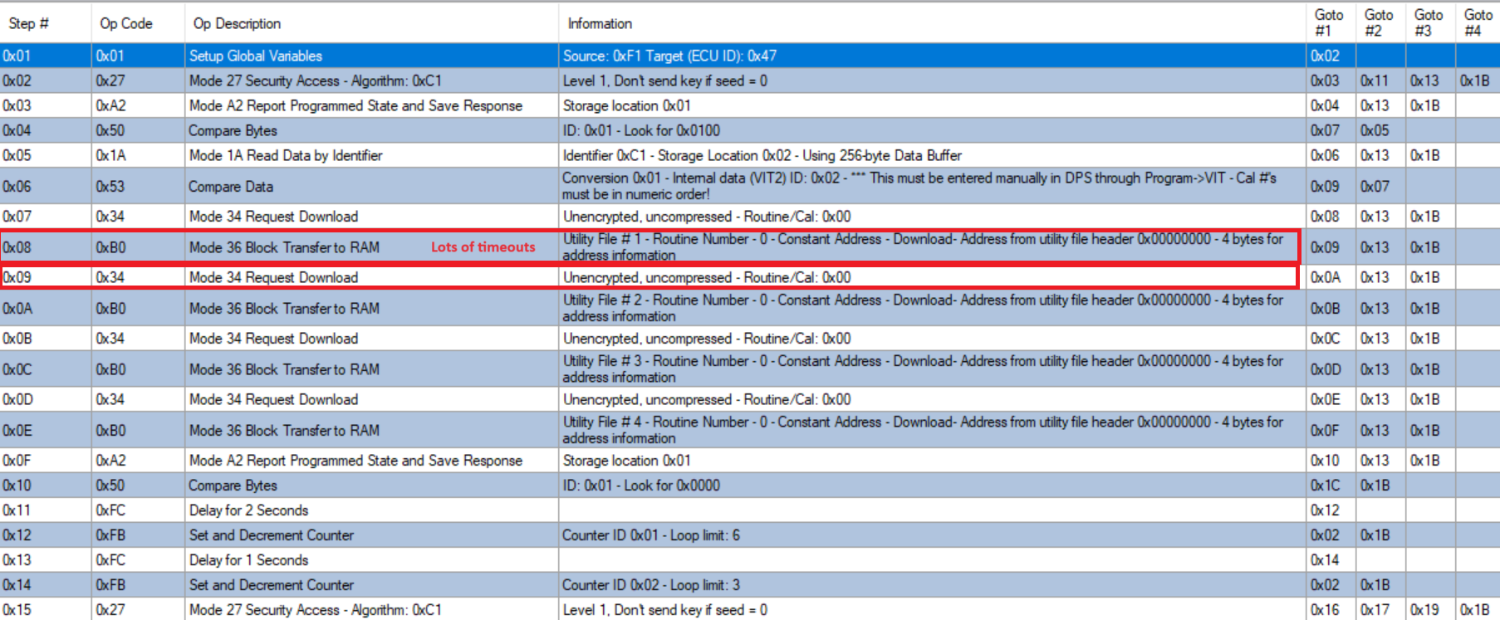

I've just re-read your log and that's VERY interesting.....  it struggled and struggled to get the first calibration uploaded, it kept timing out but it did eventually make it.
Step 08 - Struggles to send the OS calibration but eventually makes it after lots of logic retries
Step 09 - Fails to get a proper response so jumps to retrying, jumps to Step 13
  It receives this with a return RequestCorrectlyReceived-ResponsePending (expected)
Step 13 - Delay for 1 second jump to step 14
Step 14 - Increment the counter then jump back to step 02 and start again
Step 02 - Request security access again
Step 03 - Reports programming state
Step 04 - Compares, jumps to Step 07 (calibration to decide whether to skip uploading the OS or not)
Step 07 - Prepare to upload the OS calibration again, sends a 34 request
*** Fails this time as the unit responds with code 22 ConditionsNotCorrectOrRequestSequenceError
Are you sure this calibration is compatible with this unit?
It is interesting to me though that it does eventually make it through uploading the first calibration (note in step 08, many invoke retry logic messages but it eventually does finish and goes to step 09 to try the next).   I'm leaning it's either not compatible (but not sure) or you have some communication issue going on.
The attached will show the logic order  The goto's will depend on whether a step was successful or not.
