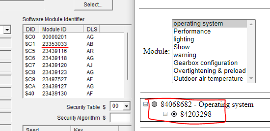

Is there a chance something is wrong with this cluster? Is not even allowing me to program it with the same calibrations.
I found it odd that the OS is not the same:
really i dont know. but for some reason the cluster is rejecting the security access
if the speedometer never has been updated in dealer, can be normal

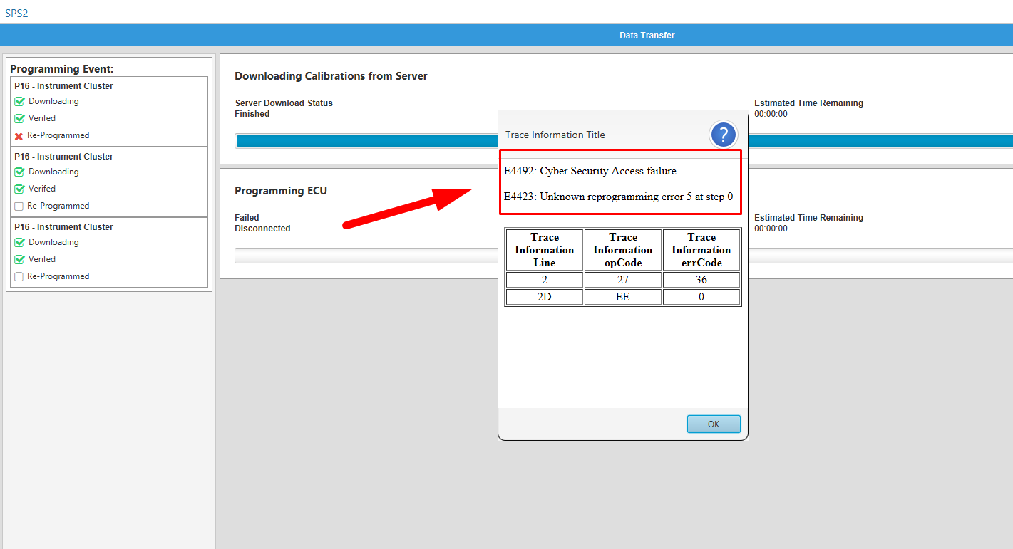

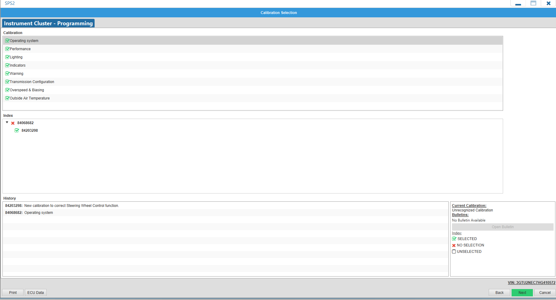

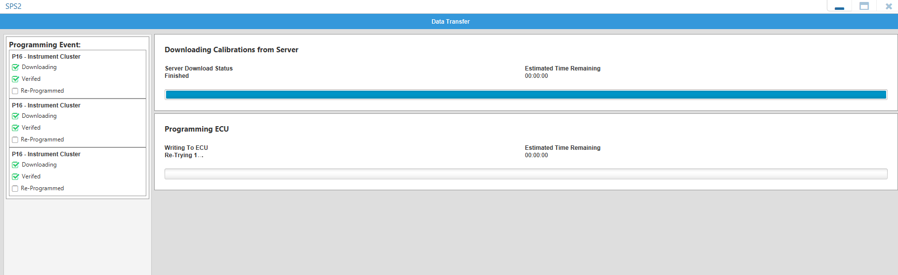

The programming never went through. Im having the same VIN since the cluster arrived. The vin the cluster has is the original. I may program the cluster with ori calibrations from SPS2 and lost the $45 to see if something changes compared to original.
Something is wrong with this cluster. Even thru SPS2, is not going thru.image.png.a9c5e9a81f7d6ec8bc96b9642e54eb6d.pngimage.png.1d7574c6497c16f5d3b39f0c1cc29382.png

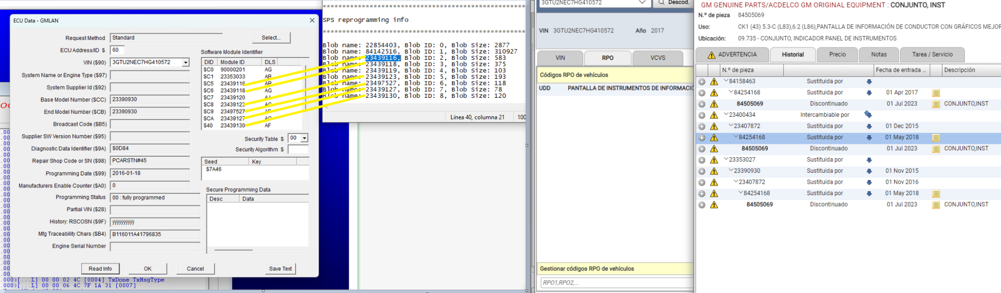

5 hours ago, Lister Llanes said:
This is the getting the controller info.
I found something...
This calibrations are from UHS speedometer (i checked my saved files), and the CC/CB 23390930 is a Part number of UHS.
But this VIN not have UHS... it have a UDD
UDD and UHS have different Security access. Then, there is the problem.
Now, why the vin 10572 have a UHS???
Are you trying install this: (UDD)
Or this? (UHS)
