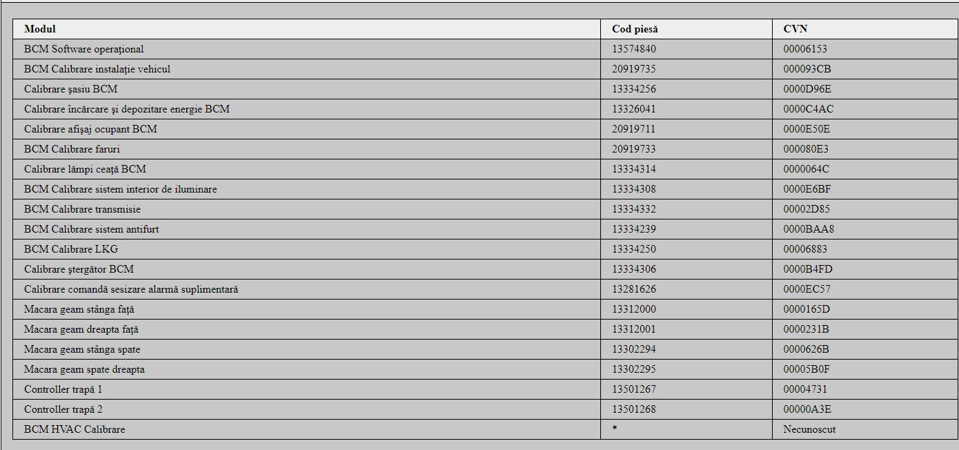

hello, I installed the receiver, I wired it, I activated IPC with TPMS but I don't know what to do with BCB
in BCM I have these calibrations

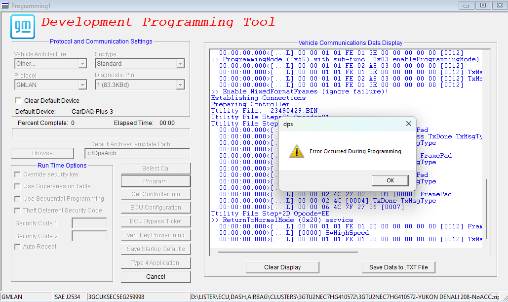

Hi @codebuilder, Im having this error when trying to program. Attached the log.
ProgramLog.Txt
Did you try Pin 1 33.3KBd ?
Yes of course. I always test communication using the ECU Configuration. If you check the log file. There is communication.
I meant the Get Controller Info option
Where did you get the original calibrations from?  It's failing on unlocking to program.  Is that the true calibrations for that cluster?  The algorithm seems wrong.

Oh! as Robi_X pointed out, your screenshot shows 83.3kbps?  Or was that just an attempt after?  Definitely needs to be 33.3.
Yes, I tried at 33.3 also, same issue sir.

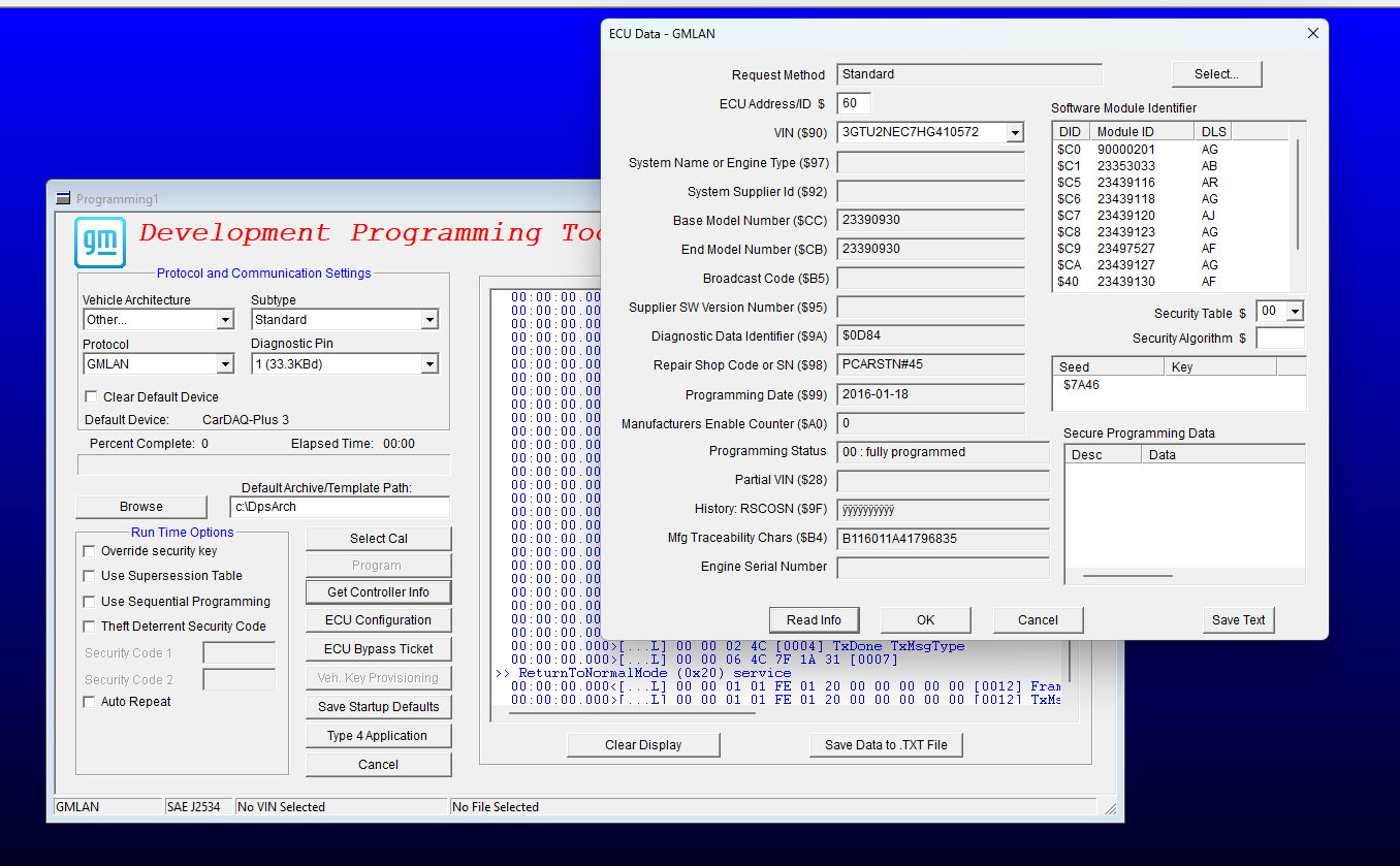

This is the getting the controller info.
Yes, same thing at 33.3
The VIN showing below doesn't match?  Was the cluster swapped?  The security algorithm is definitely wrong and the VIN doesn't match, I can see it in the screenshot?

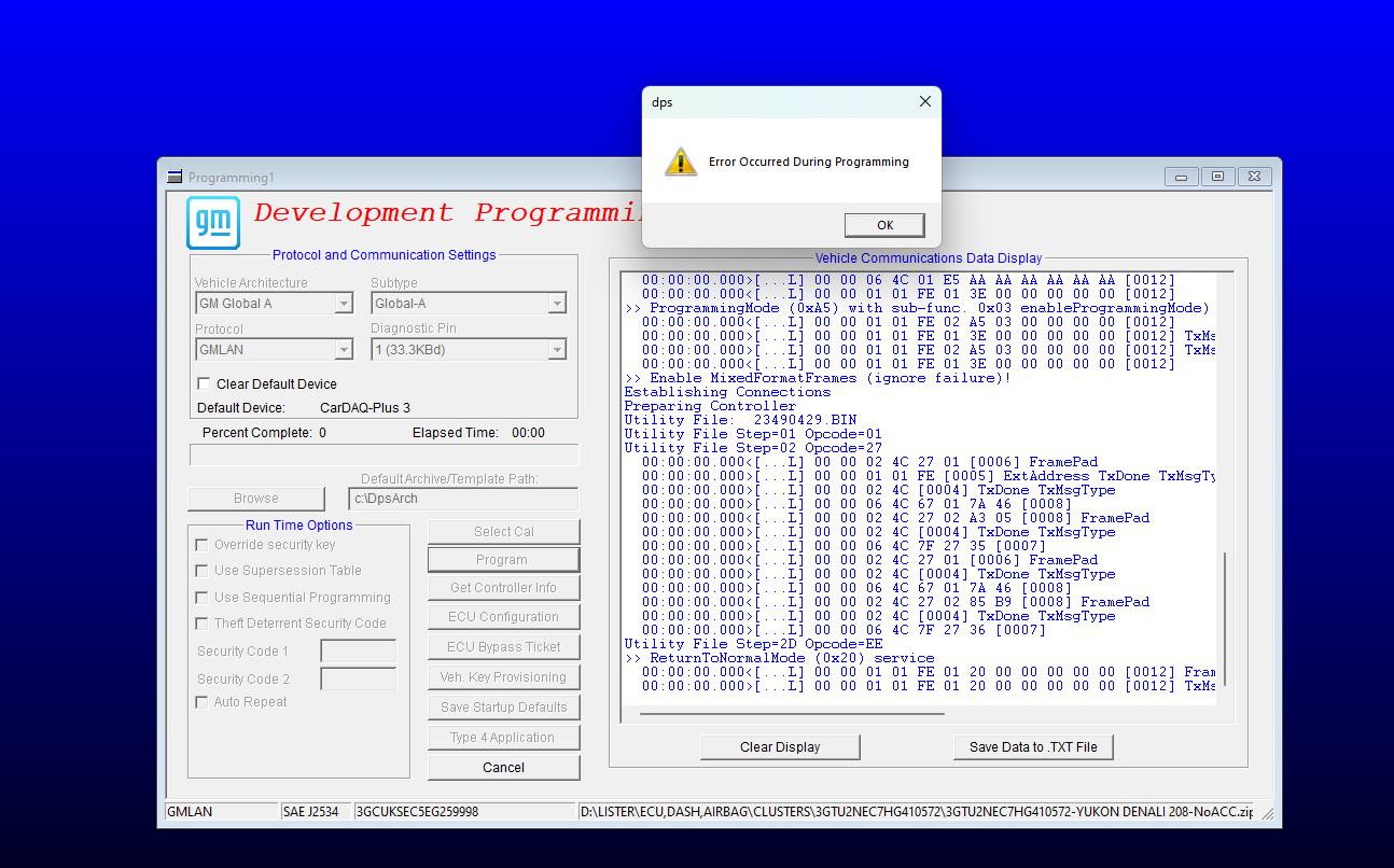

No, I have been working in the same cluster. One thing happened to me trying to program the XML with a Buildrecord, I got error Module $27, so I though forcing the programming would work.
Something is definitely a miss there.  The file you sent me has a different VIN in the filename itself than what shows on the bottom?  You're failing on the XML configuration due to the wrong security algorithm too.  Are you sure that's the right one?  Your screenshot tells me otherwise?

If I read the controller info, Im getting the VIN number from the screenshots. Got this cluster from junk yard. I tried to program the vin by XML. Never had any issues doing so.
