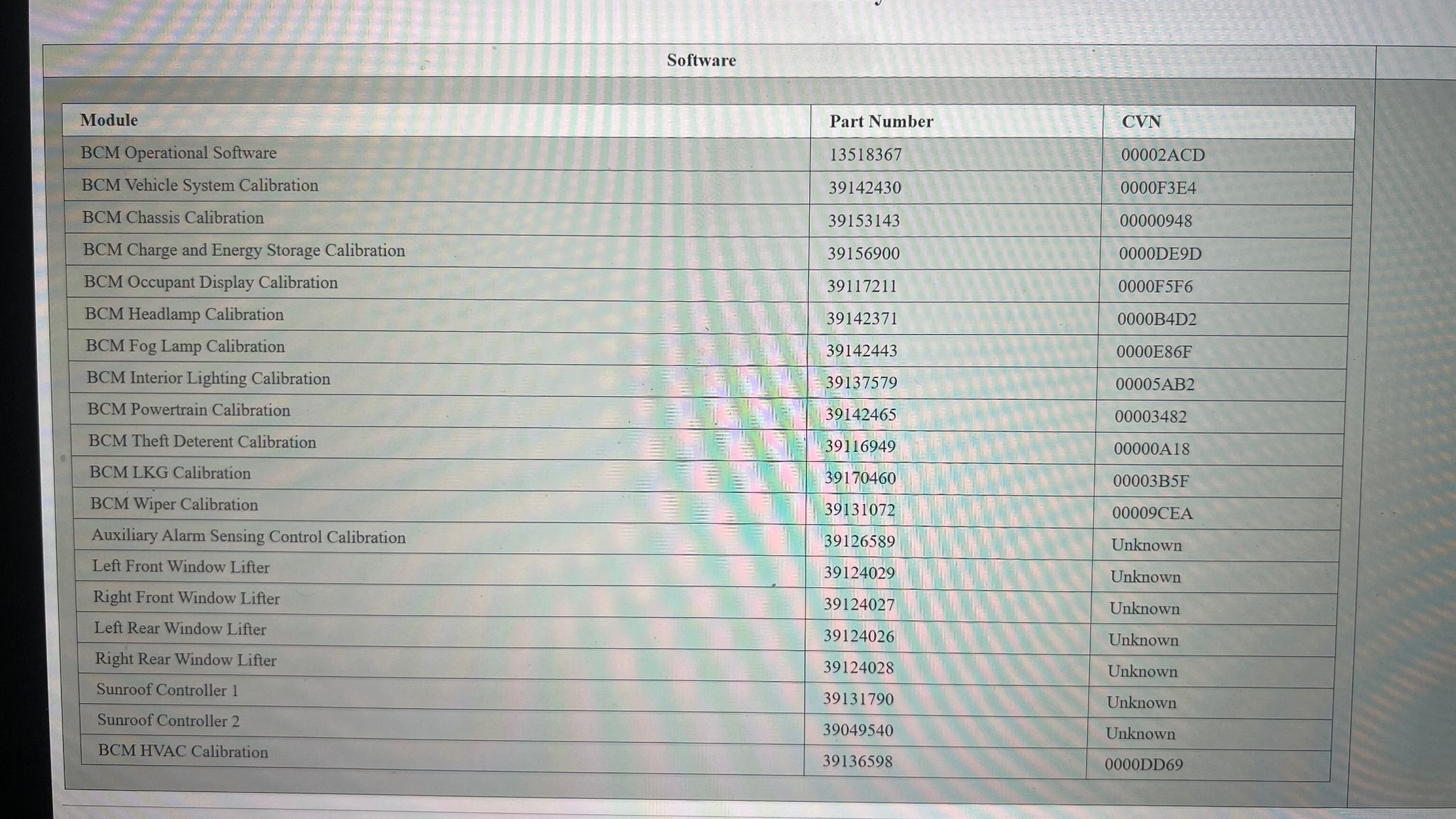

HCM and FCM both.  For whatever reason I was unable to build my own HCM DPS archive off the cals I pulled off of SPS, but I was able to program it using the VIN of a scrapped Insignia B that I found online.  (The HCM is sensitive to suspension setup - the TourX has the five link suspension but is not adjustable, and woe unto those who choose the wrong setup not knowing any better.)

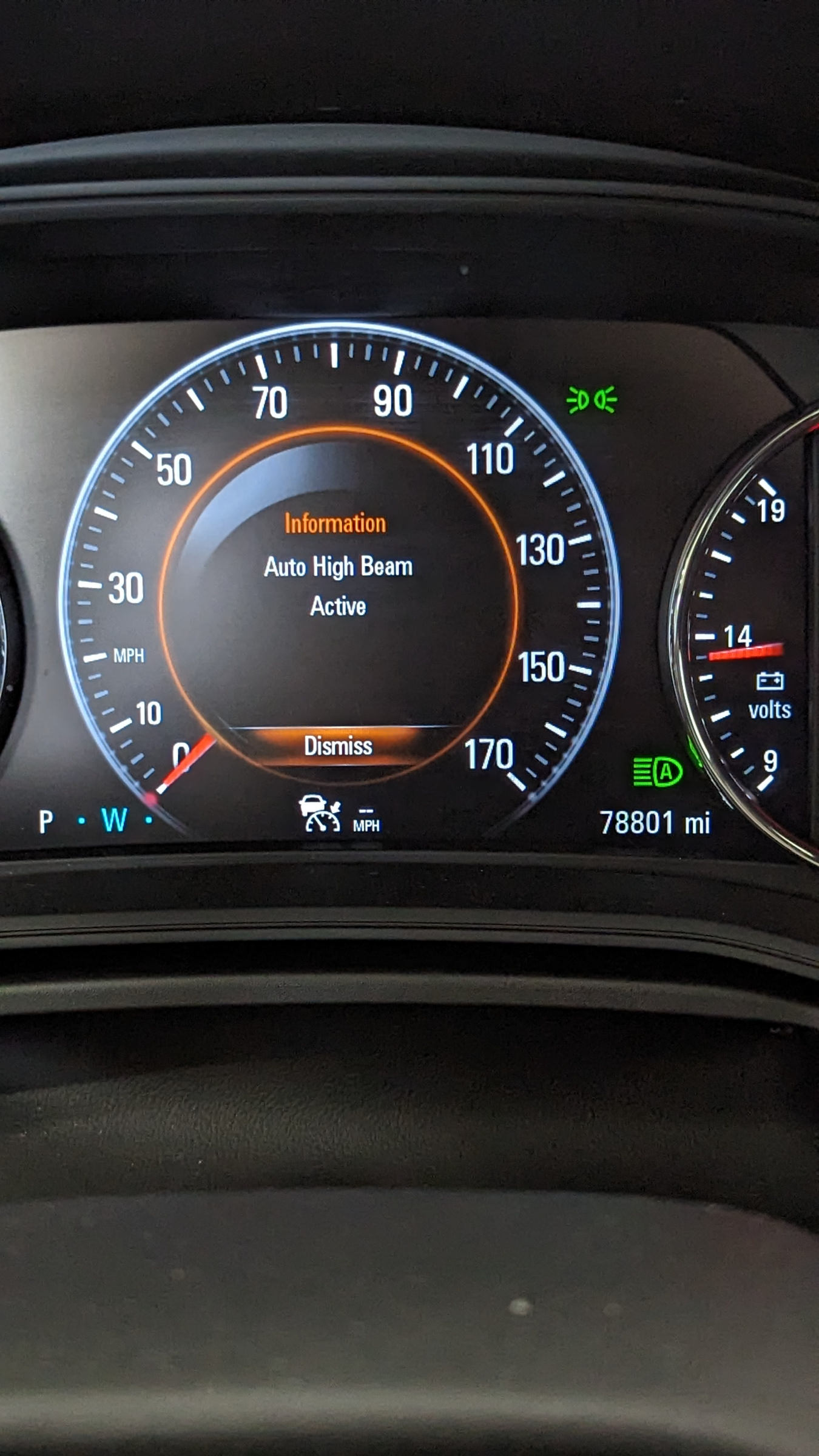

A little update:
Over the weekend, I thought to run both the stock TourX BCM headlamp calibration file (39143006) and the stock Insignia matrix LED calibration file (39142371) through @Troy's Hex Editor Neo program to find differences between the two, which I then recorded in an Excel spreadsheet.
The differences between the files fell into three categories, excluding checksums: (1) items which were inactive in the TourX file (coded as "00") but active in the Insignia file (coded something other than "00"); (2) items which were active in the TourX file but not in the Insignia file; and (3) items active but coded differently in each file.  Within category (1), there were also a couple bytes which had entries other than "01", such as "64" or "96".
The obvious place to start seemed to be category (1), so I took the TourX calibration file and switched the bytes that were coded "01" in the Insignia file from "00" to "01" in the TourX file and loaded an archive onto the BCM using the modified calibration last night.

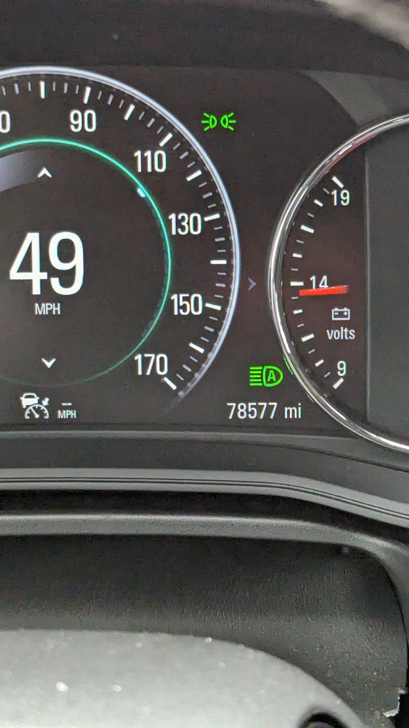

Nothing appeared to happen last night, but this morning when I started the car I was greeted by this:
I cannot tell if the system itself is working as it's daytime here.  I can shut the low beams off from the switch on the dash, but when in automatic mode the low beams remain locked on, and I cannot turn the auto-high-beam indicator off from the switch on the stalk.  But: the indicator light is on!
I've attached the headlamp calibration I used, as well as my spreadsheet highlighting the differences between the stock TourX and stock Insignia calibrations.  Anyone who wants to see if they can get something that will un-lock the low beams is more than welcome to - I have some ideas on that as well that I'll be experimenting with later this week.

Evidence of more fruit borne by my amateur coding efforts attached.
By taking the stock BCM headlamp calibration file and changing the byte at 3c9 from "00" to "01", you apparently restore the low beams to normal function AND slave the auto high beams to them. In other words, the low beams stay off in daylight, but come on AND bring the auto high beam system online when the ambient light sensor doesn't detect enough light. The stalk button has no effect - I can't turn the system on or off independently of the low beams - and the auto high beam icon in the cluster is not lit unless the low beams are on.
Light at the end of this tunnel? Maybe.  I've also added the modified headlamp cal file if anyone wants to play with it some more.  I'll be continuing my efforts as well to see if I can't make it function *correctly* instead of just functioning *acceptably*.

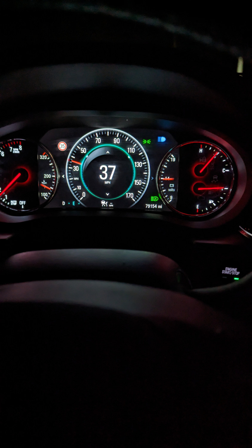

Finally got out to a dark road at night to test with video...and, folks, I think we got it.
I still need to sort out the correct operation of the switches, but you can pretty clearly see the left-side lamps adjusting themselves multiple times to dim down for oncoming traffic and then come back on full force.
Should appear High beam blue indicator on dash when is active.
High beam should be on at all the time and oncoming traffic should be cut out from the beam by dimming or turning off LED elements. It is hard to tell from the video what it is actually doing.
