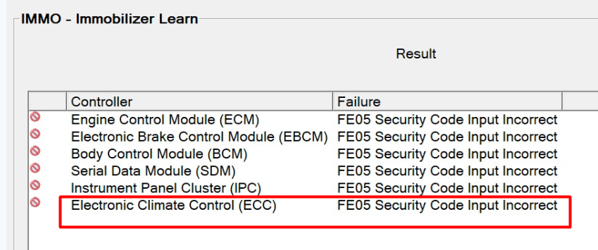

If change VIN, It can not change PINCODEimage.png.6288d38c6ee62b364e6cc4c029cb5b9e.png
Just relearn your keys and HVAC will accept new code
Not really. I had to use abrites to change security code to get keys programmed.
