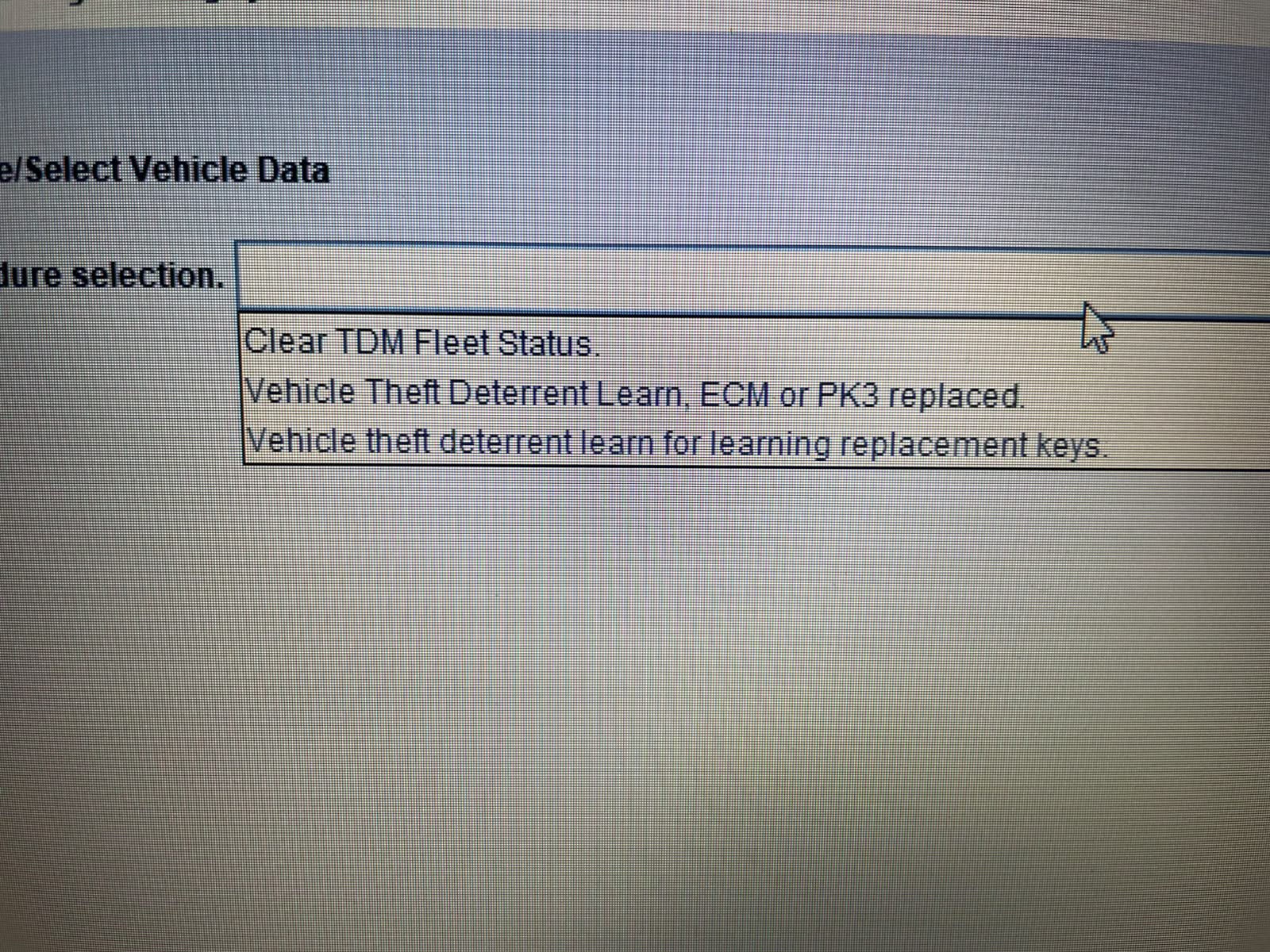

    Yes, I checked. It gives 1 item. Perhaps you need to select the correct option in the second picture. I downloaded and sent the one in the first picture. Please check and report back. 1GNUKBE08AR

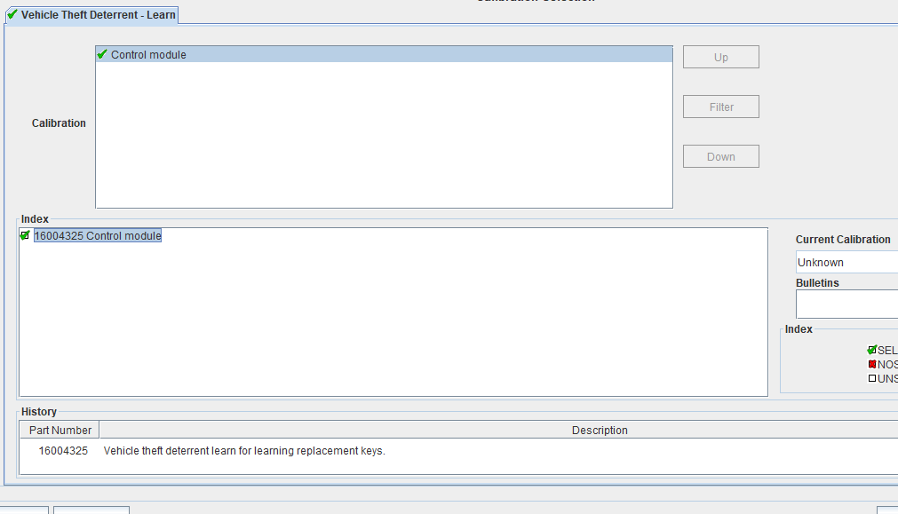

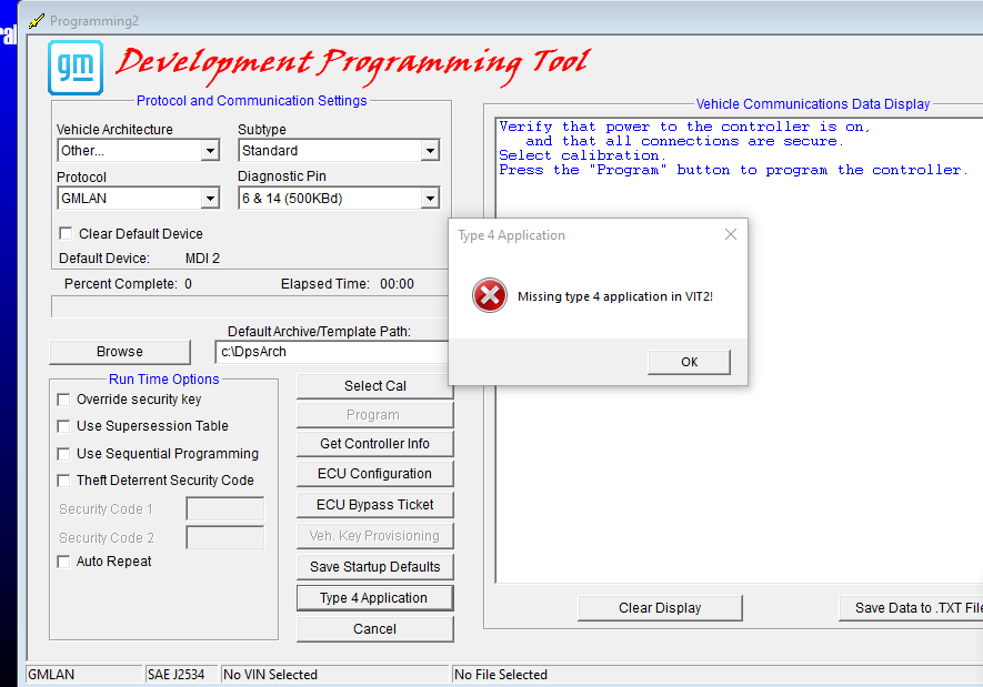

@TunnerXP
It's not a Type4 app - it is a Utility file that just triggers the procedure.
Just select archive and hit "Program" button.
You must follow correct sequence for it to work (you can find info in TIS or from Internet).
