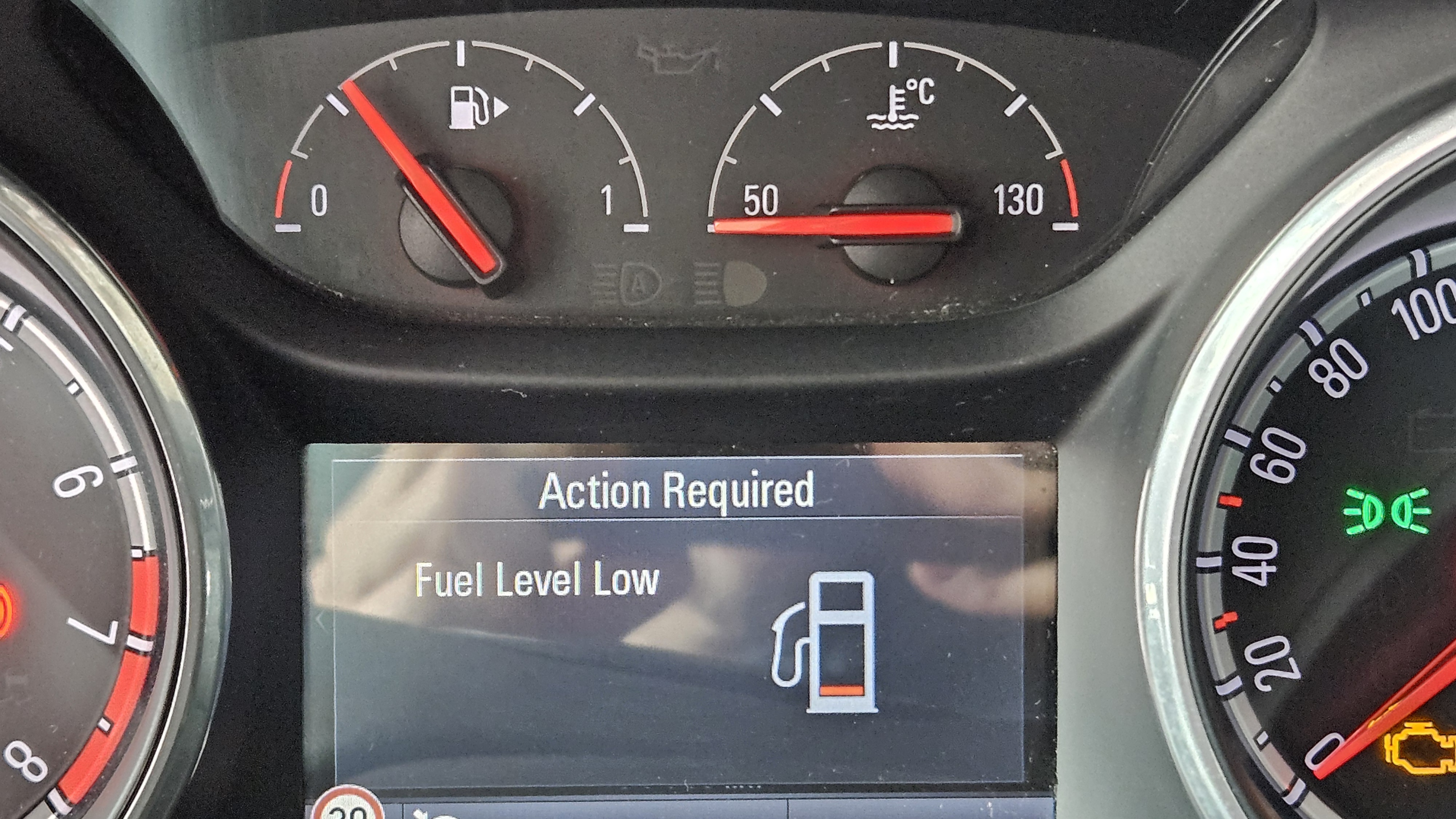

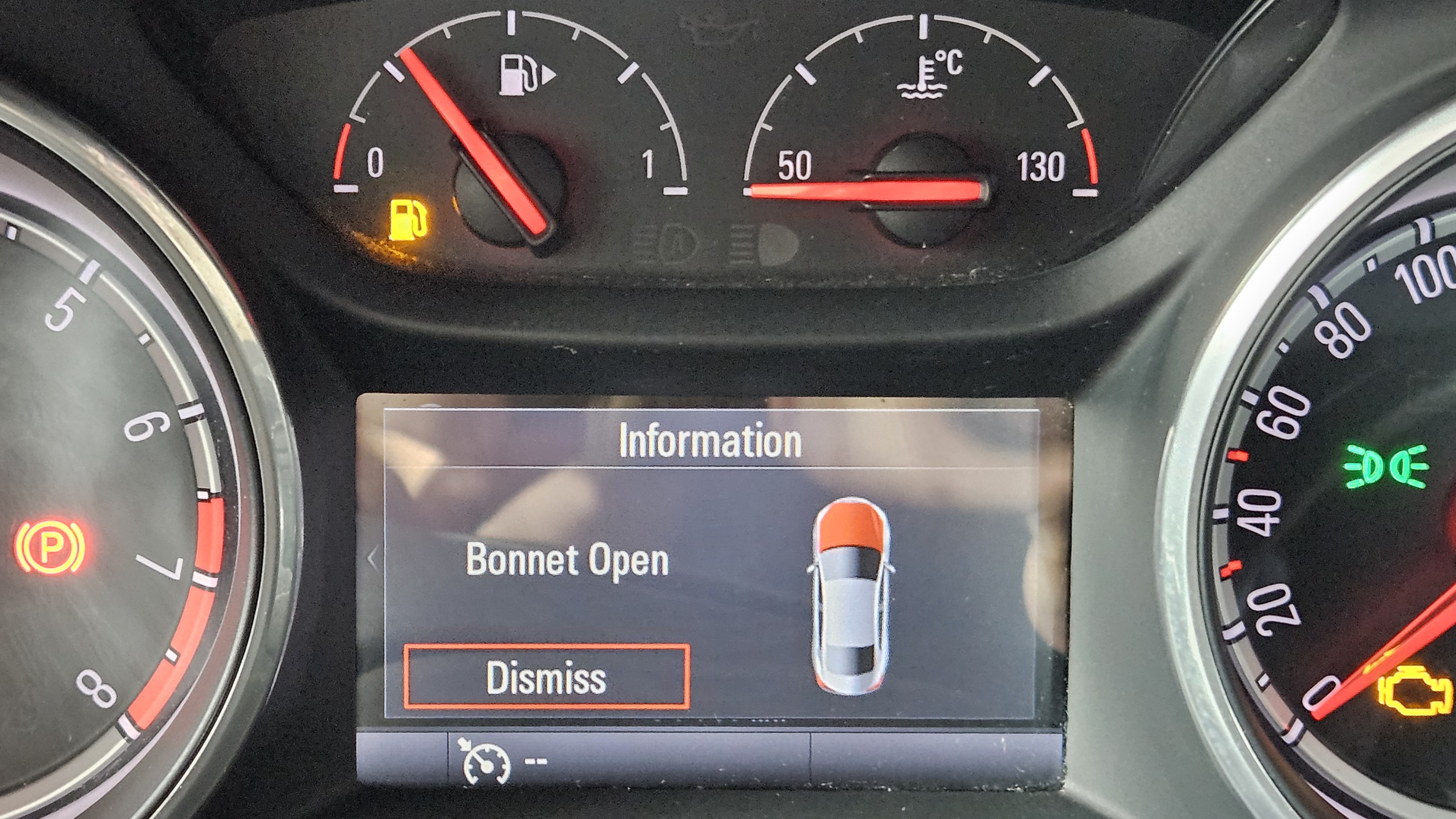

Hello Everyone,
i switch the UHS back to the UDD from my Astra K ( back to Original)
I Conig and Programm everything back to original but the Cluster show that the Car has NO fuel (binkling) in the tank but also show 1/4.
No error code or something.
What can i do or what is the problem

    So, after driven 50km the light go off and shows correct range estimate. Probably the Cluter didn't like to sit long time on a test bench with zero fuel consummation

    And what is the actual fuel level in the tank? 1/4 is correct? Just a theory - if the cluster is freshly installed, it may have some abysmal fuel consumption data (like 50l/100km), so it may have calc

    This happened to me too when i cleared the security code from the cluster. Yes it does function correctly after driving 2-3 km/h
Just a theory - if the cluster is freshly installed, it may have some abysmal fuel consumption data (like 50l/100km), so it may have calculated that existing amount is not enough and fuel will end soon..
Have you tried resetting fuel consumption in GDS2? Or reprogram IPC again with DPS and Conf & Setup after again too (full Type4, not just XML).
