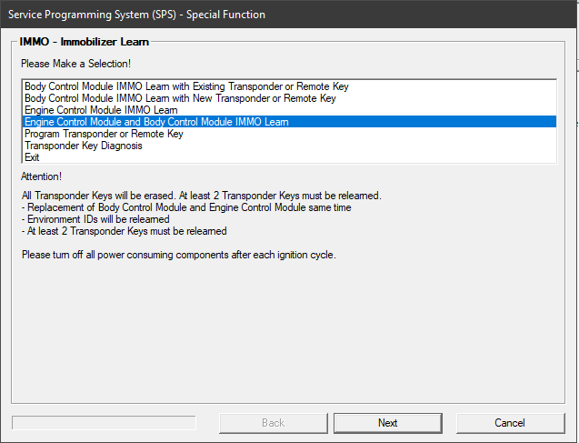

ich have changed the Instrument on my Astra K.
VIN and PIN is changed and the same on the Car.
But i have an Error Code on the Instrument (Cluster)
Number: B3902 Received invalid immobilizer ID
Must i do the "Z1 Immo Relearn" with SPS?
Thanks a lot for help

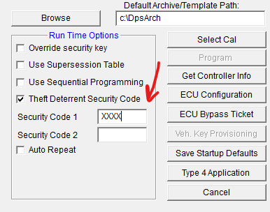

    Yeah, Can be done with DPS too, if you have necessary Type4 files. If I'm not mistaken, need to perform this point:

    If not set pin, Z1 inmo fails, but for example, you can programm bcm calibrations, but fails at 99%

  • And then comes Instrument Panel Cluster (IPC) FE05 Security Code Input incorrect and end to programming
PIN and VIN is correct
Have you entered vehicle's PIN here too before starting the procedure?

No i don`t have put the code inside.
Ok then i must test again. I think i have forgot this
Only at Code 1 the Pin from the Car and nothing on the Code 2 right?
Yes, input only 1st code.
If you have "synced" VIN/PIN in all replacement units, there is no need to enter it again.

@tobiasp if you dont set PIN in the theft deterrent sec code, DPS sends FF FF FF FF as sec code, then it fails in all units
