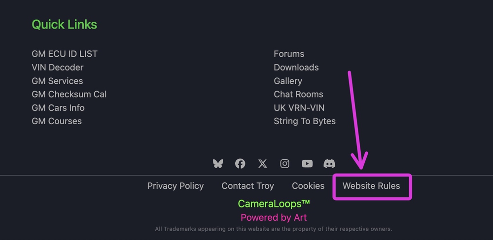

Hi, all posts should be submitted in English. Read the website's Terms and Rules. https://www.cameraloops.ru/terms

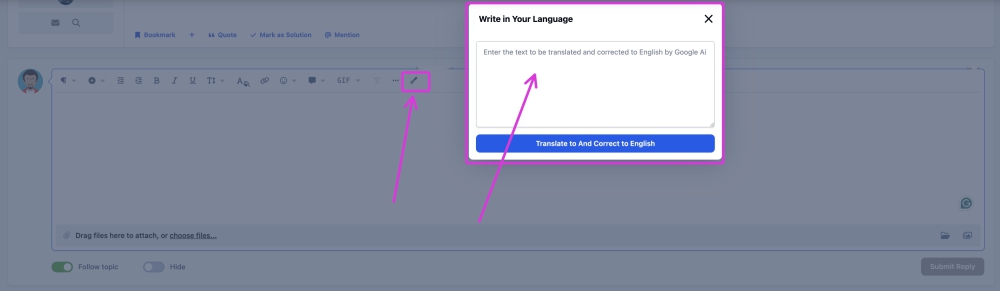

The website has a built-in translation Ai feature that converts all written content into English. You can use it to translate your language into English.
