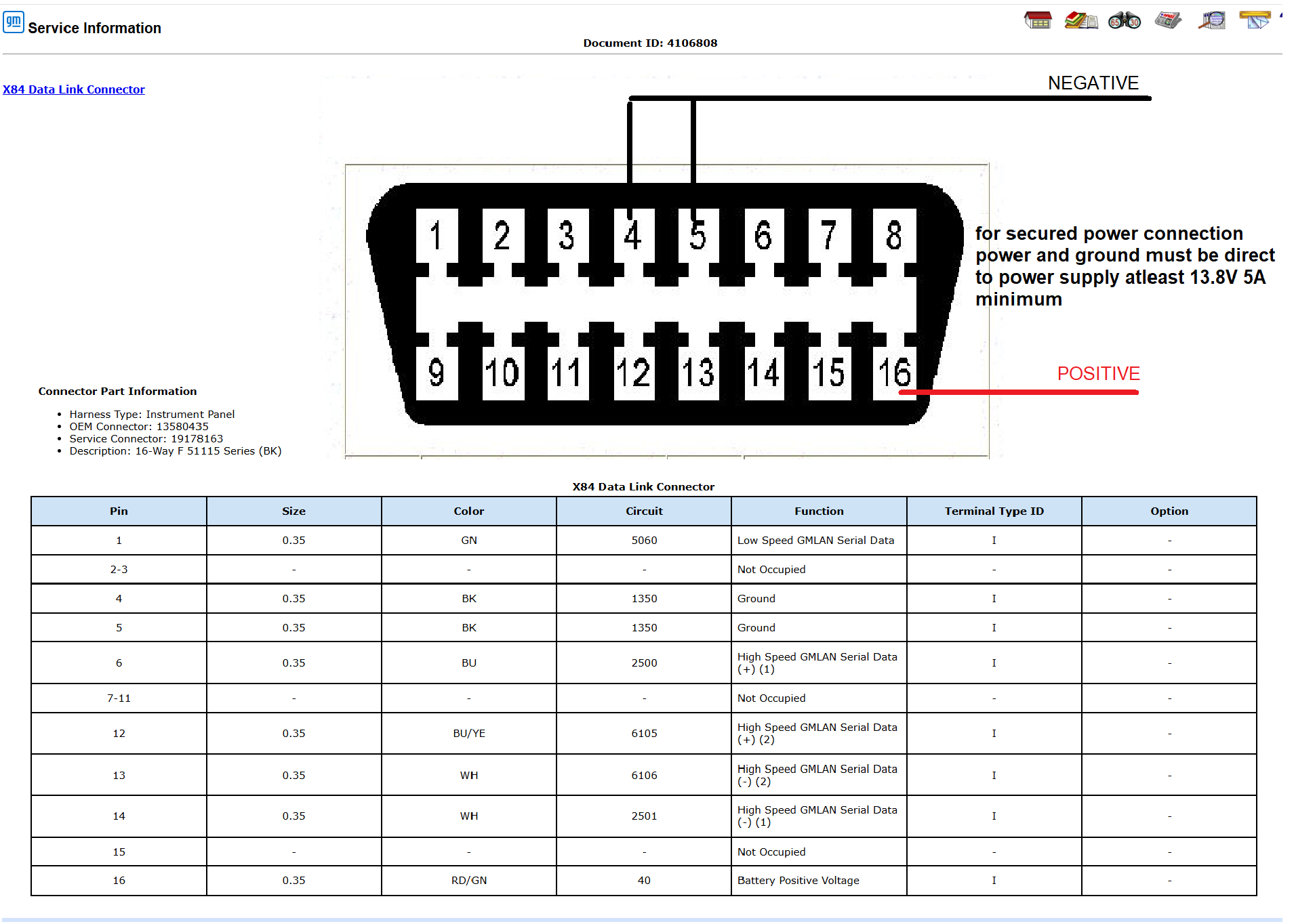

if mdi2 was ok on vehicle,, the problem exactly is on your bench harness,, (power and grounds) terminator resistor is 120 ohms not 120K ohms
You are right I was typing quick and brain not functioning at 6am local time for me when typing that 120R not 120K
All good he does not need one anyway to get power to the MDI2 all you need is power and 2 grounds nothing more to power up the MDI or MDI2 or any J2534 device on the OBD2 port.
The communication lines can be set up after.

    Its sign of no power detected from obd2 to MDI2 YOU have one of the following reason No power on obd2 port Pin 4, 5, or 16 broken in your cable, obd2 side Cable faulty, could be internally wire brok

    follow schematic diagram on what module you want to connect on bench,, if by high and low speed gmlan,, you need terminating resistor paralleled to pin 6 and 14 of obd
That is what I told him in a previous message he said he had 12.9v but if power supply failing it might have the volts but not the amps to fire up the MDI2 and a ECU
I run 13.2v at 10amp and never have an issue with any ECU's or other modules even multiple

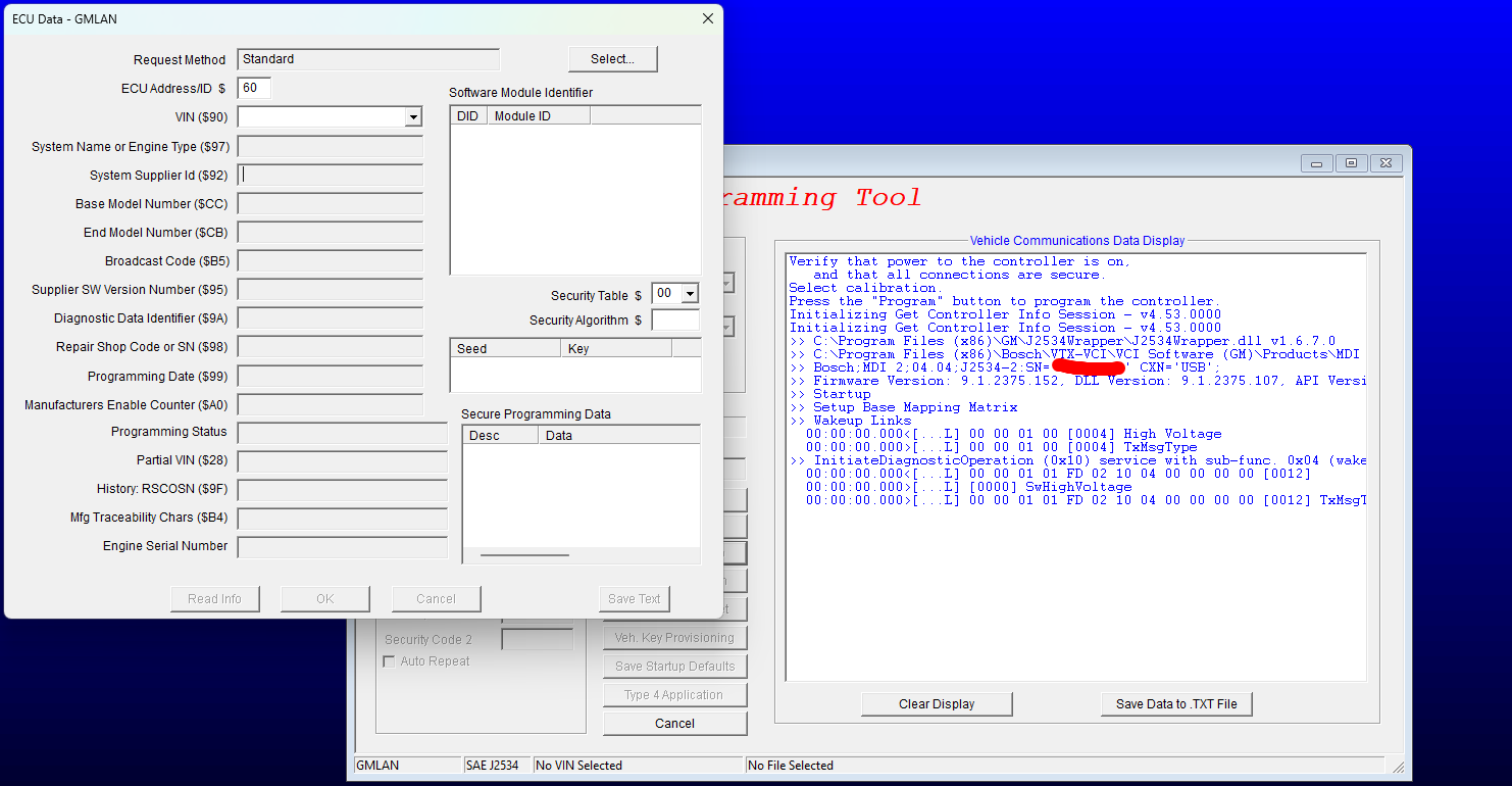

Update: Found the problem. It was my twin obd cable.
I had another one and all good. Now, this is my problem:

Did you select pin 1 as you are trying to read module 60 which is on the GM Lan bus which is pin 1 not 6 & 14 which are CAN
You moved the screen so cannot see your settings
8 minutes ago, uglyoldbastard said:
Turned out to be a broken cable
Yes, of course.
It works with any other J2534.
It seems to be a driver issue.

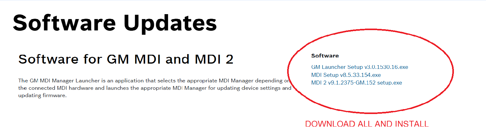

https://www.boschdiagnostics.com/software-updates/software-gm-mdi-and-mdi-2

The MDI SETUP v8.5 and MDI2 v9.1 don't seem to mix up well. The MDI2 was not connecting. I had to delete the MDI SETUP V8.5.
Check if this applies to your case.
