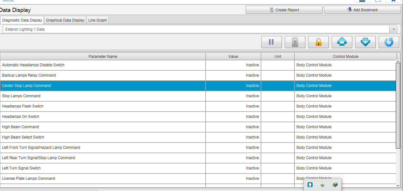

Dose the Headlight get commended from the BCM? / What happened if you try to commend ot with GDS
Hi thank you for comment ... yes its worked fine when i turned it on and off with headlamp switch or gds2 but the problem is when we start the car the low headlights turned on automatically even in day time we have to switch the headlamps controls from automatic to manual then its turned off
Dose the problem stay if you disconnect the headlight switch.
What dose the Switch state say?switch.PNG.a8c65137232f8ea05a963d575cdc41ee.PNG
i will post data display picture of headlamp control switch once i am near to the car ... thank you

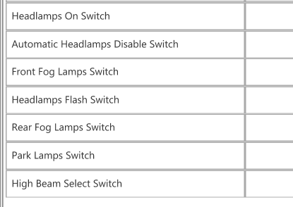

hi here is data display of switch status
Data Display EX1.pdf Data Display Ex2.pdf
anyone can help? no solution?
I found i really funny surprising  that the day/night(just not headlight) switch works, the manuell switch works and gds commands work.
On my testbench a had the problem that the headlight ware on all the time (with icon in the dash) and the not existing light sensor has said Invalid. But you show correct Day Night and the light icon go away in day.
At first i thought that maybe the relais or cabel is the problem but like i sad on off is not the problem just "auto" if i got i right.

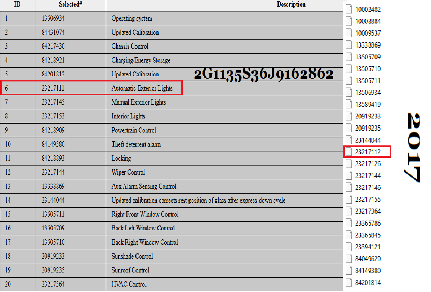

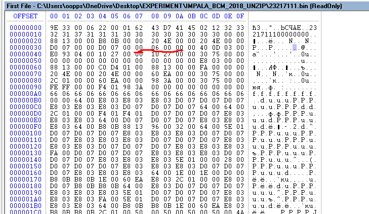

change bcm calibration,, swap AUTO lighting calibration from lower year
Thanks for your reply LLCasaol my techline connect not working looking for calibration files for VIN's if you can arrange the files it will be nice
