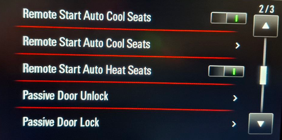

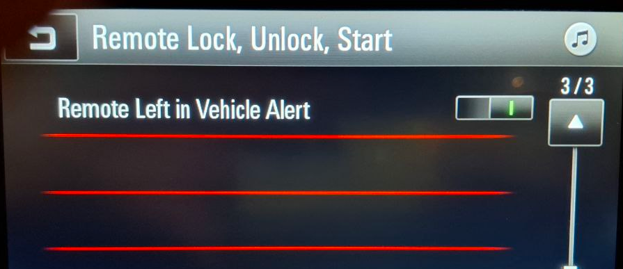

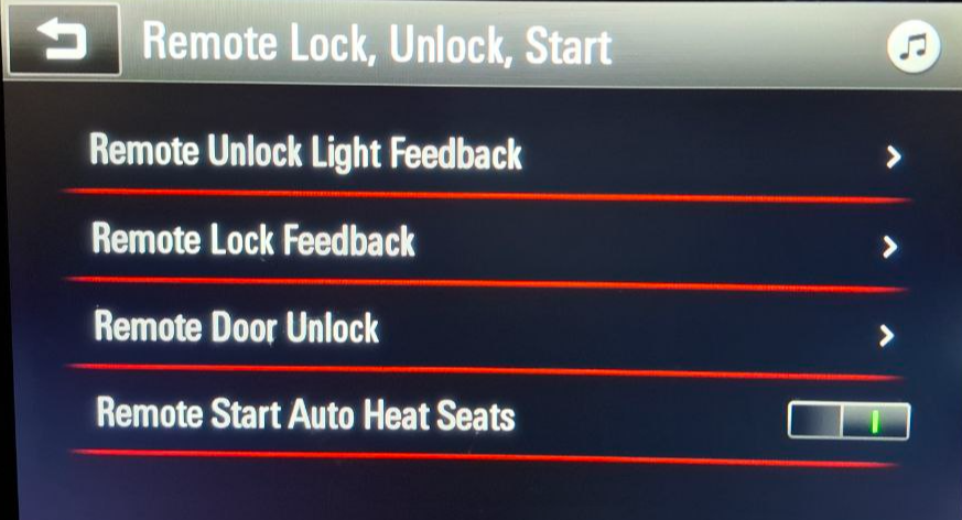

I learned how to activate menu items such as:
1. Heated seats during auto start
2. Cooling of seats during autostart
3. Lost key control
4. Remote start
Menu items are in calibration No. 2

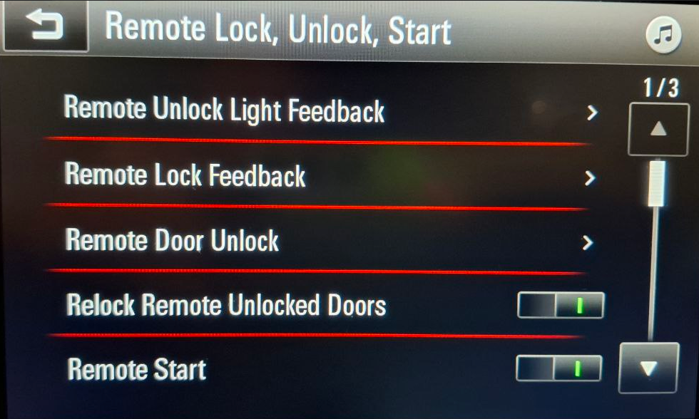

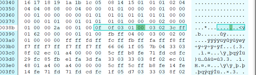

This is the display part so it doesn't matter for remote start. I compared your file with mine and found which BIT to modify and enable it. maybe I will review it and send it back to you later. if you press start on the key, the turn signal flashes twice but the engine only makes a relay click, then you need to change it on the ECM file. Same with my car if only BCM is changed. I changed ECM too for remote start to work

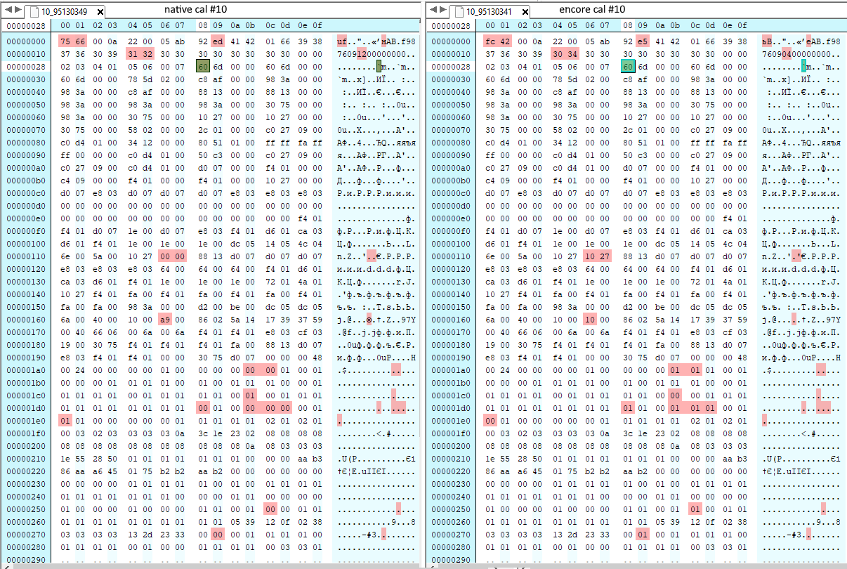

The problem is in calibration No. 10, because of it it cannot be flashed. @Rain

yes i have added 1 paragraph to file number 10 and maybe it can not flash
I couldn't flash with your file #10.

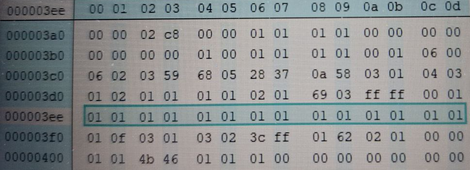

On your file number 5 I can't find the bit to turn on BTV.
This piece of code

File number 10 is used to fix the problem of the hood latch and remote
This piece of code
what needs to be changed in source file #10?
