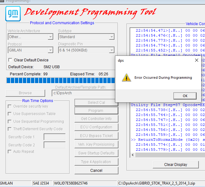

I collected the archive as in the picture above GIBRIG.
All calibrations are original except 2 and 5. There was an error with the firmware.

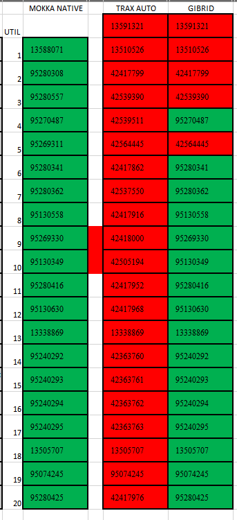

I made an archive of native calibrations and Buick Encore.
I managed to flash my BCM at home, now I need to try to do it in the car.
Replaced: cal 2, 3, 5.

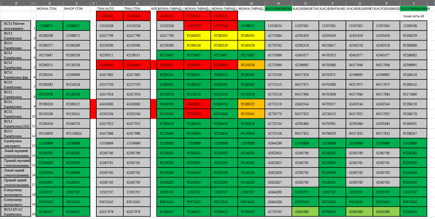

Calibrations BCM #5 that didn't give results
95286098
95130536
95130509
95286085
95286114
42596991
94517946
94785860
42733094
I found over 50 VIN numbers for Buick Enroce that came with BTV from the factory.
I checked all these numbers manually and wrote down the calibration numbers.
I made myself 12 different DPS archives, all of them successfully loaded into my car, but I still did not have a remote start menu in my radio.
The radio just now has a menu for turning on heated seats with remote start, but there is no remote start itself.
What am I doing wrong?

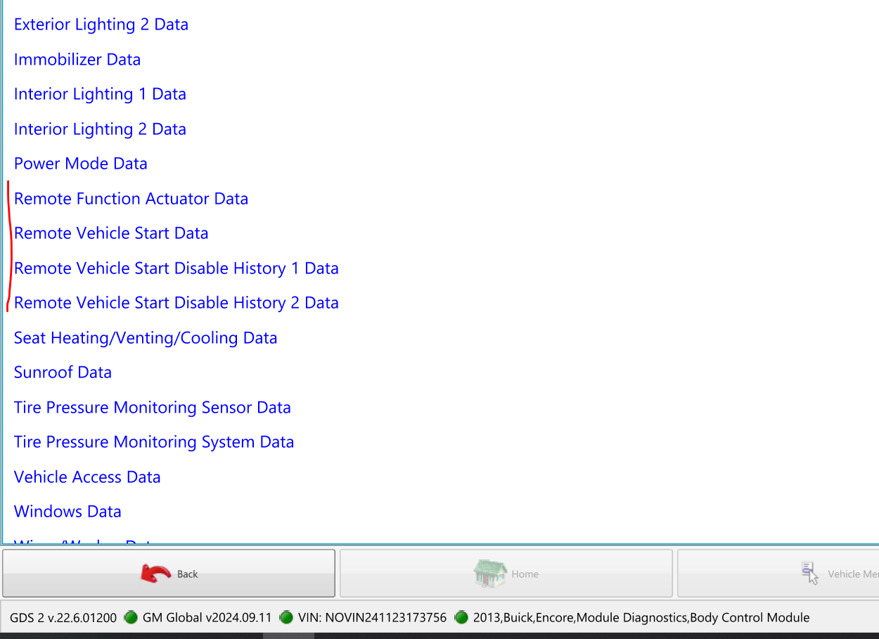

In gds2 you can try to set the car to Buick Enroce and go to K9 and there should a info about remote start and remote start cancel.

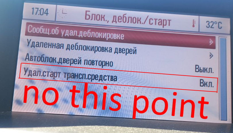

On 05.11.2024 at 08:13, T_Ivan said:
My Buick Encore with BVT does not have this point!
You should call it:
Remote Start Auto Heat Seats
