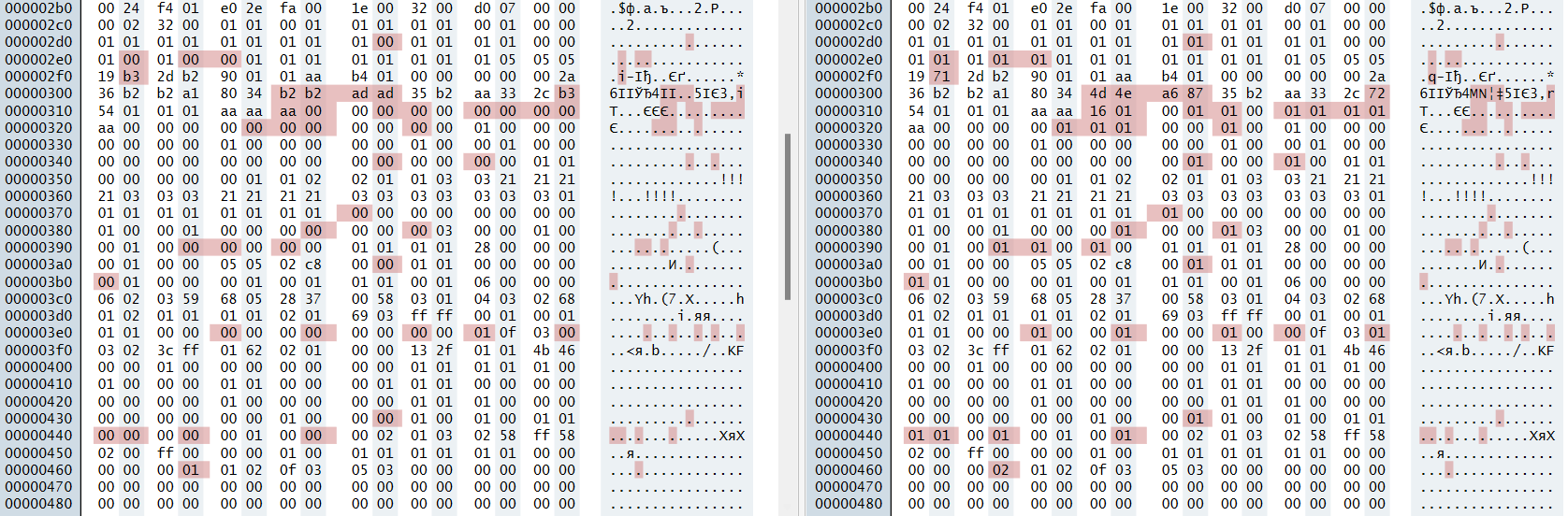

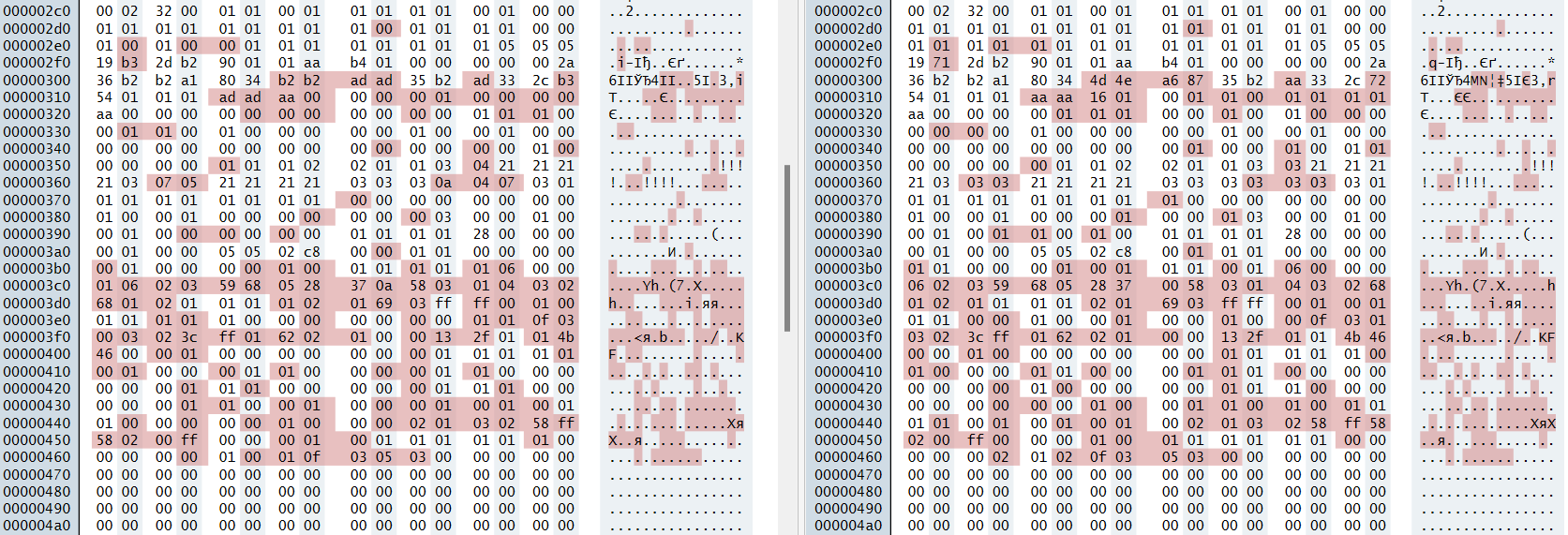

I found the dependence of the BTV option in calibration #2 of the BCM block.
I looked at calibrations from a Buick Regal 2012, I noticed that some calibration options start from 0x2be to 0x305, and from 0x306 to 0x4e7 is the code responsible for remote start. In Insignia there is some offset in the range 0x306 to 0x4e7. I tried to analyze and compare the necessary bits, but when flashing the unit I get an error at 99%, I also tried to completely copy the range from 0x306 to 0x4e7, when updating the unit I also get an error at 99%, trying to copy from 0x2be to 0x4e7 without offsets in bytes, I also get an error at 99%. In all operations, the calibration checksum was calculated.
Buick Regal 2012, On the left without BTV, and on the right with BTV:
left Insignia without BTV, right Buick with BTV:
