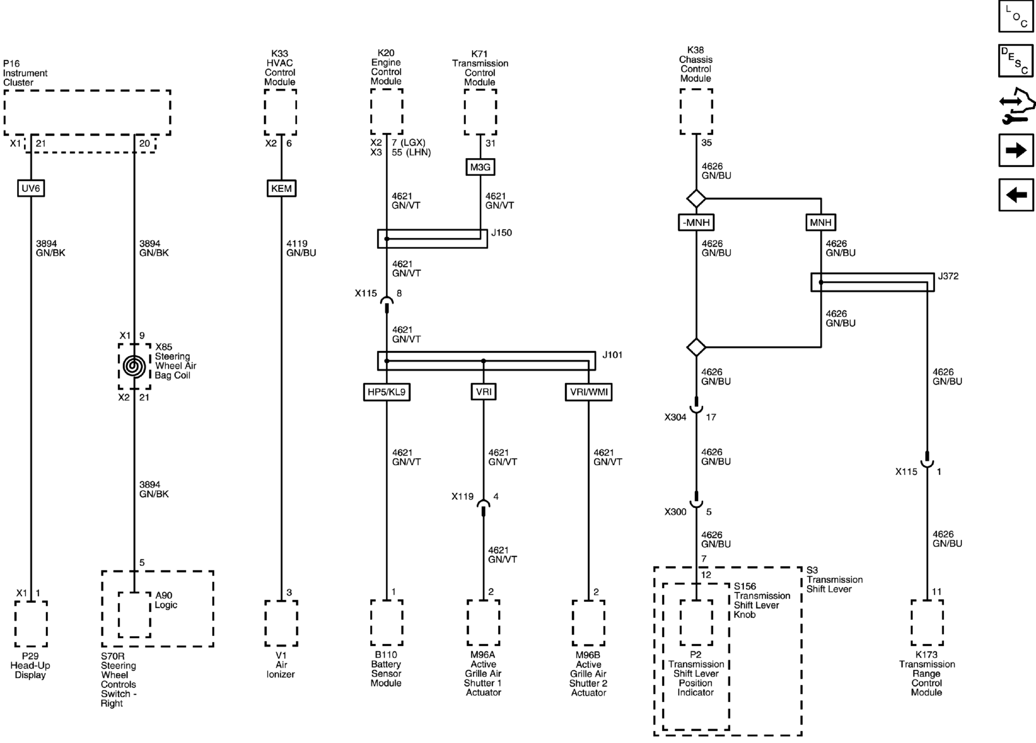

uhs uses LIN controls P16 20 to S70r
https://lemon-manuals.org.ua/images25/GM4626486/
Thanks you, because i see video then may be control by old button in signal (my car is 2011 then button on right is media control)
https://www.facebook.com/watch/?v=740257625148384
this uses a stalk2lin adapter to work
