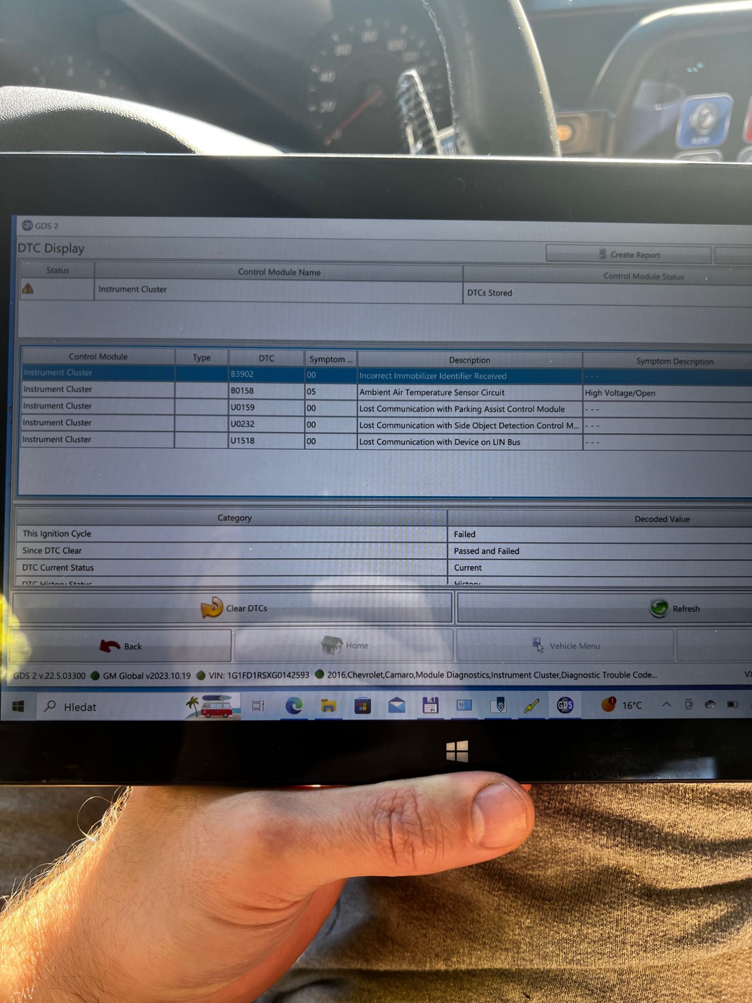

Hello, I have DTC error B0158 on instrument cluster. Symptom:05 Description: Ambient Air Temperature Sensor Circuit.

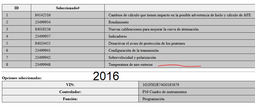

  • Im 99% sure your problem is calibrations of "new" speedometer. Calibration number 8 is refered to the exterior air temperature.       Have you the source VIN of the 201

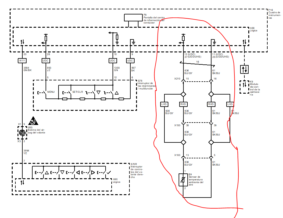

The first thing you need to check is the wiring diagram of your original speedometer and check if the temperature sensor goes to the instrument panel. And then check the speedometer diagram that you have installed. It may be simply changing 2 pins of the speedometer connector, or you may have to change calibrations of the installed speedometer.
I found that system voltage should be between 9-16 volts. I meassured nearly 5V.
Also B0158 05 is: The instrument cluster detects the sensor signal is less than -40°C (-40°F).

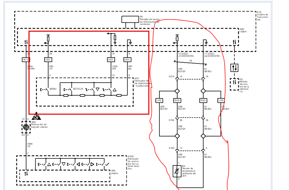

I found wiring diagram where is shown connection of ambient air sensor directly into speedometer.
Now it look like there is bad connection in speedometer connector. Because sometimes the right temperature flashes and disappears.
Definitively I have to check connector on speedometer.

I dont have access to the CAMARO SI (service information) maybe someone can share the schematics.

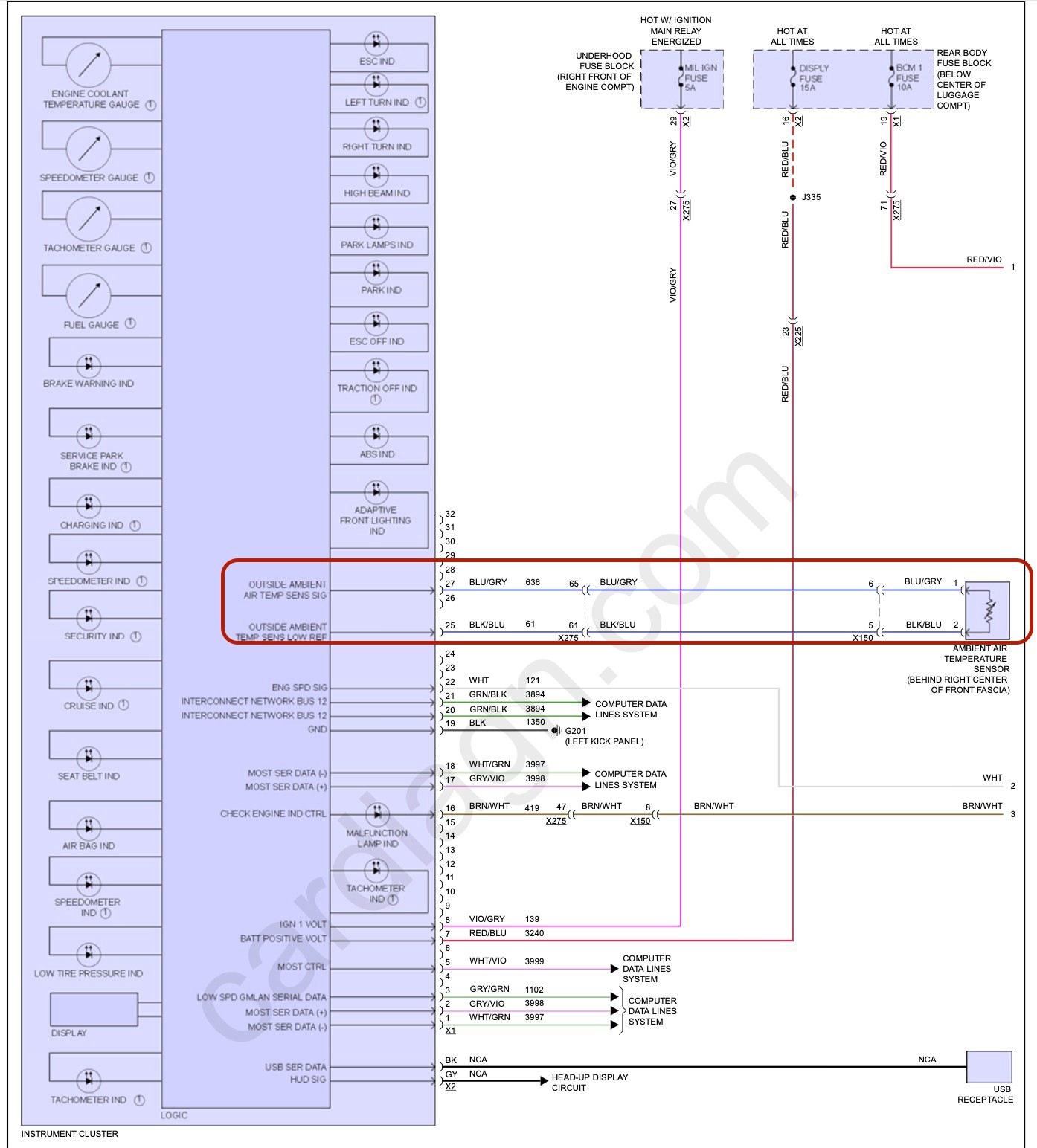

In insignia A the sensor goes to the pins 27 and 25 (udd and uhs). check in your connector if you have this wires
Thank you @Arbe_gtc it seems the same 🙂 I found 25 and 27 on Camaro

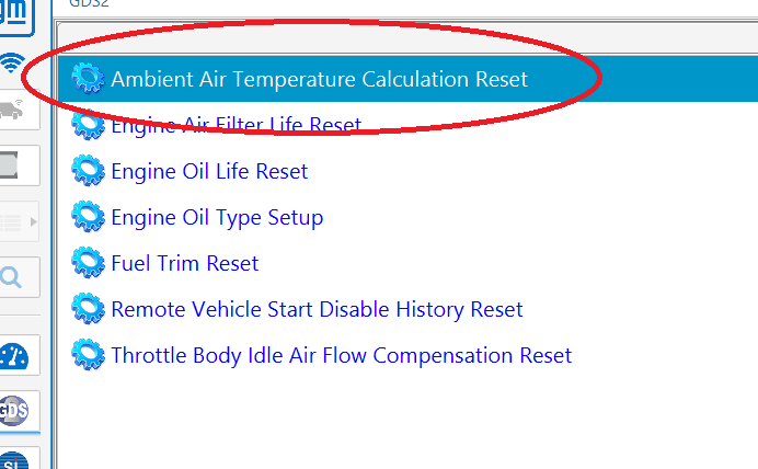

I had this problem with an ATS.  I changed from a 2015 cluster to the 2016 version.  It seemed the air sensor wiring changed for the base model, but the ATS-V still has the air sensor wired to the IPC.  I changed the calibration in the IPC and now I get a temp reading, but it isn't correct lol.  I need to mess with it more.

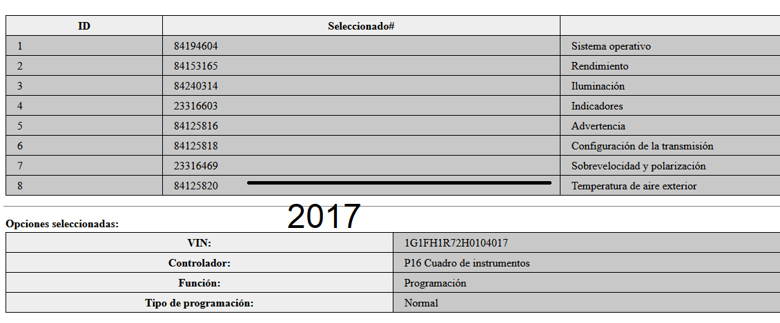

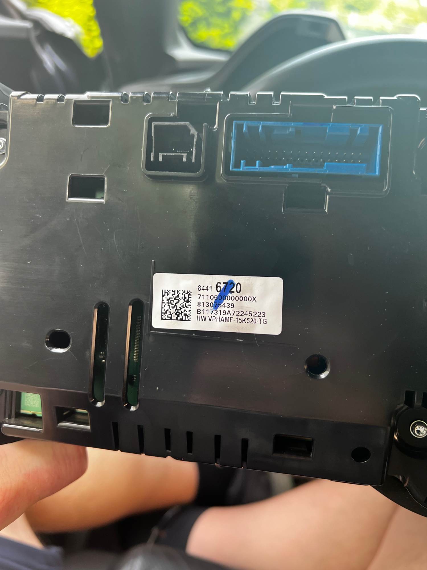

Have you the source VIN of the 2017 speedometer? share too the part number of the speedometer
You're going to have to "play" with changing the calibrations, until you find the one that works. And configure the speedometer with your vehicle's options, if you didn't do that.
@Arbe_gtc
The VIN of the 2017 speedometer was 1G1FJ1R64J0141197 Is the part number one of the numbers in the attached photo?

And if it is possible to switch off  warnings from modules which I don't have and IPC display warning for them: Parking Assist, Side Detection, Pedestrian protection, Rear axle
