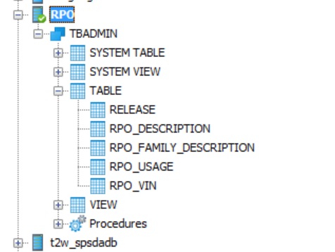

2. Let's create new connectin to database.. with RPO data, for example:
 Use 'Database -> Create Database Connection`, attached a picture with an example of settings below.
P.S.: Almost forgot to share credentials with you to access the database 🙂
login: tbadmin
password: dgs
All database list you can find here: C:\Program Files\GlobalTIS\transbase\dblist.ini

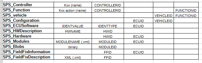

Okay i think i have found the calb .Bin files. Are the XML files also stored there ? I know everybody inverstet time in this. But I thought I didn't have to reinvent the wheel when there are so many clever people here
Everything relevant is there - .BIN files, XMLs and DLL for Type4 apps too.
It's the same thing you get from payed online access to SPS, just for free and heavily outdated..
As I've said before - explore and document your findings, and then things will start to make sense.
Here is an example of what I did first.
Export data to Excel and filter things out.
