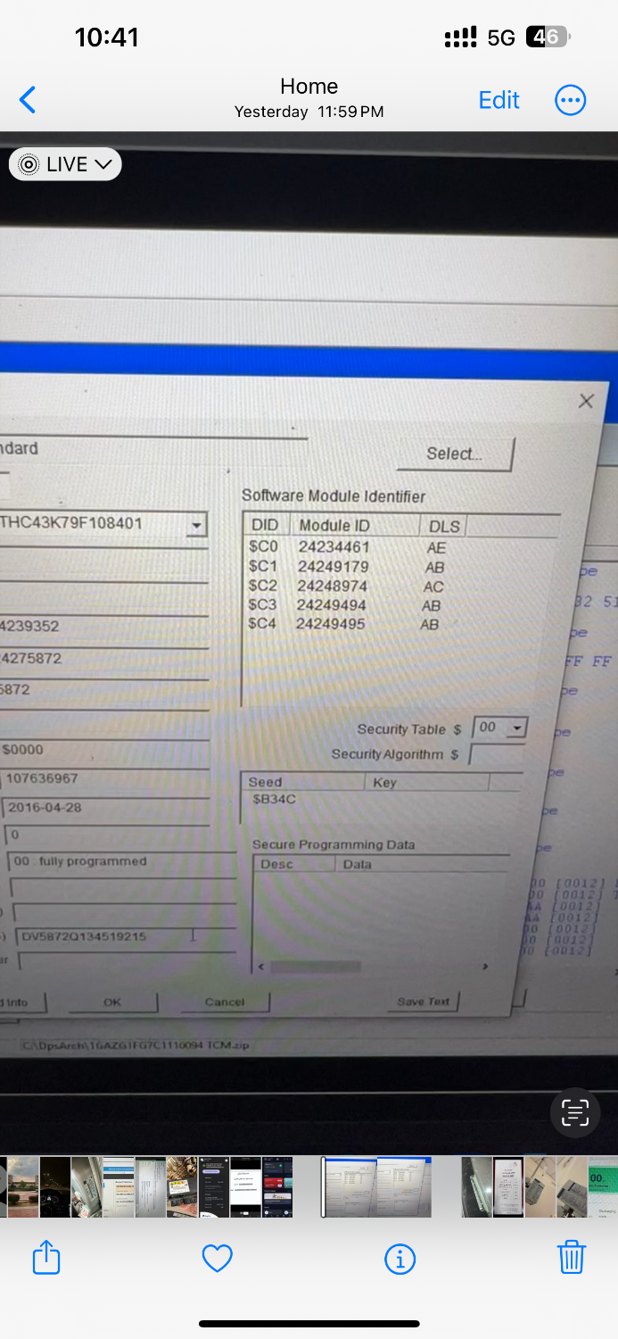

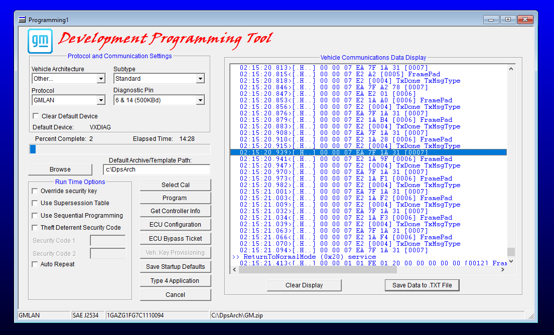

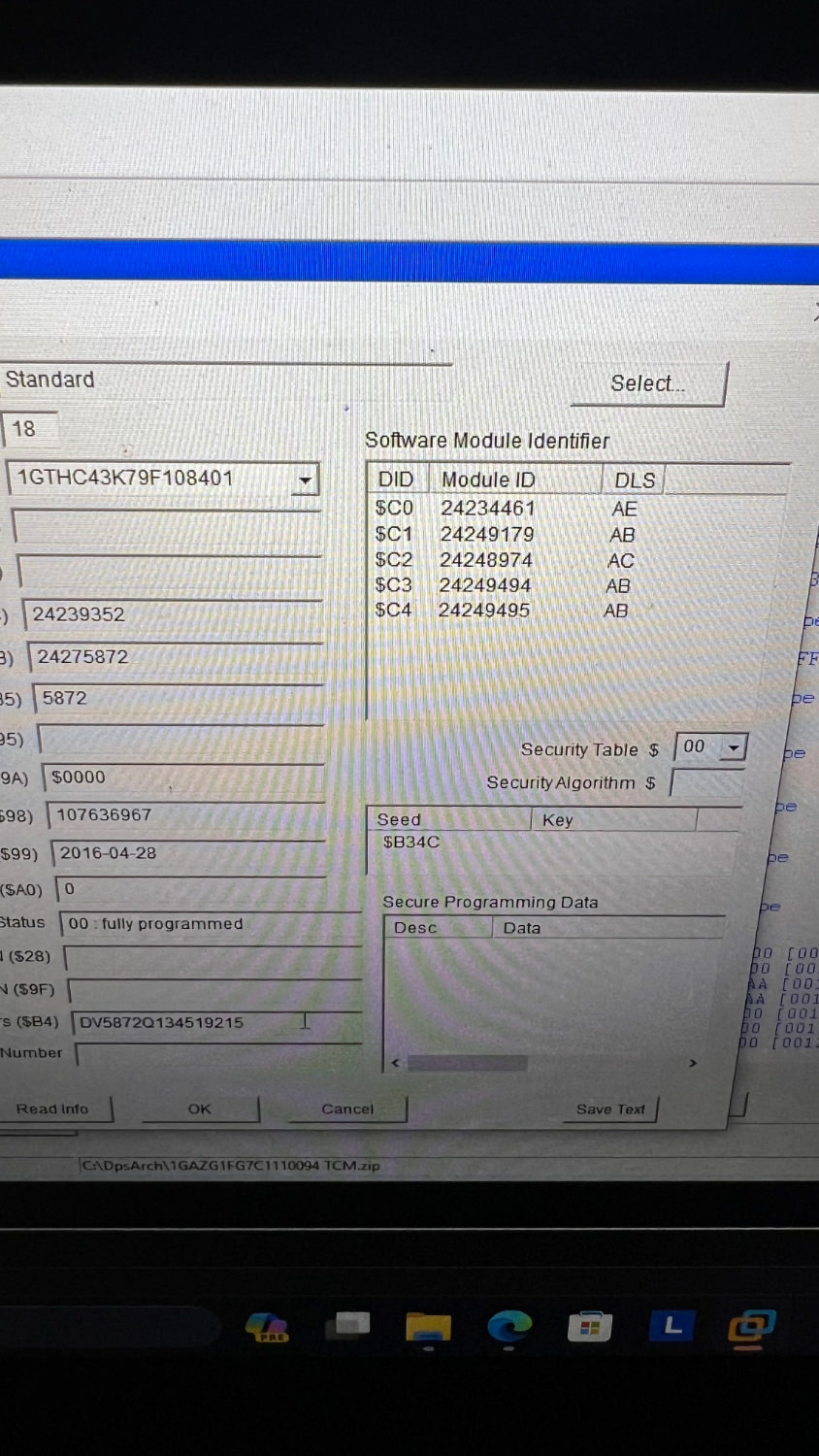

Hey Guys,
I've been working on programming a used TCM for a 2011 Chevrolet Express with VIN Number 1GAZG1FG7C1110094. The TCM was initially working fine, and I downloaded the calibration files from SPS, creating an archive manually. However, trouble struck during the programming via DPS. It threw an error, and now the TCM seems to be dead. I've been attempting to reprogram it through SPS, but each attempt fails. Additionally, the scan tool isn't showing any communication with the TCM. Any guidance would be highly appreciated. Thanks!

it shows unrecognized calibration and when i start programming it, it retries 3 times and fails and gives me an error message
  • E4491/E4423 – Programming Failed.

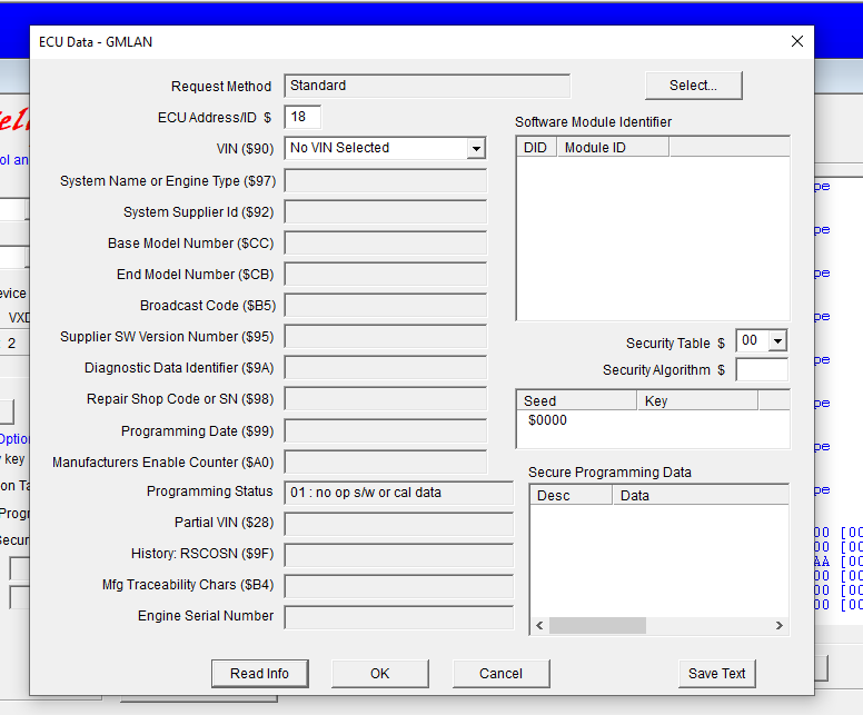

I don't believe the TCM is bricked as it appears to be still communicating, just missing the calibration files. Is it possible for you to attempt a diagnostic with a different interface? I have encountered similar issues before, where failed programming resulted in the module only being recoverable using a genuine GM MDI2 interface with GM SPS service.

The TCM is still alive otherwise it wouldn't respond to the broadcast request or even allow you back through security access.  I'm not there to see it myself but it's attempting to load up the first calibration and immediately returning an error code that is stating it cannot process the request.  It's basically telling you it's busy....  but I'll admit, I'm not sure why.  I've never seen this behaviour.  It could also be due to the load being too large for the EEPROM (i.e. using a different VIN - the used TCM might be slightly different).  Do you have the original VIN?  Wouldn't mind to take a look.  I also would bet that if you used the original VIN, it would come back to life but with the wrong calibrations that you need lol.
another module "sof bricked" due not understanding DPS packages construction. Is issue with calibrations position. Position is stated in VIT2. Some modules required to be manually configured as DPS, don't have VIT2 info. To be recovered now need all data to be prepared and loaded. If SPS has to be used, will need VCI to skip SW check

Unfortunately no i dont have and i tried to program the archive that was provided unfortunately the TCM is now bricked and cant even get controller info it says and error occurred and doesnt program at all. Sps is also giving an error retrieving the controller data
I could do it before but now it says an error occurred 😭😂. I think its dead now completely might need some other tool like io terminal to write complete files
