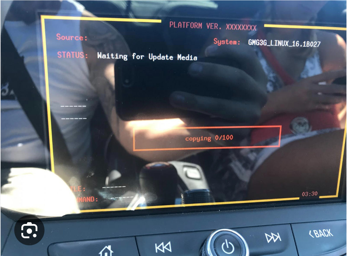

anybody know how to fix the media update for 2017 camaro v6

The absolute easiest is if you have an MDI (or clone), pay for a VIN license on SPS, then download the USB update.  You're going to need calibrations after anyways because after you do a USB update, it'll say "Calibrate device".

And what they (@codebuilder) say about trying to install EU-US software, it is true. When checking the files, the update is invalid for the HMI

I’ll add too, even after you load the USB, assuming your flash memory didn’t go bad, you’re going to very likely get stuck at “Calibrate Device” and need an MDI or clone.
